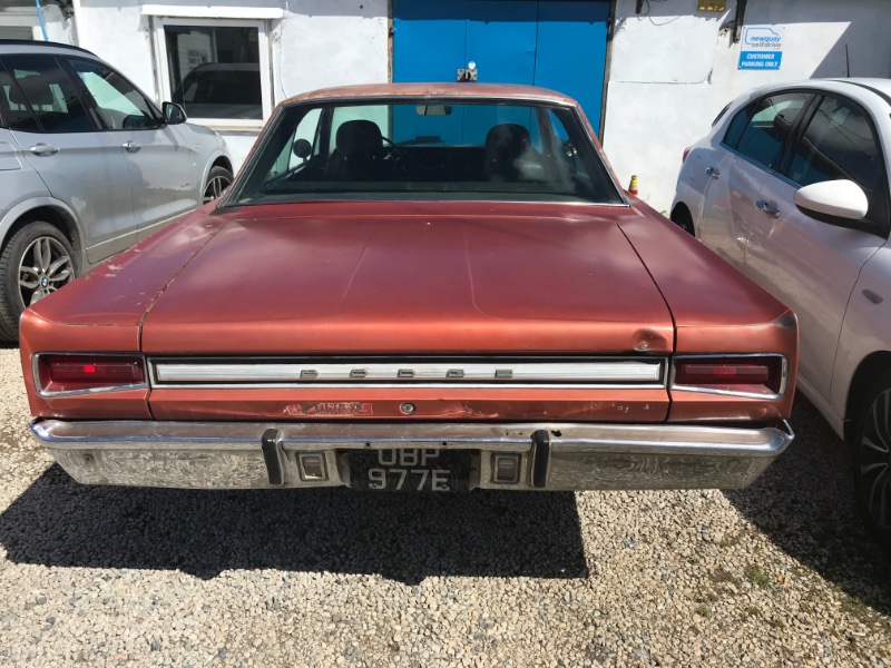

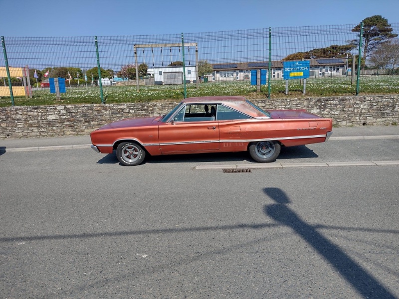

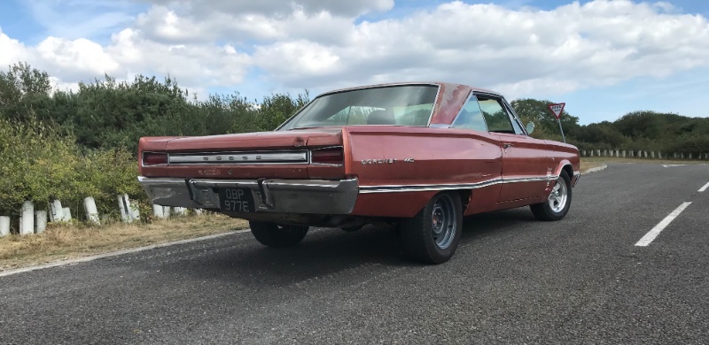

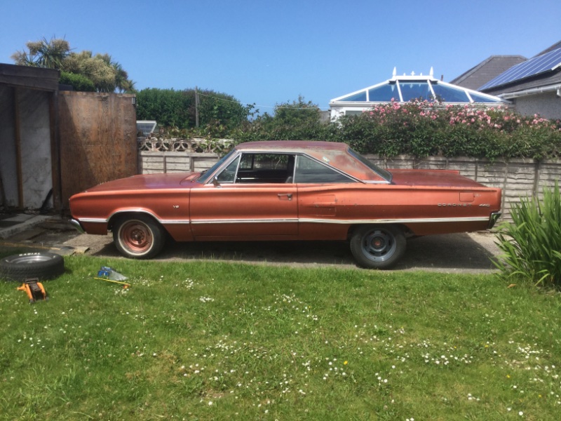

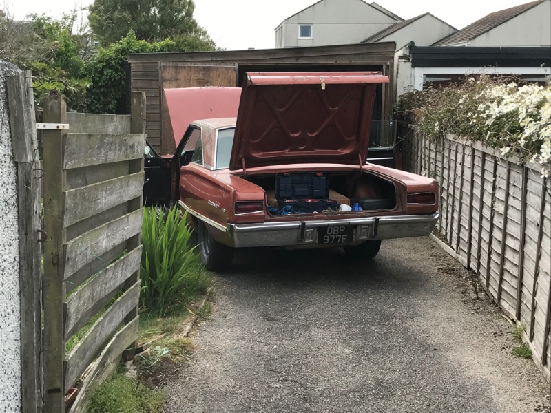

Been doing loads of stuff on mine, probably the most trying, but satisfying and eventually easy to do, was adding and subtracting leaves to the rear springs. I initially fitted a very heavy duty pair of Add a leaf/s to the spring set and reduced one stock leaf. That left the car way too high at the back an as Blue and Dunc observed, probably compromised my rear shox. Test diving proved that right and so I stripped it down and added a much lighter (but strong) leaf and now the suspension sits how I like it. The 3 pics should show it as too tall, as it is now and as it was before I changed the leaves around.
Next up is the front sway bar kit which this car desperately needs. Sort of unsafe at any (cornering) speed

Nice how the pic of the highest spring setting has the car upside down, as that’s where it was headed in the first fast corner!
