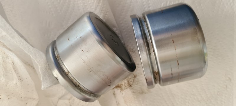

- Old pistons (removed)
- 2022-08-20 10.03.30.jpg (123.24 KiB) Viewed 137706 times

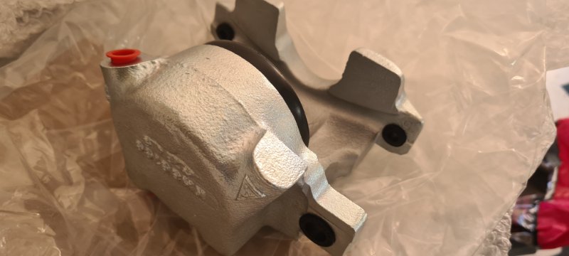

- Reconditioned caliper
- 2022-08-20 09.59.34.jpg (95.83 KiB) Viewed 137706 times

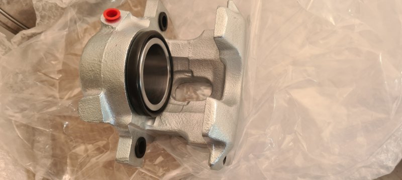

- 2022-08-20 09.59.20.jpg (129.25 KiB) Viewed 137706 times

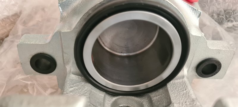

- 2022-08-20 09.59.13.jpg (131.06 KiB) Viewed 137706 times
