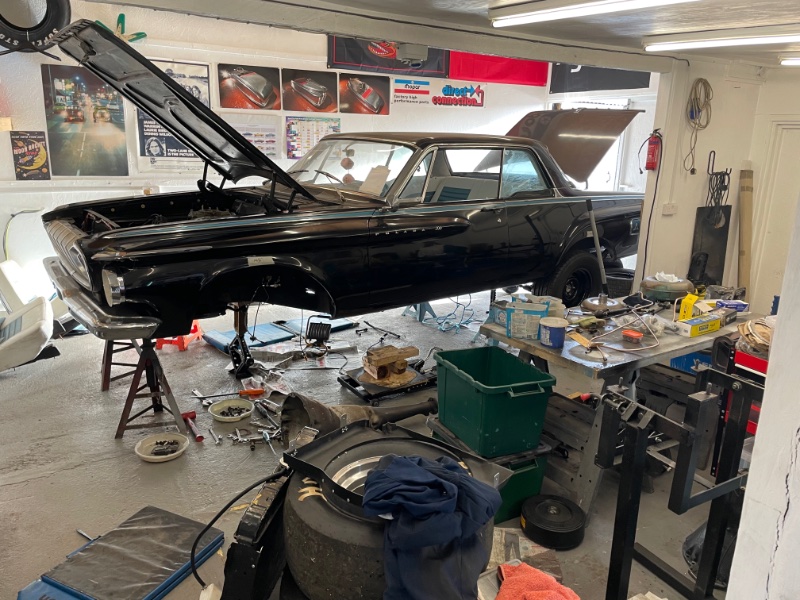

Posts: 14582
Re: 727 rebuilding jig/ holding stand ?
The one I made supports the trans from the same points. It rotates on the legs so I can have it upright for assembly. You can see it in the foreground.

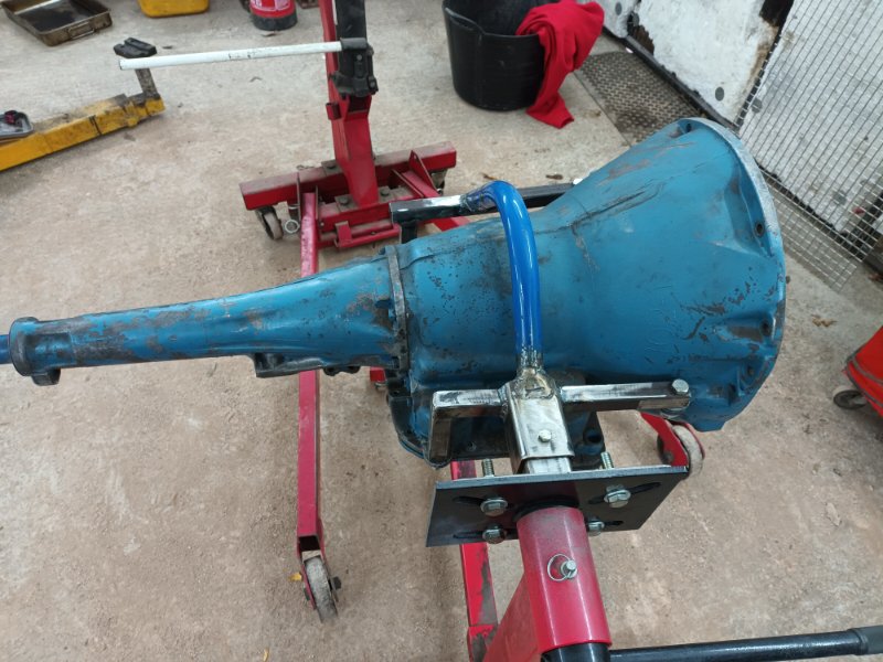

Johnny Dart
Posts: 917
Joined: Tue Dec 24, 13 12:46 pm
Post by Johnny Dart »
I've made this , so it will bolt up to my engine stand, and then , as you say I can spin it over or on its ends.
I think it will make rebuilding it a lot easier.
More pics when its on the stand.
Job jobbed :)
Posts: 14582
Cool, that works!
