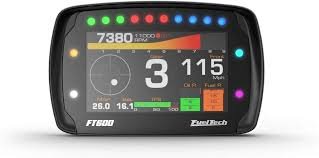

Summit fortunately have ally blocks in stock . One has been ordered and should get here this week. Everything else is more or less available. John will build the engine and tune it with a FuelTech ecu, which will include all sorts of data logging possibilities generally for the car - G forces, suspension travel, etc.

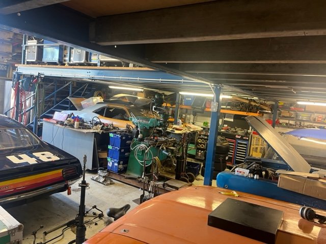

The car has been buried in the corner of the workshop for about a year. I got a few days off work last week, tidied the workshop, dragged the car out of its corner, and bolted on the wings and bonnet for a bit of inspiration. I'll order the steel for the rollcage next week.
