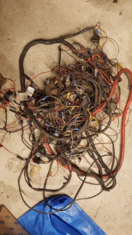

Time to replace my wiring so my investment doesn't go up in flames on first start! [-o<
My plan is to get a mopar wiring loom / harness kit. I have an auto electrician who can fit it for me.
I'm seeking advise on how many circuits to get and which kit to buy.
Circuits - I have the original (in a mess but makes a rough template for lengths) but I don't know if it had sufficient number in the first place.

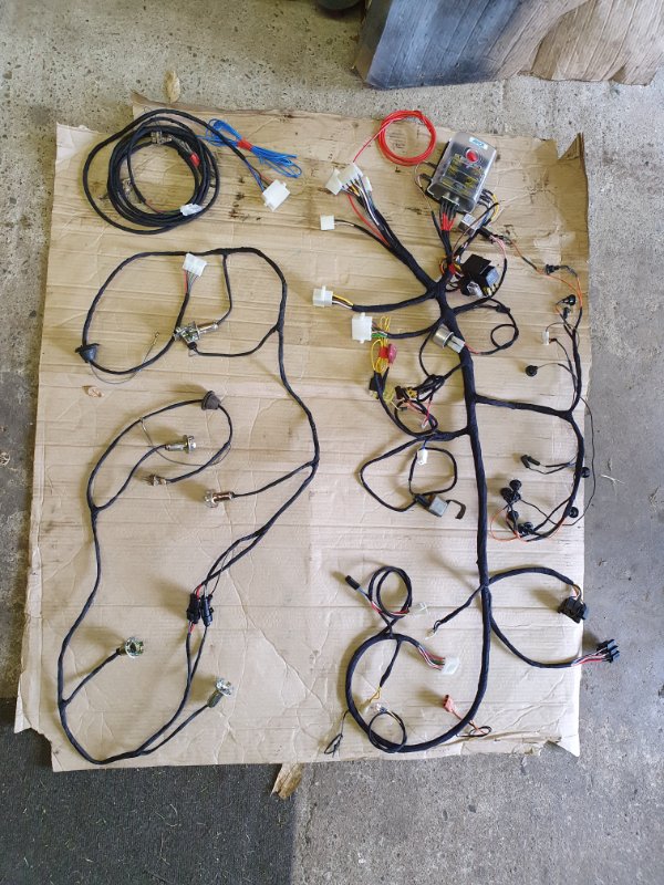

I made my own using a factory wiring diagram but also factored in the UK indicators etc. Used "vehicle wiring products" up in Derbyshire for most of it, Rockauto for the lamp holders and ebay for odd bits when vwp didn't have what I wanted.
Posts: 7529
Re: Wiring loom / harness
Well done, it looks a lot neater than the old one. Should have no risk of a fire now. =D>

to be honest i'd be putting the orginal back and replacing what is broken. The dash wiper and lights wireing is pretty complicated
Unless there has been a catestrophic short there is rarely a problem with the middle 95% of the wire. i had great chunks of my loom unwrapped at one point and all of it apart from the 1 section that casued the issue (someone elses bodge) looked as though it was installed yesturday only the exposed ends of wires looked horrible.
i.e you usually need the last 2-6 inches replaced and a new connector, or the thing that it connects to is knackered.
Issues with older wireing are invariably caused by expecting it to carry way more current than it was designed for and that comes about when you fit a massive alternator and a load of new current hungry kit to the car. if you avoid that you avoid the risk.
provided all connectors are tight and clean or new the old wires will do a decent job.
