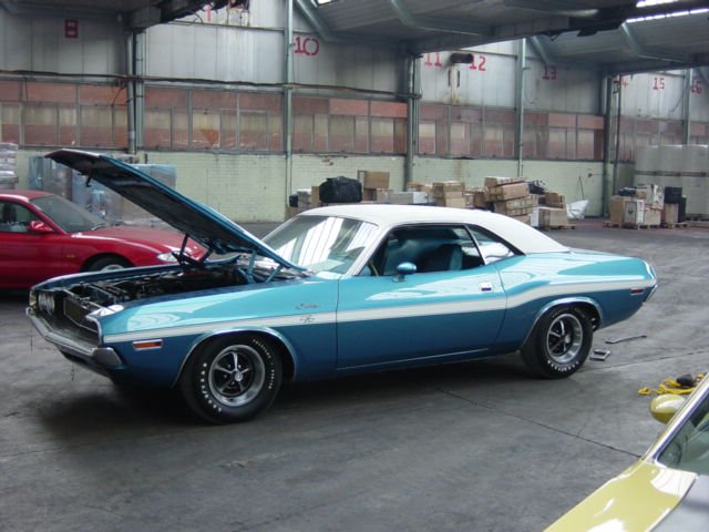

Here is the front of mine pre Re-Paint...
Posts: 7209
Re: 1970 Challenger grill
It’s a bit hard to tell from there. :lol:

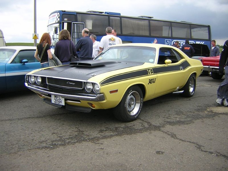

,, and to back that up, here is a Picture of my old T/A....

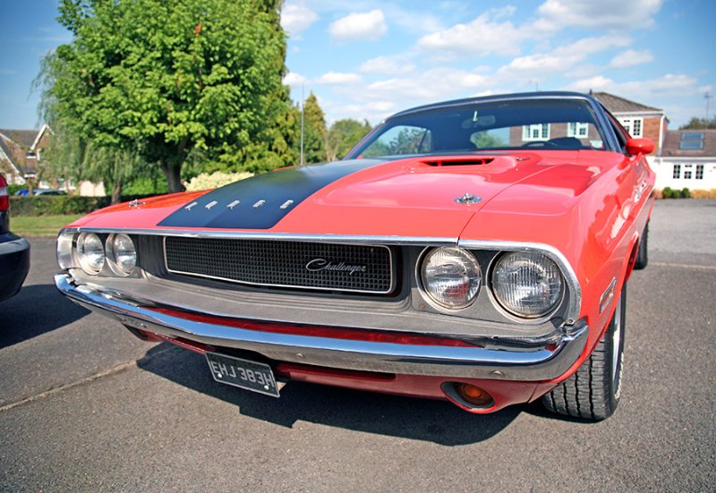

Have you been photoshopping again, or is that someone else who’s got the oddball colour combo? :lol:
