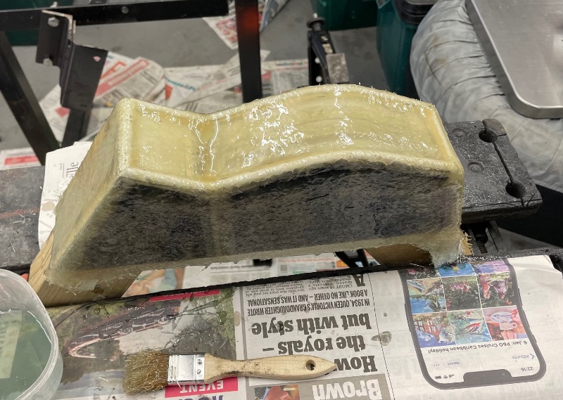

What I'm going to try and do is give it a neat couple of coats of fibreglass mat and then carefully remove it from the original. If it looks good enough that will be my new console. If not then I will use that as the mould to lay up an exact copy of the original. I'm making this up as I go along...

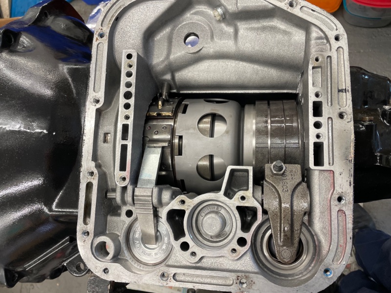

Not got much done in the last few weeks due to moving house but got back on it Yesterday and pulled the trans out. When you get a driveline failure on a Mopar it can damage the sprag in the transmission so to avoid catastrophic failure of the front drum, it’s wise to check. Unfortunately it means a full transmission strip as it’s right at the back. It was undamaged luckily and the rest of the trans is still minty fresh which is reassuring. Suspecting this might be the case I bought some parts to upgrade so the whole exercise wasn’t a waste of time.

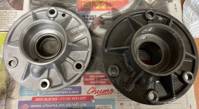

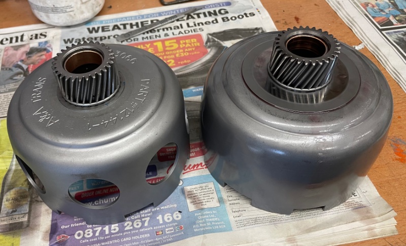

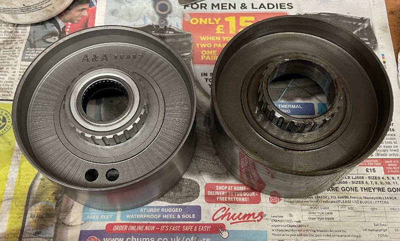

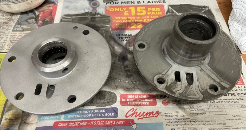

Friction is one of the first things you come up against on a Torqueflite when you start making some steam. The aluminium rear support has the output shaft running through it and the rear drum riding on the outside of it, at some point it will gall at both points. The fix is a modified support with a roller bearing for the mainshaft and the drum support milled off, the drum is modified to take another roller bearing and that then runs directly on the mainshaft.

I also opted for an aluminium park gear to replace the heavy cast iron one and a spacer to replace the governor assembly which no longer does anything with a manual valve body.

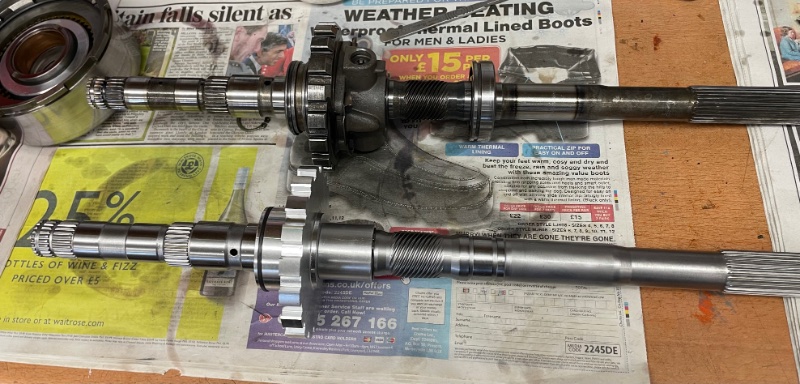

Thrust washer’s between the planetries also get replaced with roller bearings, couldn’t resist a lightened sunshell obviously…

Re: Blue's Barracuda

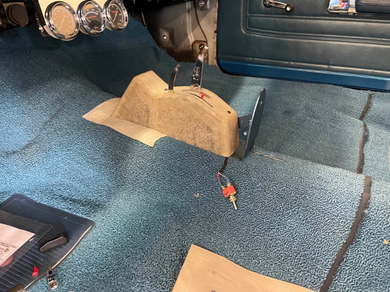

All back together and ready to go back in. Shifter just needs me to sort out the cover, that’s coming next.

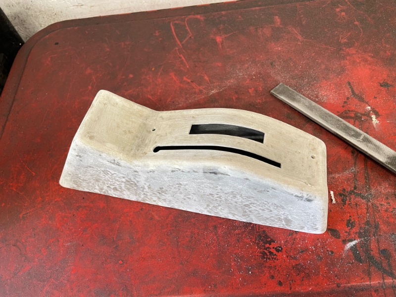

2 layers of mat over the shifter cover, see what that looks like when it’s gone off.
Posts: 14640

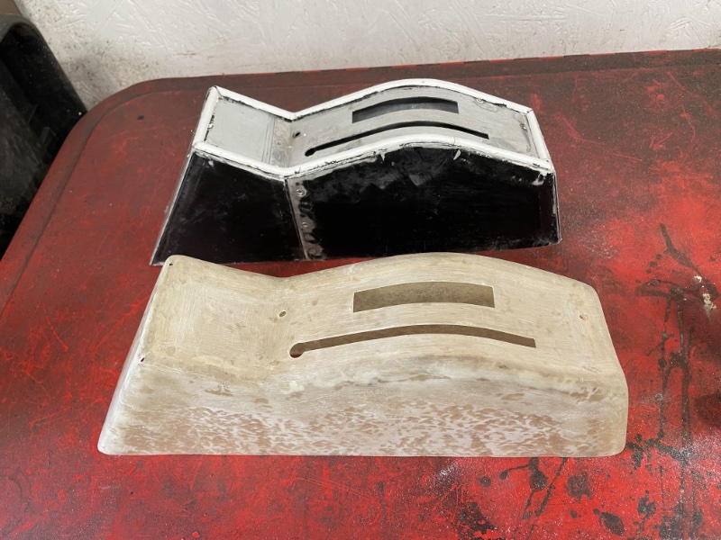

Bit of trimming and rubbing down and we have this, not perfect but good enough for the likes of me. For a first attempt at trying something like this I'll call that a success.

Looks good to me. What paint you giving it?

I want a textured finish so I’ll try truck bedliner and then a coat of blue to match the interior.
Posts: 7202
That’s a good idea. I wondered if you’d go wrinkle finish, but the blue would be way different.
