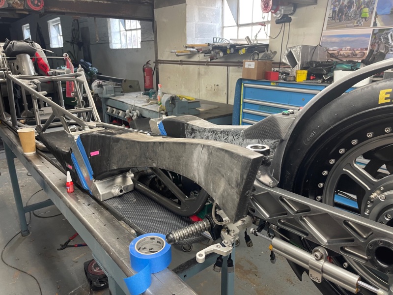

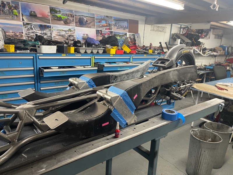

Looks like nothing I have ever seen
I hope the computer simulation is correct about this airflow ….
- B1D78B56-E01E-45DB-9F38-B946C6CC4F1E.jpeg (221.37 KiB) Viewed 16345 times
- 1514E024-3315-4B2E-8F28-92202017A9D0.jpeg (222.43 KiB) Viewed 16345 times

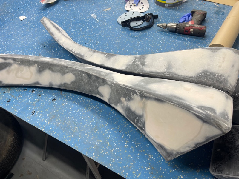

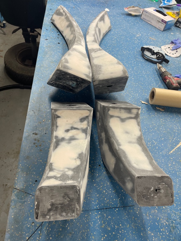

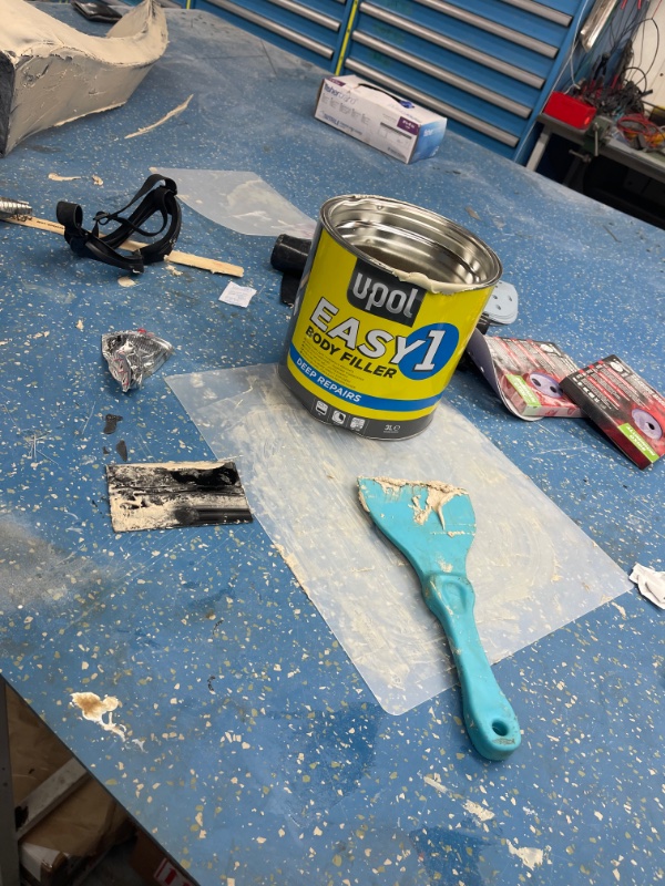

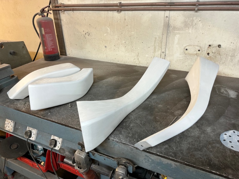

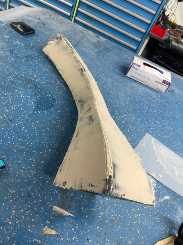

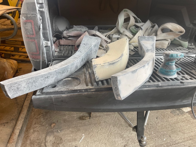

Re: Fifty shades of Jade

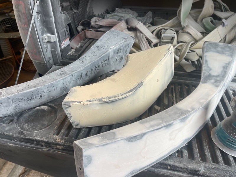

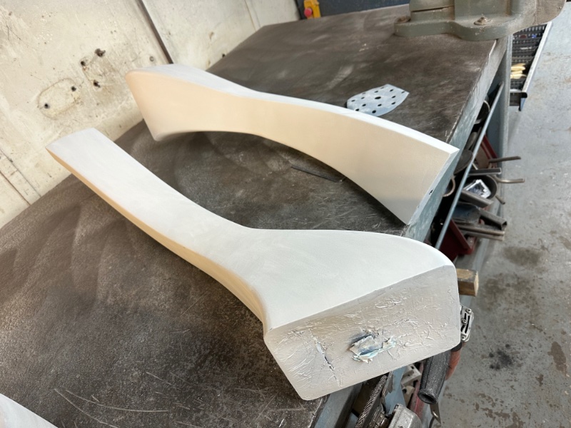

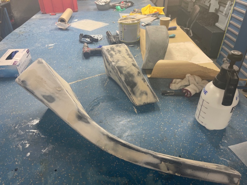

Body filler sand
Body filler sand
Sand some more ….
Body filler sand
Sand some more ….

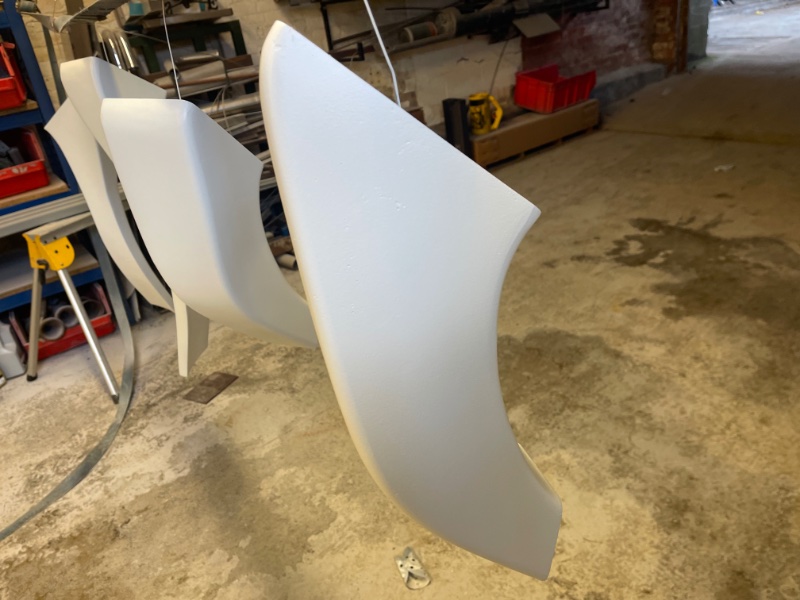

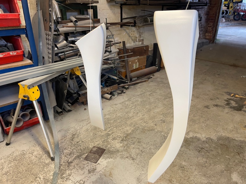

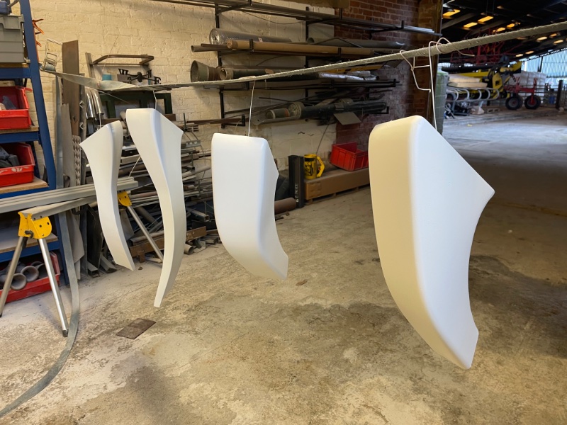

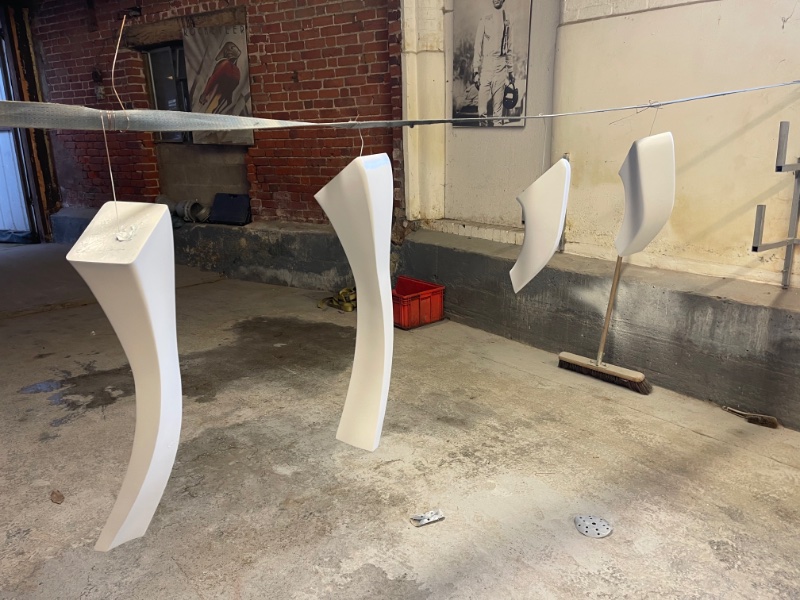

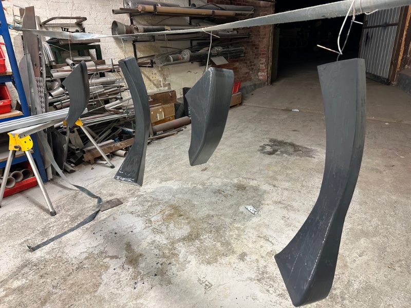

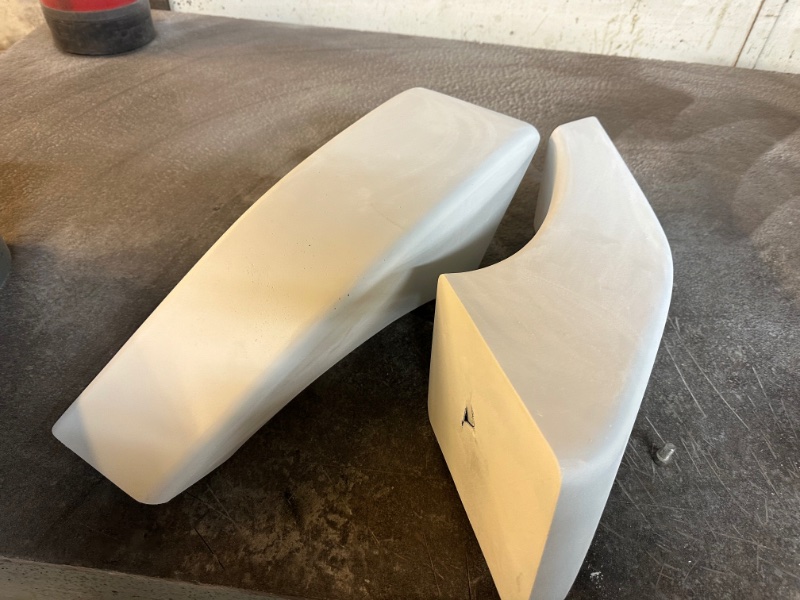

I was really struggling with low spot so decided to paint everything with a white primer to use as a guide coat.
This will basically be my Bananarama! stop sanding coat as I found in some area I was starting to sand into the 3D printed PLA plastic

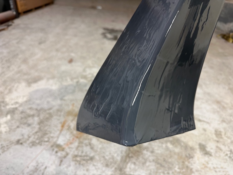

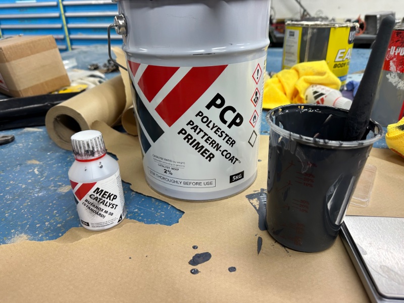

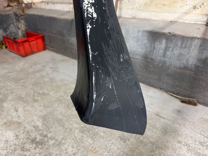

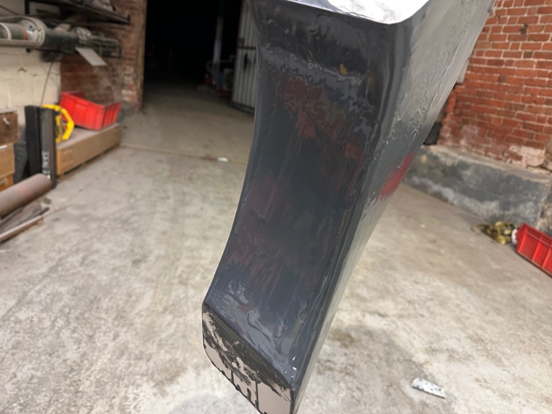

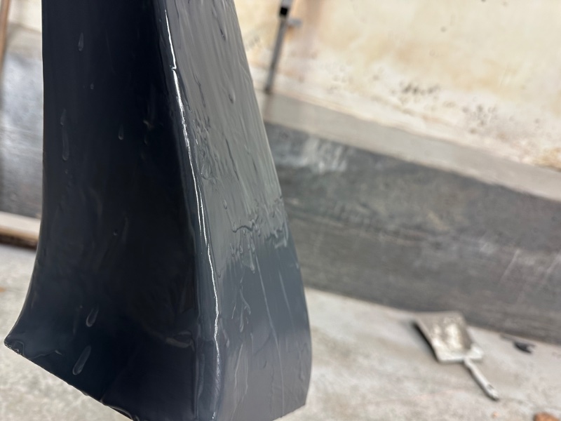

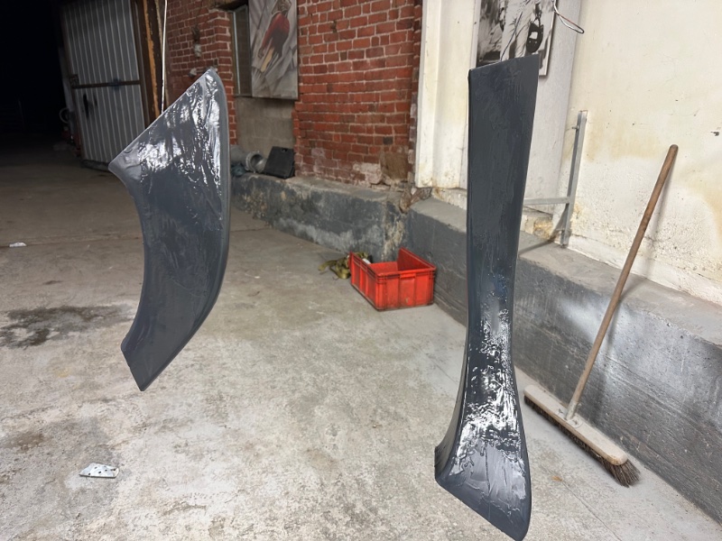

Next up I’m using a special high build pattern coat primer which will allow me to build up a thick layer and sand back.
This is supposed to be applied with a special cup gun as its so thick but there expensive. So I just applied it with a brush like I was fixing a roof leak on grandma shed.
The smell of this stuff is unbelievable if anyone is into high end glue sniffing this is the stuff

you may get that thick primer on smoother with a small radiator roller.

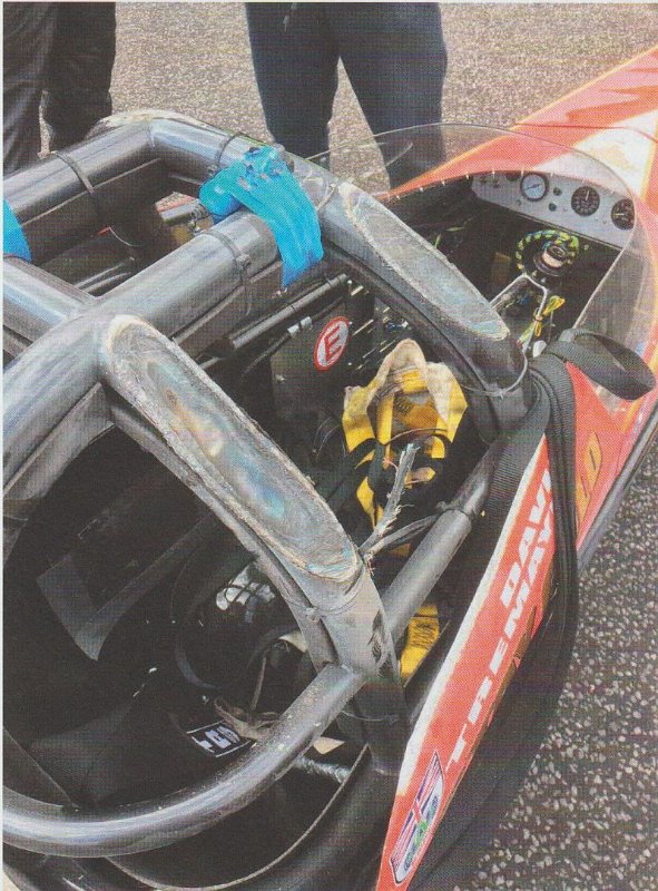

Just to make you worry again about the parachute launcher...
Did you hear about what happened at Elvington with Dave Tremayne in the Stay Gold jet car?
On a 250mph test run he deployed the chute which up to then (at lower speeds) had always worked well.
As it deployed the rear of the car suddenly stepped sideways to the right. Absolutely zero warning.
Less than a second later the car was sliding on it's RIGHT side down the tarmac still at well over 200mph.
Then with the rear tyres bouncing it suddenly flipped over onto its LEFT side.
It only took 12 seconds to grind to a stop. The roll cage wore down a hell of a lot in showers of sparks. Good job there wasn't a fuel leak too.
But the roll cage did it's job. He got away with a bloody finger and sore nuts from the harness crutch strap.
