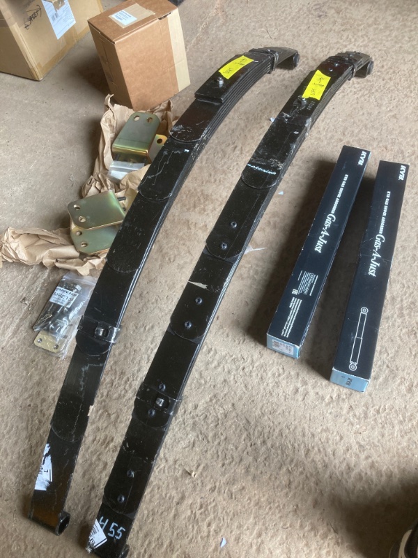

Well, having yanked the rear bumper and valance, this was going to be my today job, right up until I realised they don’t come with the rear bushings installed, only fronts.
Oh well.
The other thing is, having identified which is left and which is right, I can’t see anywhere if that’s looking from the front or the rear of the car.
I’m assuming from the front, but can anyone confirm?
Oh well.
- image.jpg (205.27 KiB) Viewed 14683 times
They should have part number on them, if not the set with the most leafs goes on the Pass Side...
You did not have to pull the Bumper to do that, but it is far easier (but not impossible) to do the job with the Vallance off...
Fit the Shackles to the springs and car first, and then jack the spring up so that the Front Hanger engages in the Torque box.
Also you need to decide what finished ride height you want when installing the Spring in the front hanger hols.

Yes, I know which is which from the part numbers, but that only correlates to left and right. What I mean is, is that left when you are looking at the car from the front, I assume, not the rear?Pete wrote: Sat Jul 01, 23 3:55 pm They should have part number on them, if not the set with the most leafs goes on the Pass Side...
Had to pull the number anyway, I forgot to mount the adjustment bolts when I put it on, so it’s all off for now to be redone. Besides, as the bumper is new, I know exactly what would happen if I left it there…

Ok, that ties up with left as you look at the car. Cheers Pete.

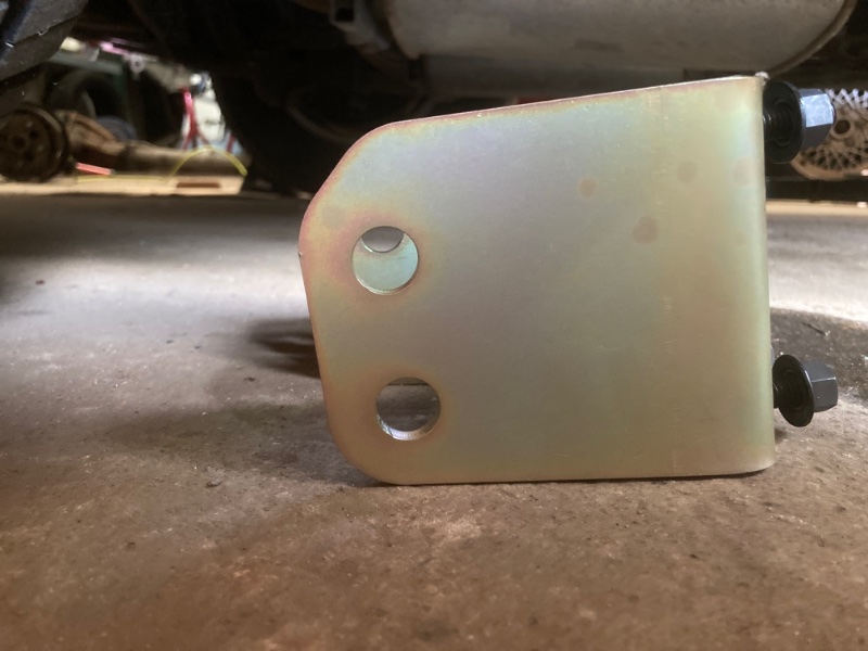

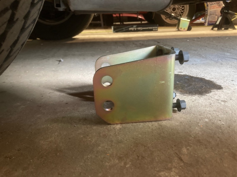

Next dumb question, the front hangers have a rounded edge and an angled edge. Does it make a difference which is top / bottom?

I would imagine the angled bit is to clear the floor pan.

That’s possible, yes. Will see when I offer them up tomorrow.
The Plates are handed and will only go in the Torque Box one way - try a dummy up first before mounting to the spring....
