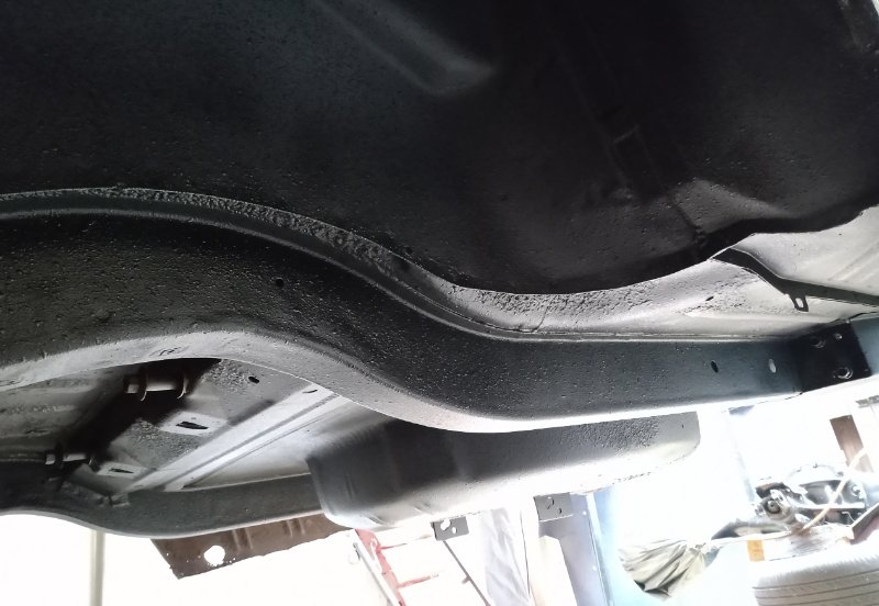

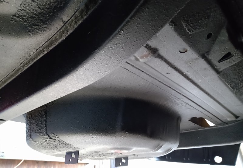

As you may have guessed I'm not the best at keeping regular updates (& progress has been slow due to other commitments) but thought I'd summarise some of the work completed in the last few months.

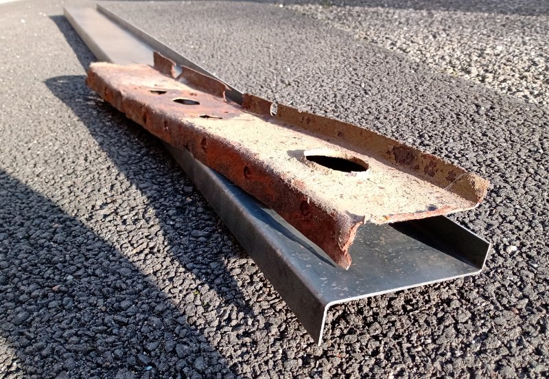

The underside is now virtually complete with any localised areas of rust cut out & replaced. The rear floor pan/main boot floor etc were actually really good with the main rust concentrated at the very rear (drop-offs, rear crossmember etc). I've replaced the N/S drop-off panel, repaired the end of the N/S chassis leg & a few other localised bits in the boot floor & removed/repaired the tank strap bracket. Just the lower edge of the O/S drop-off panel to sort & that's the boot floor done. The crossmember was in a poor state, so that was removed & I've had a local fabricators fold me a like-for-like Z section which I can use as the basis of a new crossmember. The leafsprings have been dissasembled, stripped, repainted & rebushed with new shackles etc.

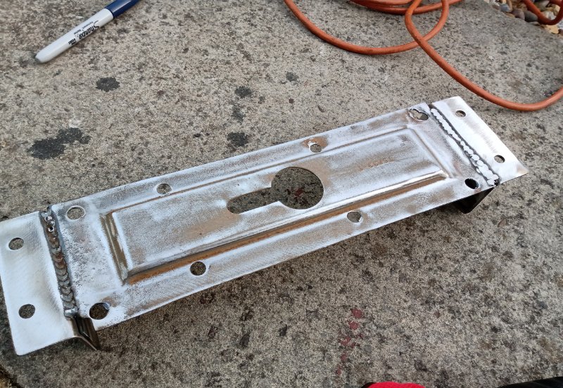

Tank strap bracket angles repaired

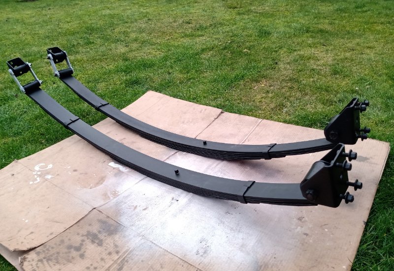

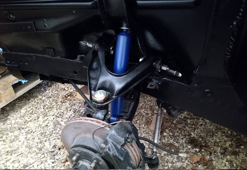

Front suspension loosely assembled with new bushes, shocks, ball joints etc
Leaf springs reassembled with new bushes & shackles

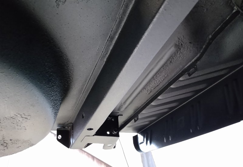

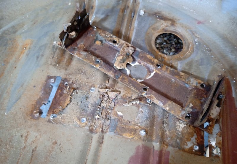

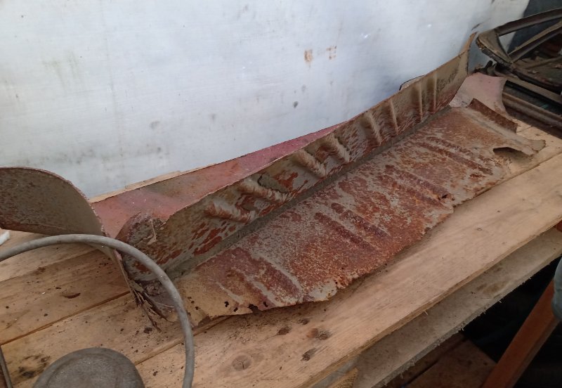

N/S boot floor dropoff - pretty crusty!

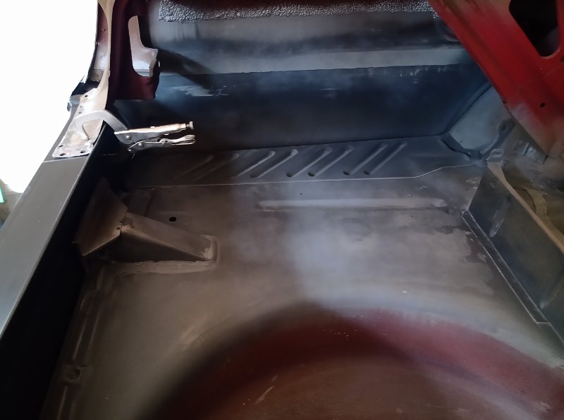

New drop-off fitted & localised repairs
All now given a coat of protective black..

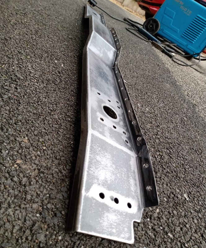

Z Section for rear crossmember

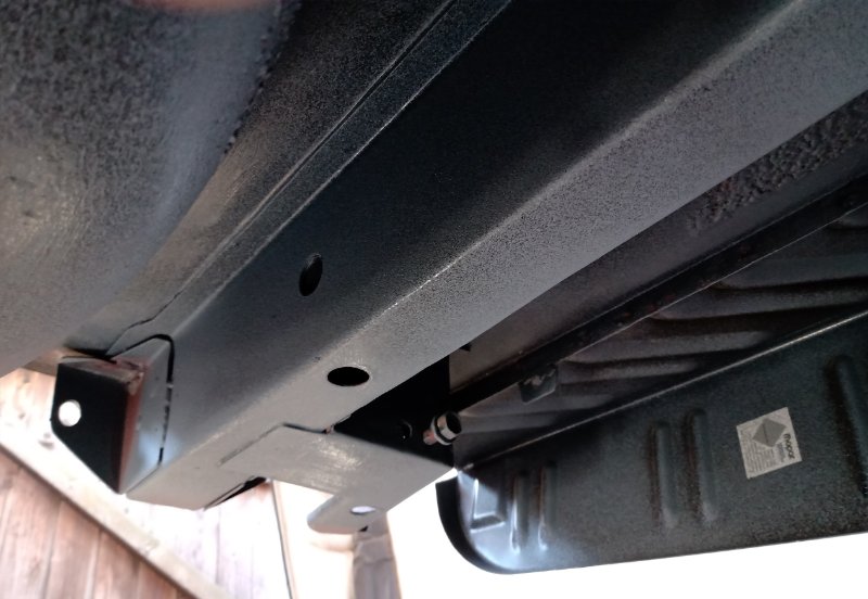

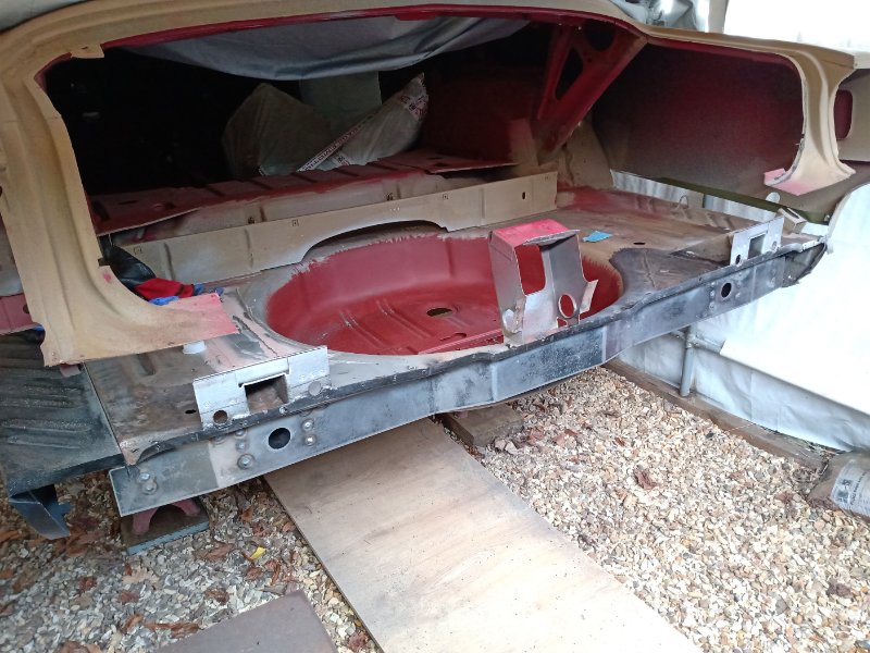

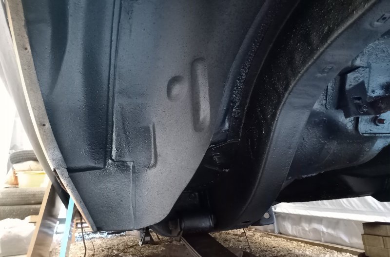

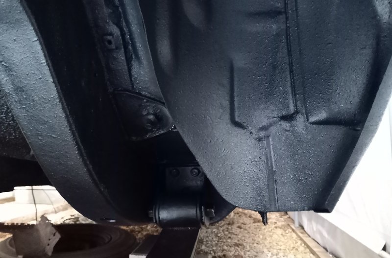

Rear crossmember finished off & welded into place over the weekend. Also a few pics of the finished lower portions of the wheel tubs which were cut out & replaced a while ago..
REAR CROSSMEMBER.jpg (216.99 KiB) Viewed 22125 times
CROSSMEMBER IN SITU.jpg (139.67 KiB) Viewed 22125 times
NS WHEEL TUB.jpg (96.75 KiB) Viewed 22125 times
OS WHEEL TUB.jpg (89.52 KiB) Viewed 22125 times

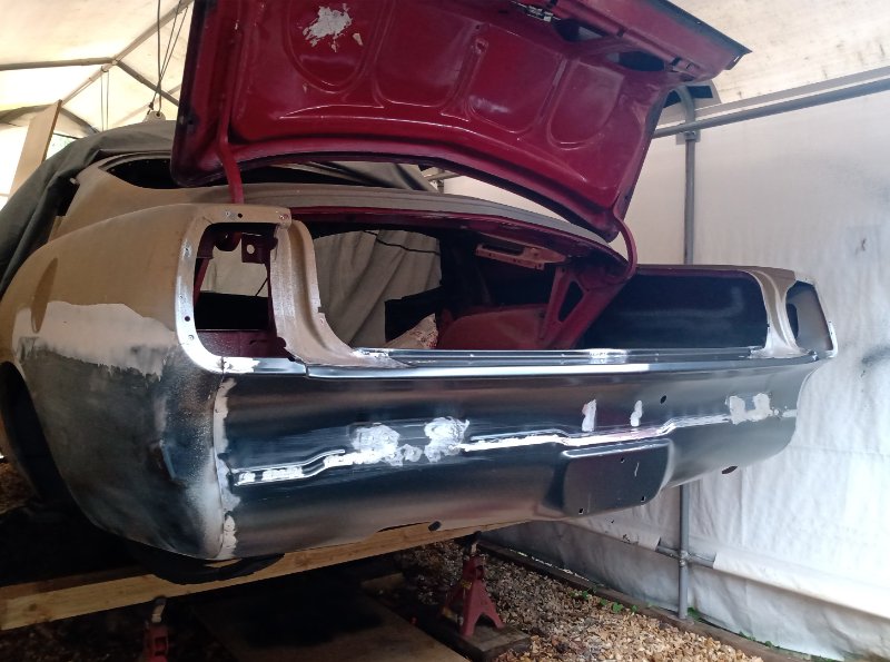

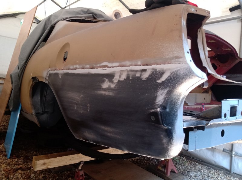

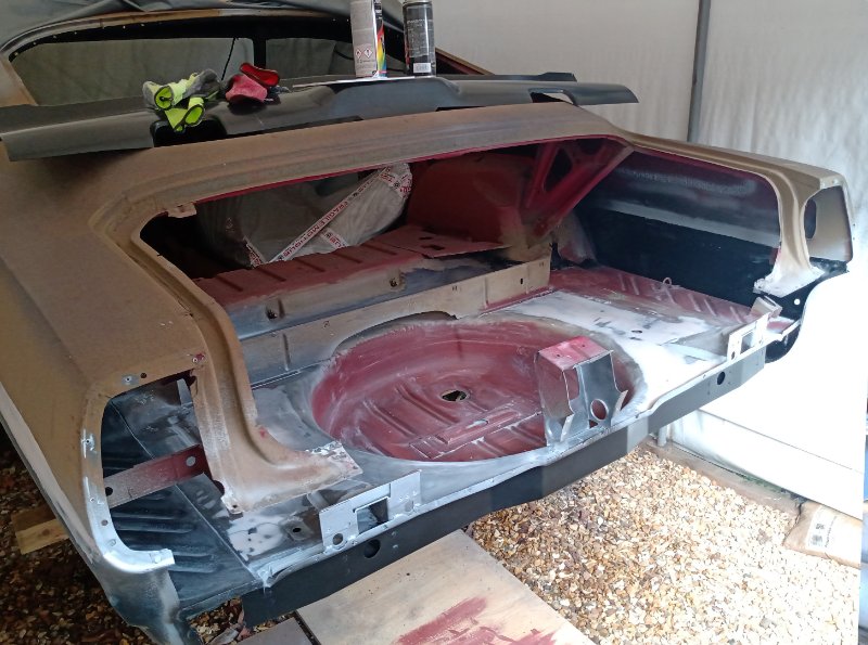

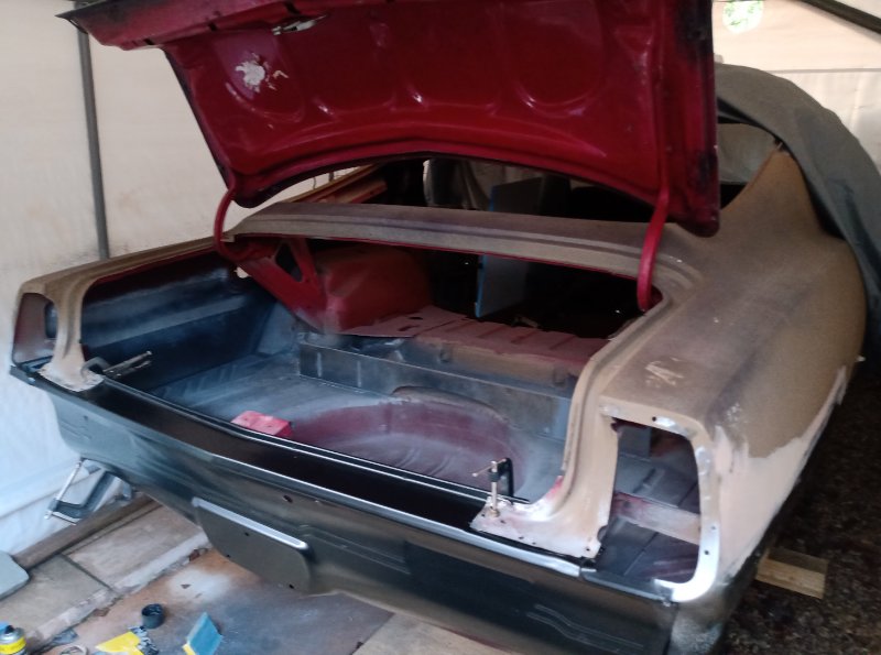

I've been chipping away at the rear end over the past 6 months, and (albeit slowly) things are now coming together nicely.
It's a bit of a struggle in my "tent" & time has been limited, but it's getting there.
With the dropoffs, boot floor & rear crossmember finished I've been on with the lower 3/4 sections & new rear panel. All AMD panels which I was really impressed with the fit & finish of. This has been a more rewarding stage as the rear end has finally come together & it looks something like a car again!
I can actually see a result of my time spent.
Various pics of this stage as follows:
