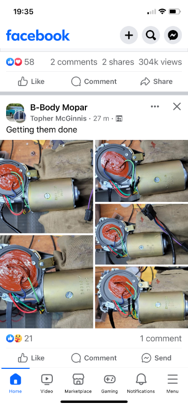

If you are on Facebook Steve, there’s a guy on the bbody page that restores them.

Yeah thanks guys, I'm aware of Topher in the states but I was hoping for a solution a little closer to home !. Perhaps that might be my only solution.

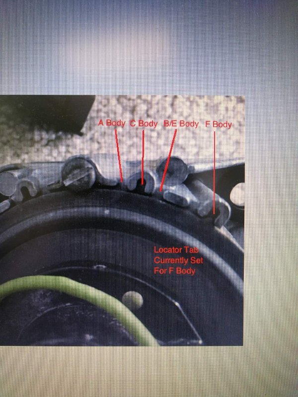

1973 Polara motor follow the link below and click "notify when in stock" might take a couple of months but thats how I got mine. You then lift the cover slightly and rotate to the appropriate position to set the park, as in the photos.
