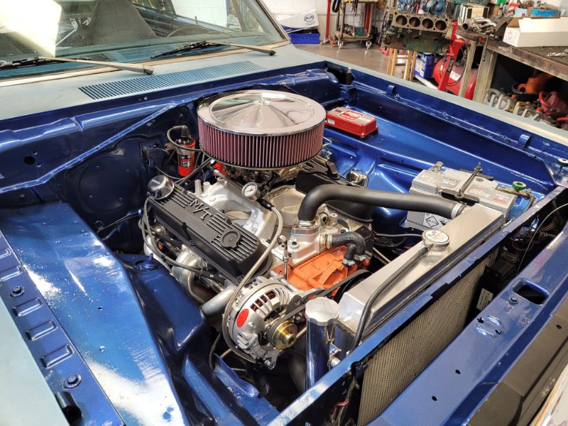

The 390 I've spent the last three years researching and building.
Night and day difference, even though I've take it no where near its limit yet.
I did the same and got second engine so I could keep mine on the road while it was being built.
Glad I did.
One thing that needs to be mentioned.......cost!
Make sure you have a realistic view of what it will cost, especially with the bloody awful exchange rate we have these days.
I set what I thought was a good budget. Final build cost was double.
Did I enjoy it....yes
Always wanted to spec and get an engine built with my ow personal goals.
Was it worth it....ask me after I've put it on track.
Would I do it again......TBC.

Nice job, the '68 Barracuda we have has run a 13.88 @ 99 and some change with a 3.23 gear (0.030 over 318), It barely gets into 3rd gear at the strip. I've had the speedo off the end of the 120mph scale a few times. Car feels wayyy light at the front end at those speeds.

15.25 at 82 on a smog era 318.
My hope for low 12s now.
The other costs that are worth considering - axle upgrade, gearbox upgrade and torque converter to match the new engine and intended use.
I built mine from the back forwards so had the first two sorted with the end goal in mind well in advance.
Re: 318 .. 360 Engine ?
a 318 is cheaper to buy than a 360 and doesn't give up much displacement with the 4" stroker kit, 390 vs 408 with both at .030" over bore. also your sump, mounts etc are a direct swap with another 318 block whereas they're not with a 360 block.

Nice !!Dave81 wrote: Wed Feb 28, 24 9:41 pm The 390 I've spent the last three years researching and building.
Glad I did.
