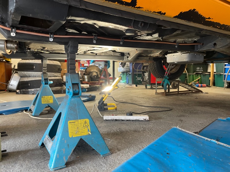

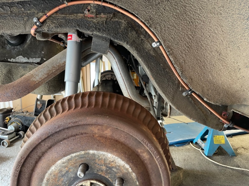

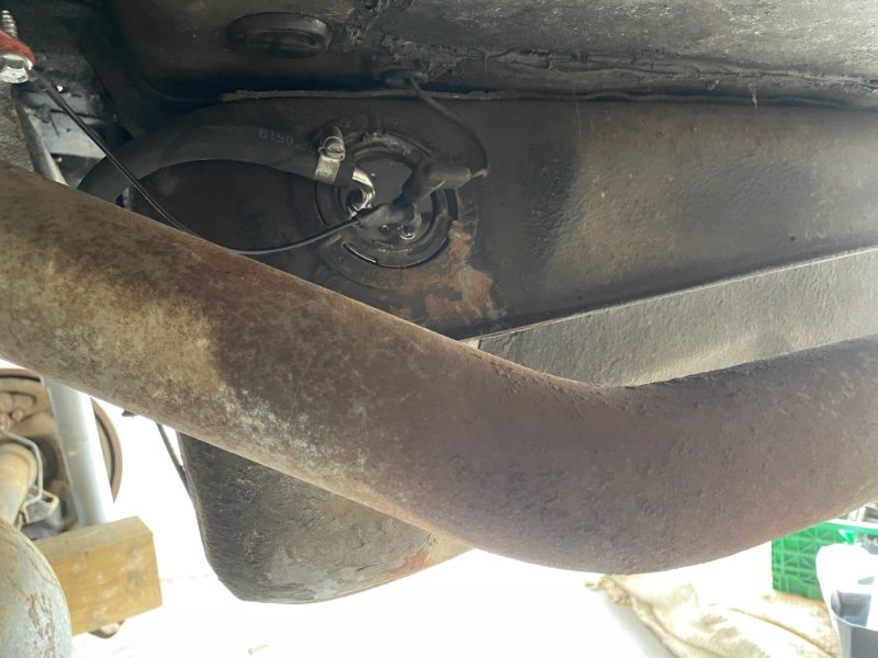

3/8” sender and fuel line fitted.

Top work...are you putting a return line into the tank?
Posts: 7201
sublimemike wrote: Mon Mar 18, 24 10:46 am Top work...are you putting a return line into the tank?
No, but the whole fuel system is being re-routed and fresh Kunifer lines installed. Much tidier!
2001 Dodge Ram Van
Posts: 14604
Still using a mechanical pump Mike so no need for a return line.

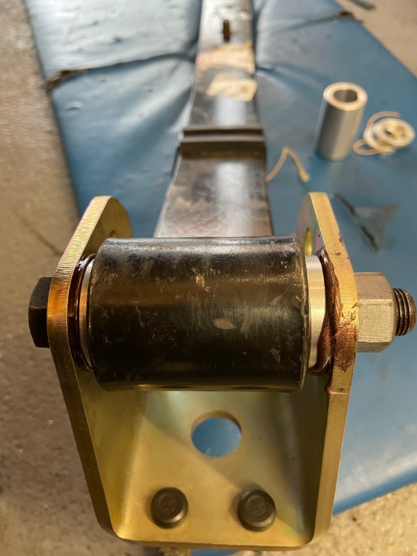

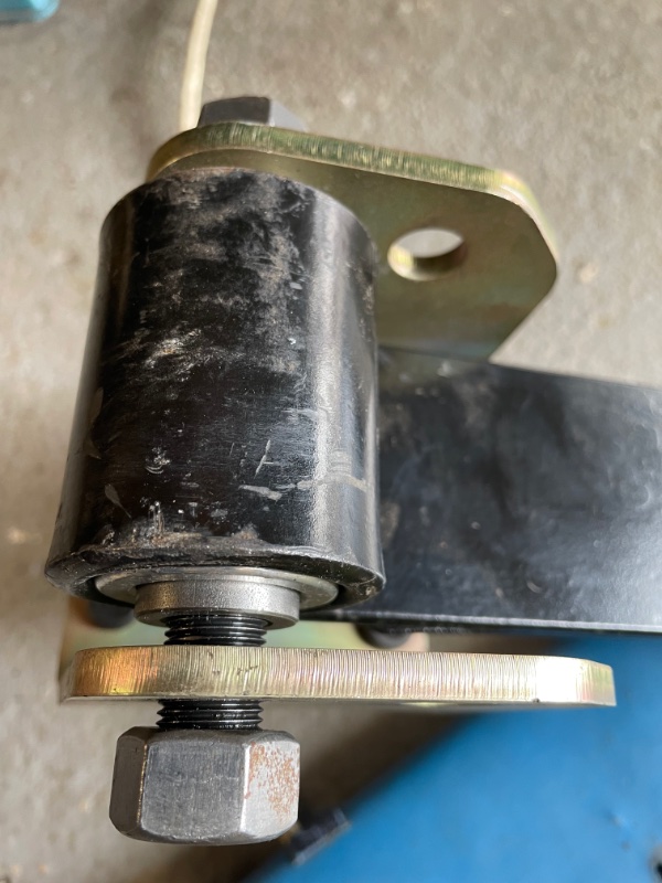

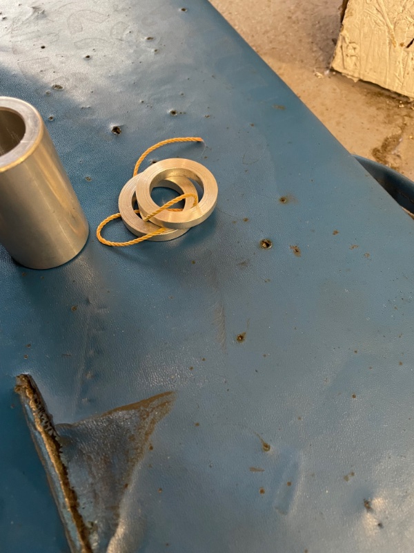

Solid front bushes fitted in the super stock springs. Aftermarket hangers as well so of course none of it fits together like it should. Spacers being turned up as we speak…
Posts: 14604
Sorted, handy when you’ve got a man with a lathe on hand!

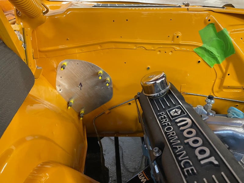

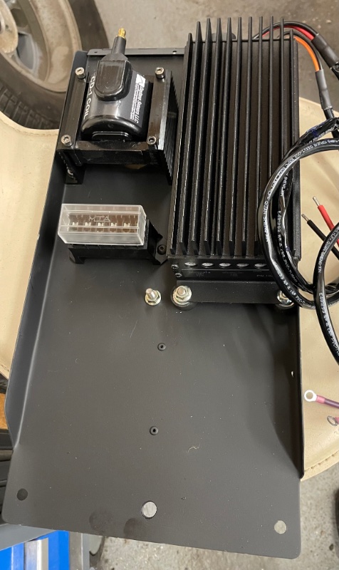

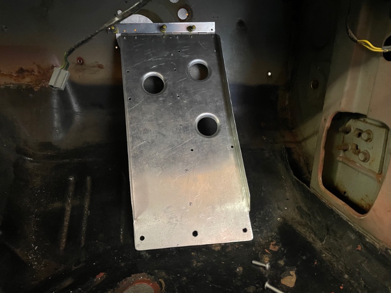

Usual heater block off and ignition panel malarkey..

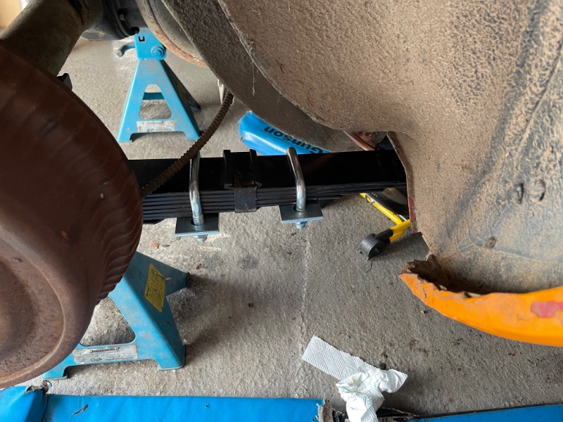

Front section of super stock springs clamped for minimum deflection, that’s the back end sorted.

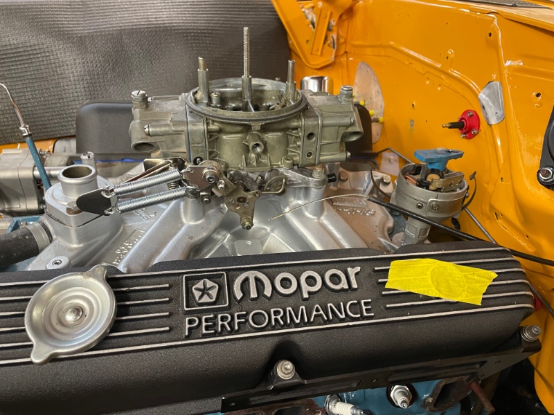

Rebuilt 750 carb for hopefully a bit more top end. Distributor locked out and vac advance removed. Ignition system is a Daytona sensors CD1 which has pretty much anything you’d ever need built in and fully adjustable with a laptop, far superior to MSD in my opinion. We’ll program our own advance curve hence locking the dizzy out.

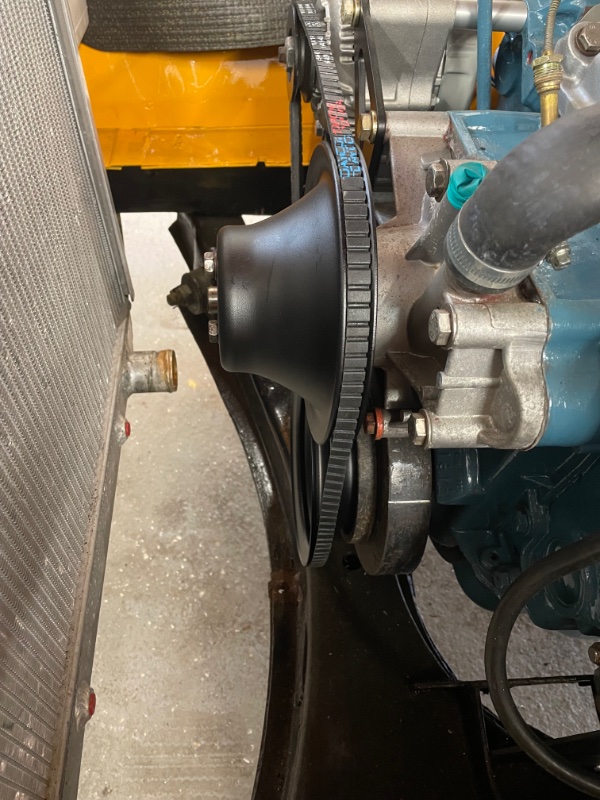

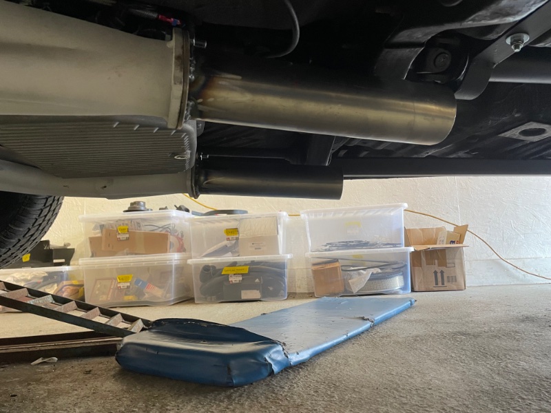

Correct pulleys and belt fitted, just need a suitable spacer for the fan and that’s sorted. Collector extensions made for increased low end torque.
