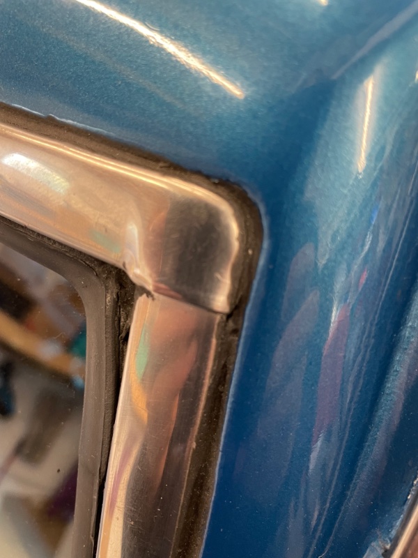

I might try that, I am struggling with the rear screen at the moment and I bought an expensive sealant which is proving hard to work with.Blue wrote: Sat Oct 21, 23 5:11 pm This stuff is mustard, https://www.ebay.co.uk/itm/172241116794
Recommended by my windscreen guy, it’s non setting. I apply it around the trim and you can wipe it off trim, paint, glass for a really neat finish and it seals.

Thanks Blue, several people recommend Tiger Seal in preference to silicone. The problem I found with Tiger Seal is it skins over quite fast if you’ve faffed about removing masking tape, and whatever is left in the tube after a day or so will be impossible to get out of the tube.
Re: Rob & Stu's 69 Sport Satellite
I have not used masking tape, I have been doing it freehand, with a quick mop up of any overspill with either Acetone or Brake Cleaner - but either way, you have to work fast!!

Good job as I have the same problem on windscreen corner.
Will try the sealant that Blue put up, thanks.

You can make a real neat job of it.

Neat job.
Do you use water or a solvent to wipe it off? or just lick your finger?

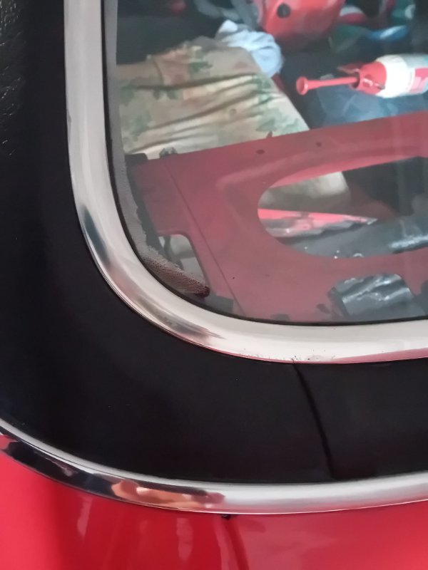

I used masking tape mainly because i thought the vinyl roof would make it difficult to get a clean edge.

Just paper towel to get it off and to smooth it. Because it’s non setting you can go back to it anytime if you notice a bit you’ve missed.

Here is my Freehand effort at sealing the Vinyl roof to the trim, the trim to the Glass, etc, etc....
I have found the 'Cuda window shape inherently more difficult than the "B" body arrangement (such as my Super Bee) as the curvature and the generally poor fit of the trims have proved challenging.
..and finally the 'Cuda is water-tight!
This sealant does not remain flexible and does cure, so you have to work quickly.
We shall see how this holds up in the longer term.

Well that looks good from here, Pete
Do you think that seam in the vinyl could be a place where water's getting through? It's only a short length but like our rear lights, it doesn't take much
Actually Rob it was leaking everywhere, the previous owner(s) did not do a correct job; so I had to dig all the old stuff out and start again....
