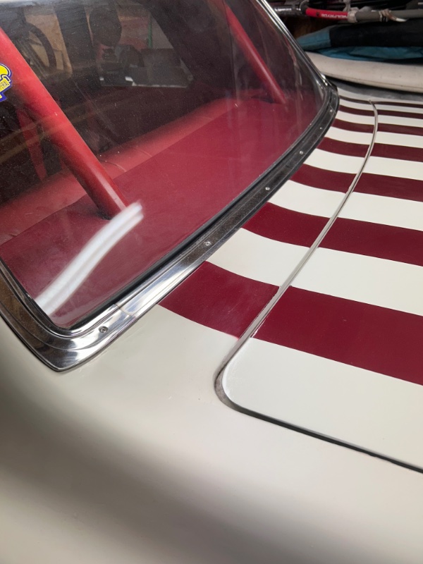

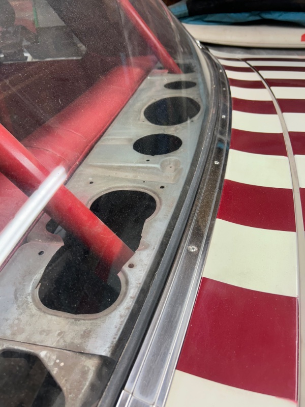

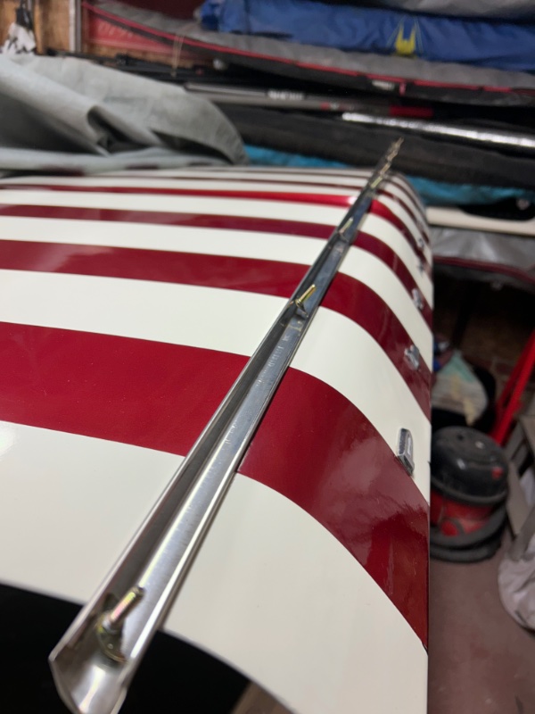

Waiting for the propshaft and some other bits but a deeply satisfying trim fixing day ..Last piece of shiny
Posts: 7615
Re: 64 Plymouth Belvedere post car
Not long now. =D>

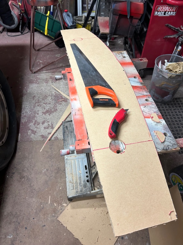

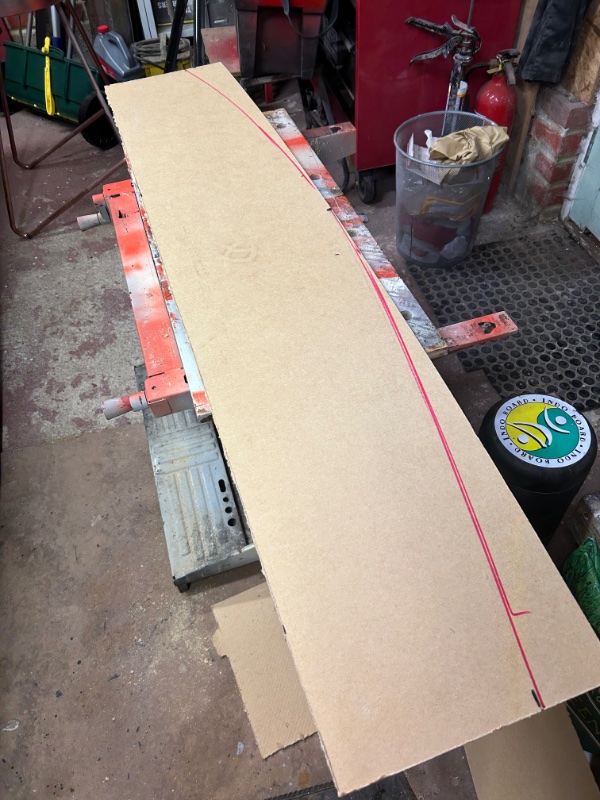

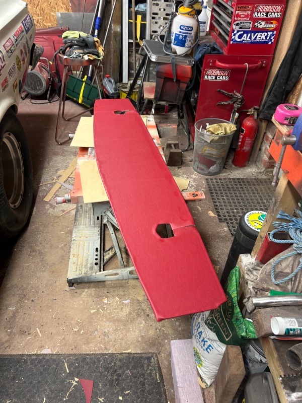

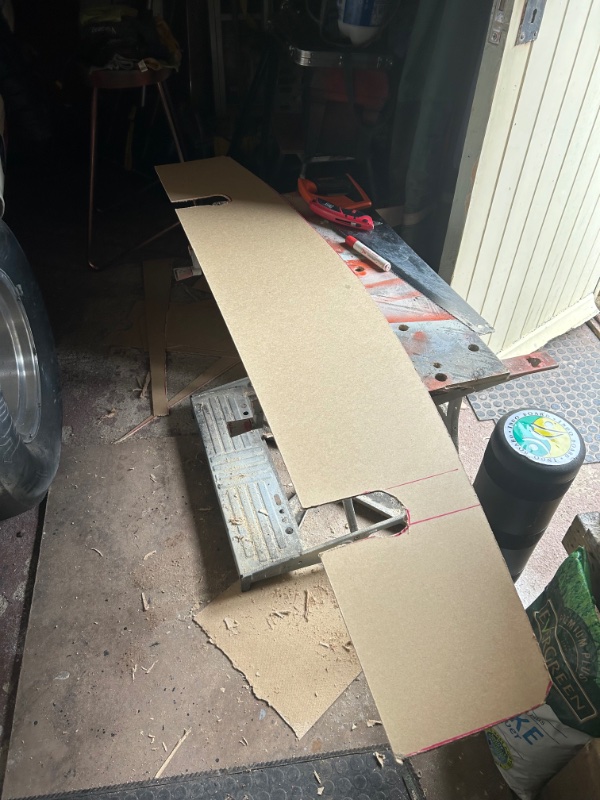

Parcel shelf Is a pain with a roll cage ,and I wanted it so it can like all the rest of the interior be removable for weight loss if racing gets serious ..Hardboard base (be a liar if i told you I got it right first time ) but it tidies up the shelf nicely ..

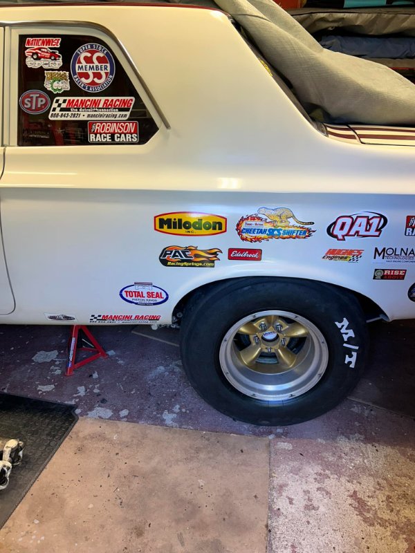

As Dragstalgia approaches the final jobs are getting ticked of .New Micky Ts Drag radials 30x9 inch .Went down a size as the 30x10.5 were rubbing the springs that i have returned to there stock position ...Few small jobs to finish up and i am as ready as i will ever be ....
