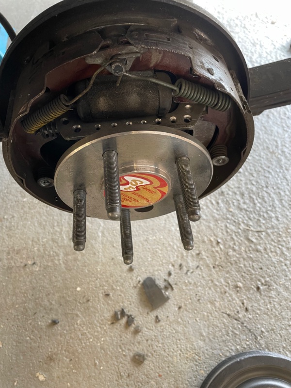

Failed miserably when one of the rear shoes fell apart at the 11th hour. So, on with what I should have been doing 6 months ago…

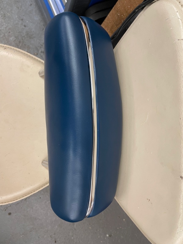

Bit of cheap 7mm adhesive chrome strip off eBay finishes off the head rest nicely.

That looks tidy!

That works :thumbright:

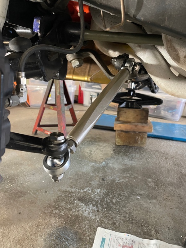

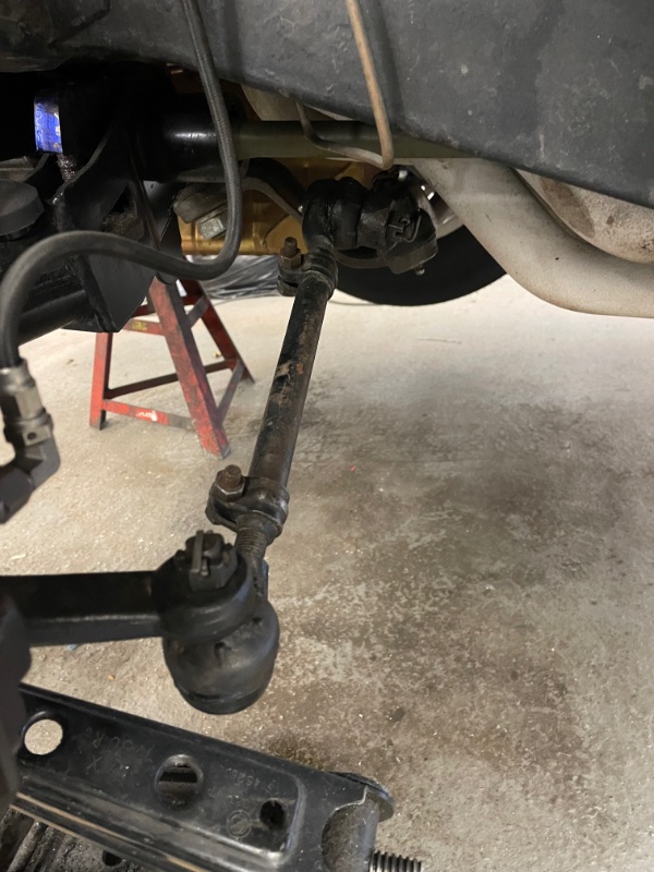

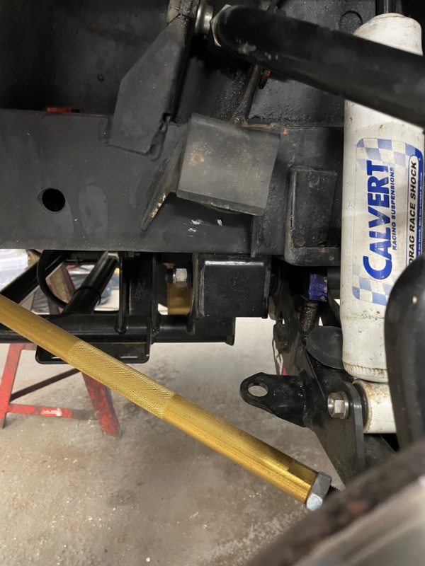

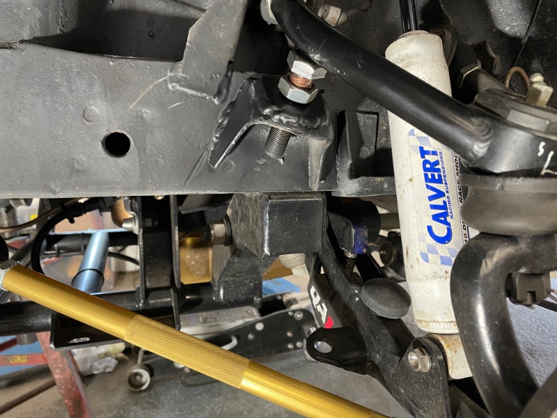

Today’s job, adjustable front suspension limiters and Hotchkis steering arms. Being able to adjust front suspension travel is one way of controlling wheel stands, plus it stops the rod ends on the steering arms from running out of travel.

Those rose jointed arms look trick! Any issue with them rusting?

Not seen stuff like this rust but then the car never really sees bad weather, I will fit some boots though to keep dirt out.
