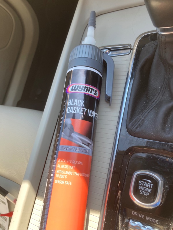

I’ve ordered some Permatex Ultra Black as a back up, but as I need to do the job tonight (Intake Manifold, so a thick bead at the ends required) I dropped into the local Motor Factors and all they had was Wynns Black Gasket Maker.
It all looks and sounds the same to me, but as I haven’t had an issue since switching to Wurth, it made me wonder.
