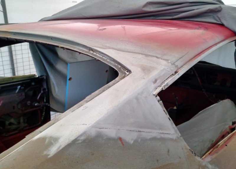

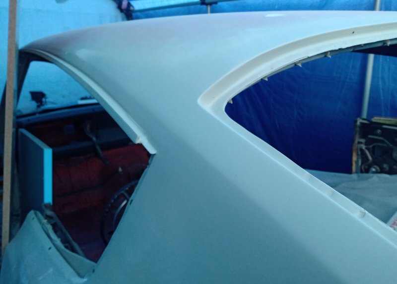

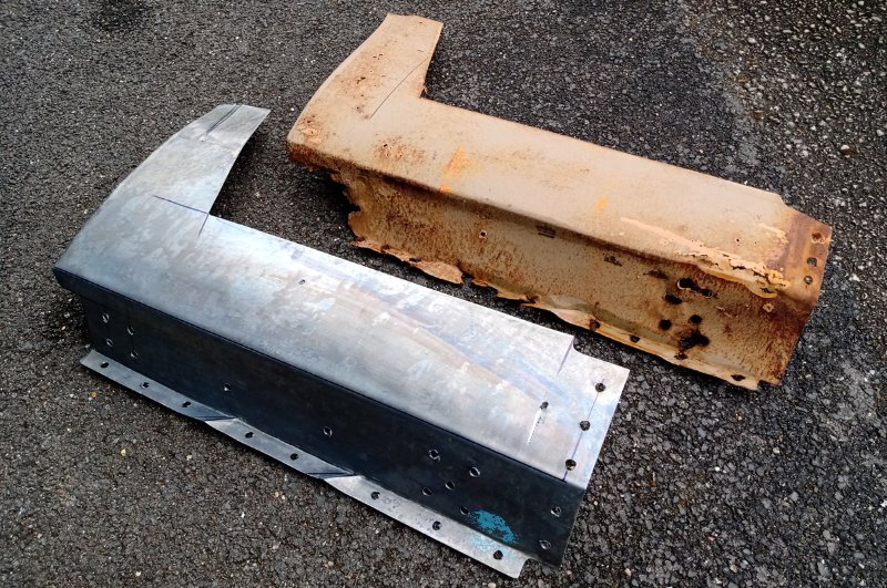

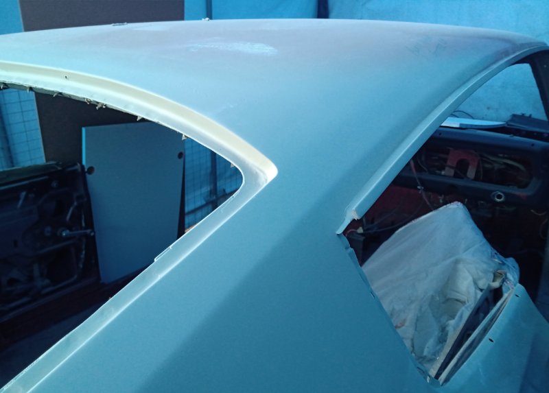

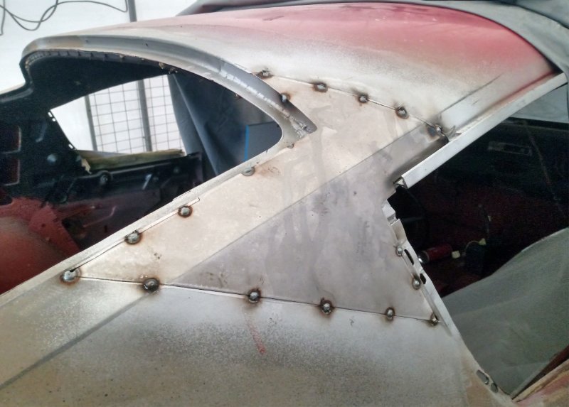

Ok so a quick update on progress over the past few months.
When I got the car, it was obvious that there was rust in the C-pillar/roof join area bursting through. I think this must be common with the fastbacks as of the ones I've seen in the flesh, this area often looks to have been filled or have "something going on".
So when the car was going for blasting, the outer skin in this whole area (both sides) was completely removed to allow the bare inner structure to be blasted. It was actually surprisingly sound & didn't need any cutting out. For good measure though (while I was in there) it was well & truly reinforced with thick plate & painted before the outer skin sections were let in.
Pics to follow, showing work on the outer skin/results.

Pillar/roof pics:
- 1.jpg (93.43 KiB) Viewed 26470 times
- 2.jpg (82.09 KiB) Viewed 26470 times
- 3.jpg (72.21 KiB) Viewed 26470 times
- 4.jpg (65.77 KiB) Viewed 26470 times
- 5.jpg (84.02 KiB) Viewed 26470 times
Re: RHD '68 BARRACUDA RESTORATION
That’s the join where the roof meets the rear quarter, leaded from the factory. Often looks a bit lumpy when moisture gets under it and it ‘blows’. Very nice repair as usual!

Yes, a very common area for them to go. Like Blue says, lead lined seams go from the inside. Great repair without replacing the panel, wish I’d have had the nuts to have a go at it on my old one! Excellent looking work.

Thanks for the comments all.
That's exactly what had happened, the rust getting under the lead & pushing it out. I did expect the inner structure to be knackered but it was surprisingly sound. The stresses/flex in that area on the fastback especially must be crazy!

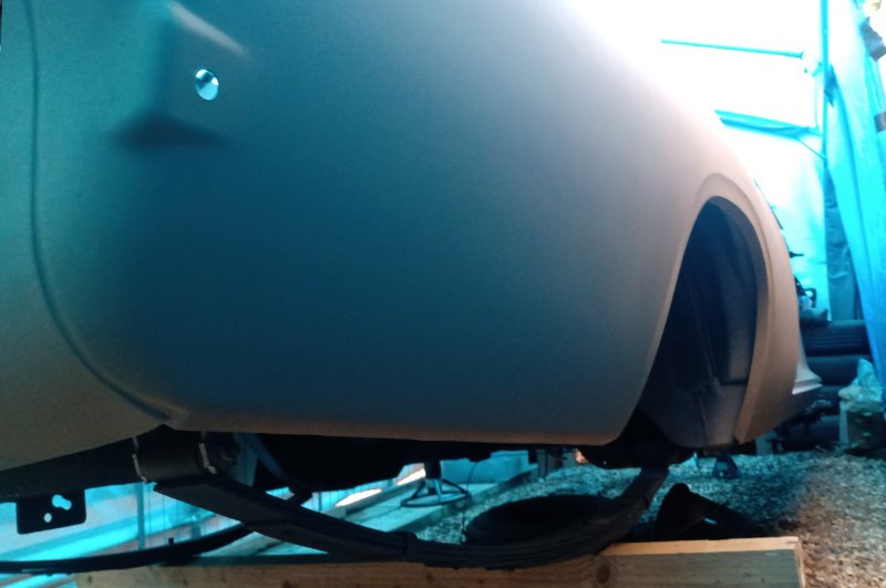

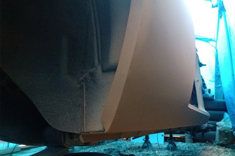

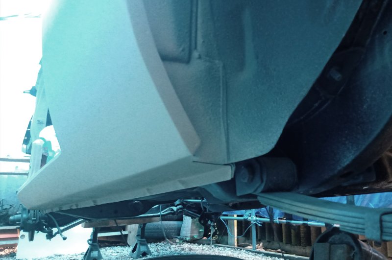

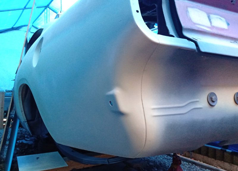

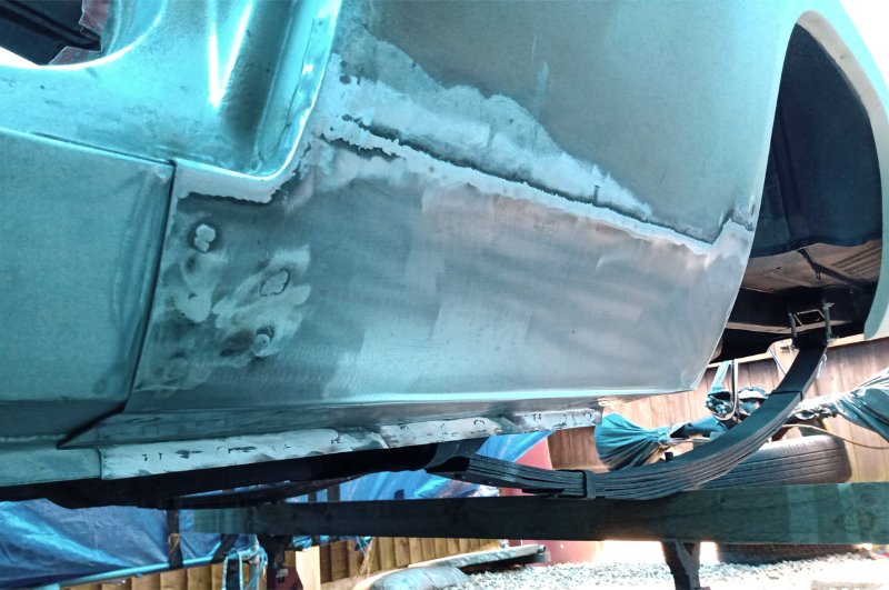

A few more pics, the final bits of metalwork on the main shell.
The lower sections of the rear 3/4 panels forward of the wheel arches were removed some time ago as they were frilly & some locallised repairs to the sill ends underneath were needed. Outer skin sections now made up & welded in, with a skim over the top to finish.
OS & NS LOWER REPAIRS:
- 6.jpg (107.5 KiB) Viewed 20900 times
- 7.jpg (79.46 KiB) Viewed 20900 times
- 8.jpg (74.58 KiB) Viewed 20900 times
- 9.jpg (186.32 KiB) Viewed 20900 times
- 10.jpg (69.1 KiB) Viewed 20900 times
- 11.jpg (68.86 KiB) Viewed 20900 times
