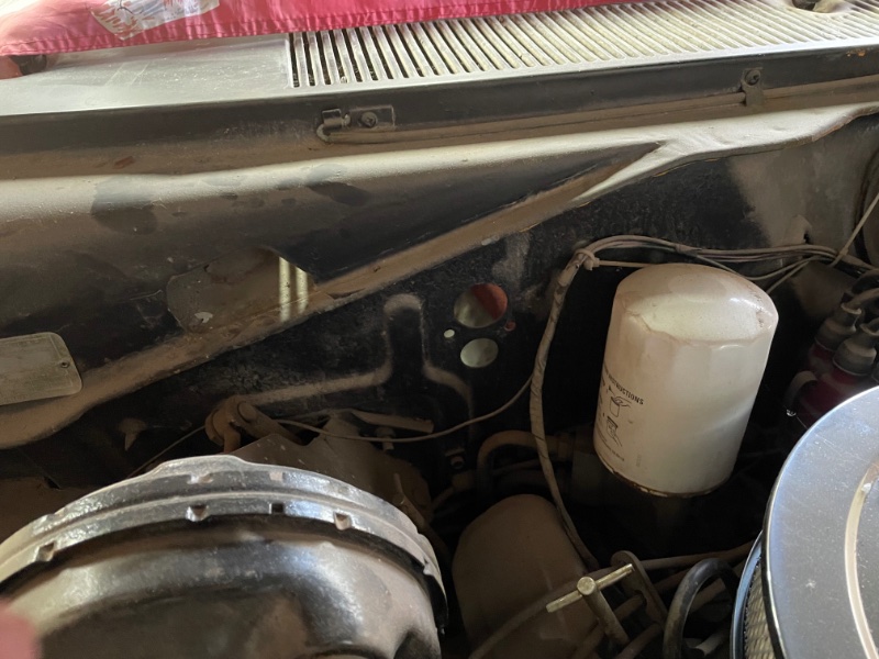

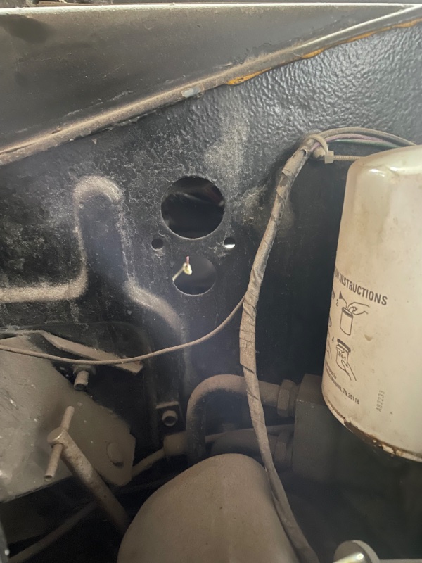

Hi, I just noticed this on my 1972 charger 770 ( only had it 15 years
), it looks like where the clutch cyl would go. My other charger 770 doesn’t have these holes.
Both are 318 v8 / auto trans, the one in question has a vague history but nothing indicates that it was ever a manual.

aren't heater/ac pipes often there? that's what it looks like to me. maybe this one had ac originally and your other didn't?

The heater pipes are on the other side but I think that you may be right on the air con suggestion, now that you have said that , I think that one of the option codes was for air con
Re: Was this once a manual trans?
yeah mine has/had aircon and i have 2 snapped off pipes from the aircon radiator (can't think of the term at the mo) thing there

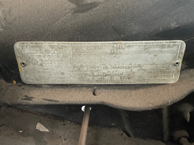

H51 Option as per the plate
a clutch rod hole is oval
you probably have a fuse in the top position and an orange wire floating about under the dash for the aircon control light as well
