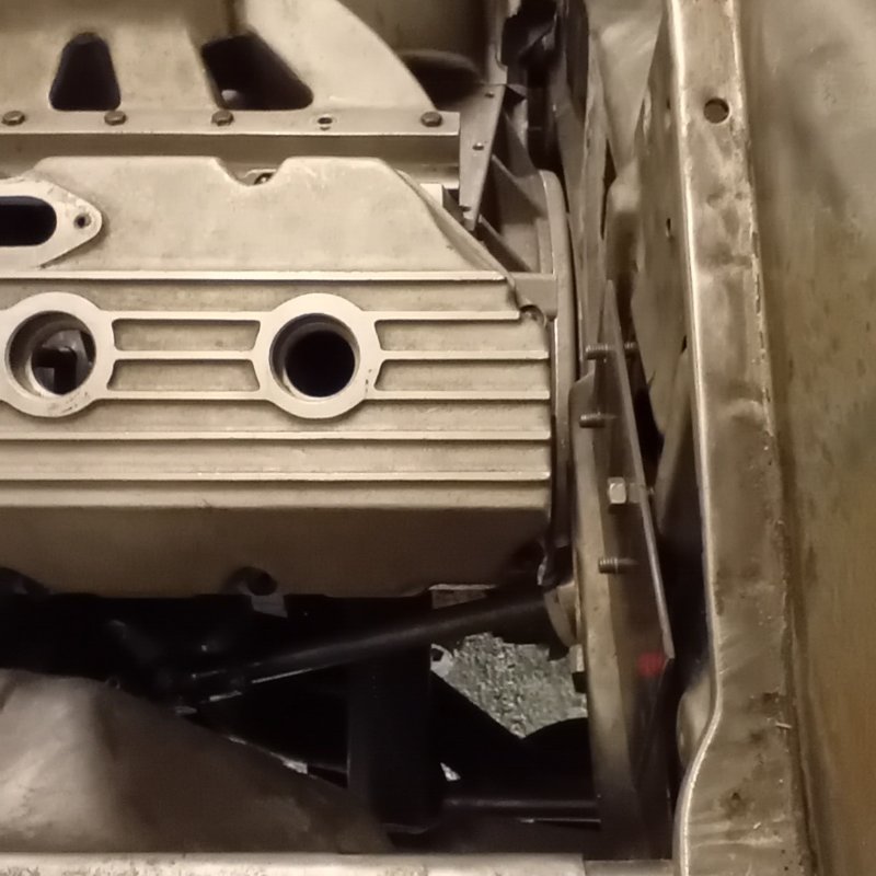

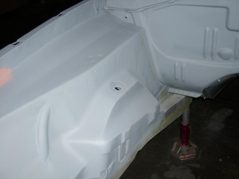

This is the sort of modification needed if you want to get the engine in the correct position and also be able to take the Pass Side Rocker Cover off for maintenance work >
Shock Tower.jpg (23.9 KiB) Viewed 9459 times

newsatten wrote: Tue Oct 29, 24 2:42 pm I’m guessing there reinforcing metal to support the shock?
Yes, we will need to reinforce the area if we have to cut the Suspension top mount back for clearance. There are several ways of going about this - some people actually install a tube to contain and support the Shock.

I always forget how massively wide these elephants are... thats TIGHT.
It does me good to remember sometimes when I am moaning about how much I hate headers and "Why I cant I get to xyz". Pete always reminds me that 'you should try it on a hemi'. This illustrates the point well.

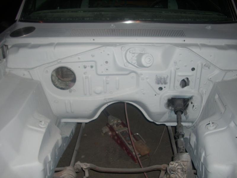

Well, after a lot of gnashing of teeth, measuring, re-cutting, and measuring again - and cutting and grinding again and again, it's IN IN!
Lots of casualties of war:
Engine mount will need to be cut off the (expensive) "K" Frame, Steering Box mount will need to be Bobbed, Brake Master Cylinder will have to go for a long walk, a completely bespoke Steering Column has been fabricated, and it is going to be a massacre of the Pass Side inner Fender and Shock Tower, but it is progress of sorts....
Hemi - Hemi Motorplate Fixed 1 - small.jpg (91.24 KiB) Viewed 8145 times

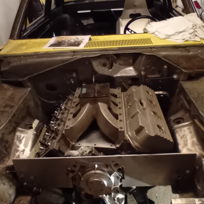

Posts: 22147
Re: Hemi into an "A" Body - How hard can it be???
/inner Fender....
Hemi - Motorplate Fixed 4 - small.jpg (96.5 KiB) Viewed 8145 times

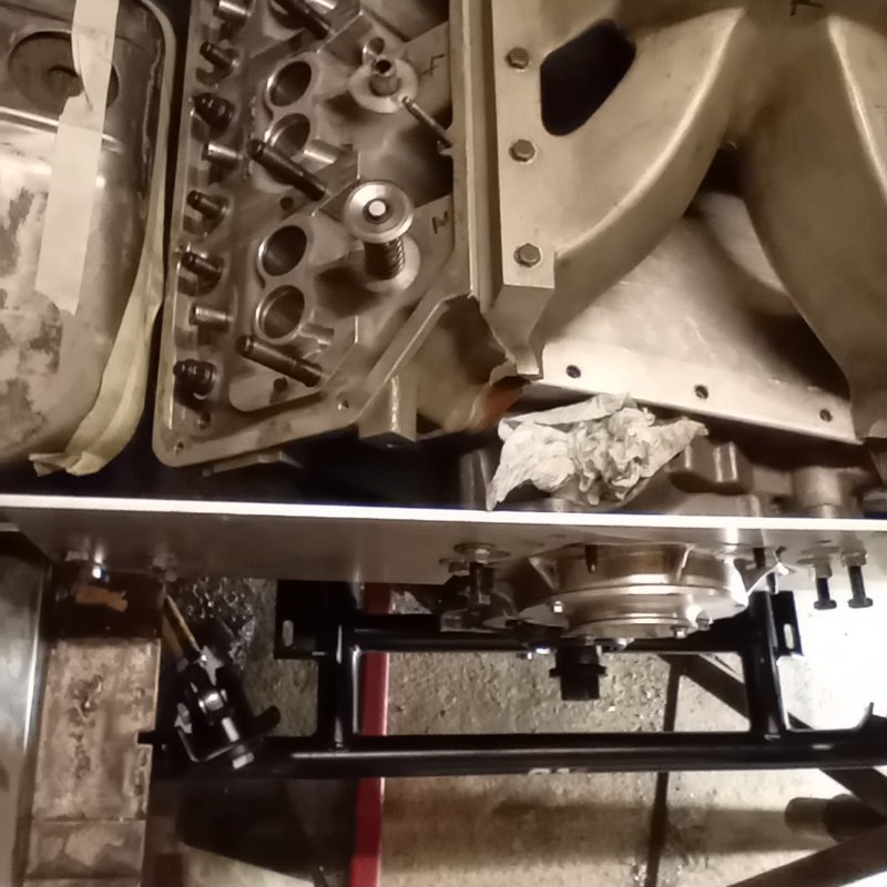

Posts: 22147
Driver's side Bulkhead...
Hemi - Motorplate Fixed 6 -small.jpg (80.98 KiB) Viewed 8144 times

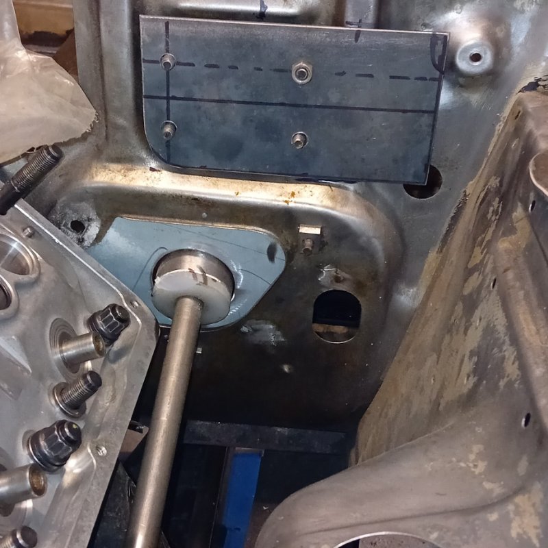

Posts: 22147
Where is the Master???
Hemi - Motorplate Fixed 8 - small.jpg (106.76 KiB) Viewed 8144 times

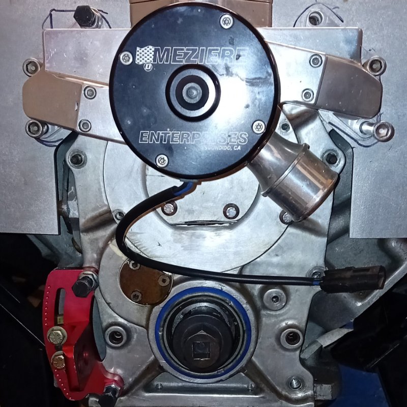

Posts: 22147

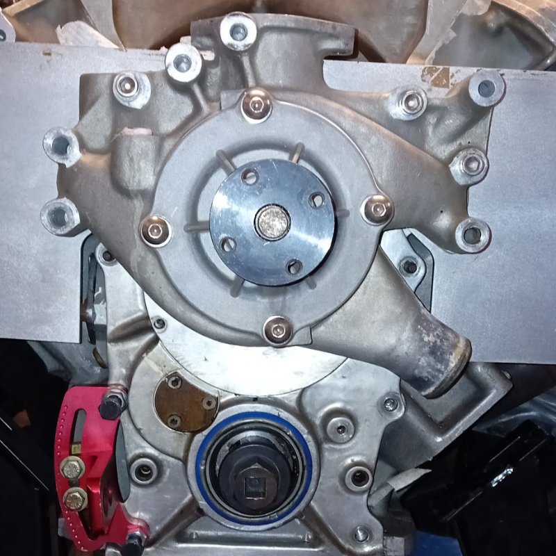

One Water Pump option....
Water pump option 1.jpg (135.89 KiB) Viewed 8144 times
