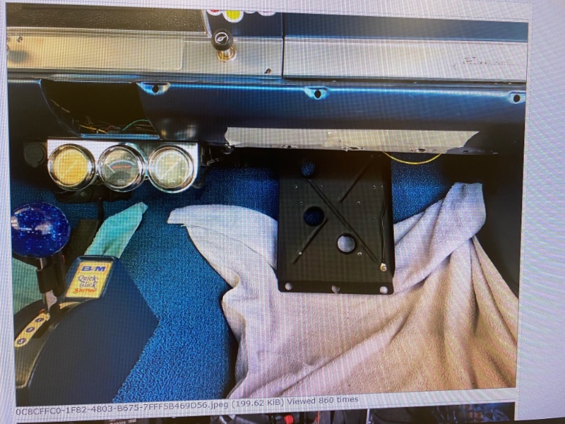

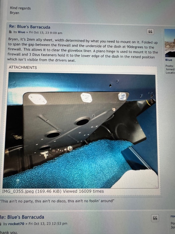

I like Blues inside hinged tray that he has under his dash and mounts all his electrical items on there.
Keeps it all out the heat and tidies the engine bay up.

Thanks Rocket...all of the work Blue does is on another 6 levels up from what I do. Always very impressive. As Im not too bothered about stuff being out of the way and super tidy in the engine bay, I will probably stick to relocating it to somewhere I can access easily if I need to. Thank you very much though for pointing out the option as per Blues car, appreciate it :thumbright:

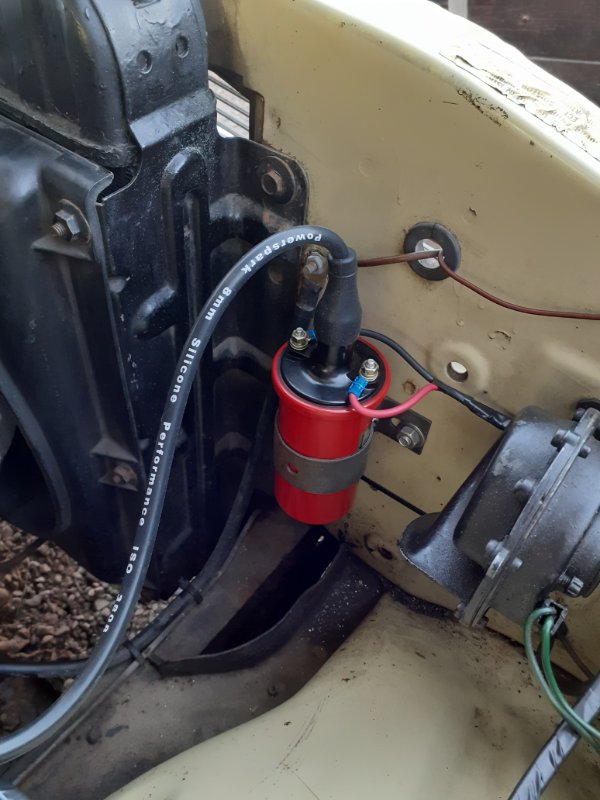

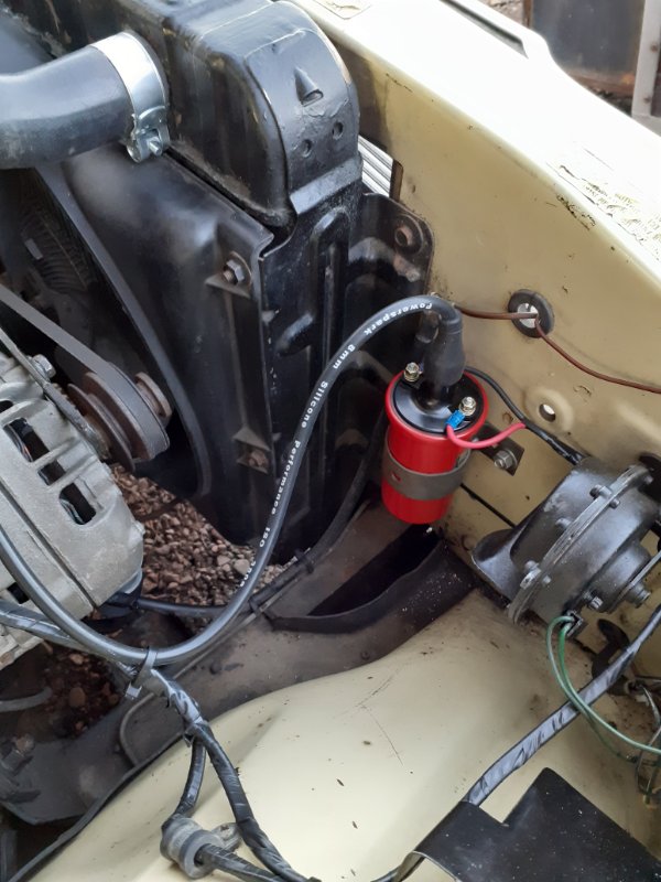

Thats the coil moved and, due to an oversight on my part, new coil HT lead arrived today. All seems fine on a run out. I ran out of heatshrink so will get some for the terminals on the leads. Will also tweek the routing of the HT lead, photo shows a quick fit to test the car on the road. Sorry, not sure why its sideways :banghead:
Used a company called Powerspark Ignition Ltd.
https://simonbbc.com/
Cant fault them. Phoned Monday morning, discussed my needs, they made a couple of leads up and posted, arrived today!!!!
Thank to everyone for their help :thumbright:

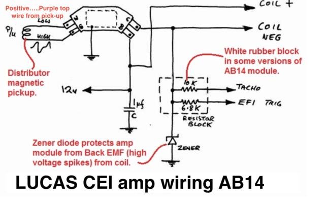

notice the way the little diode logo is on it and compare with circuit below...stud goes to earth an arrow bit points at solder contact
why?

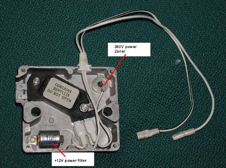

because it was part of the original specification given to Jaguar by motorola, when they came up with the CEI AB1 module for the XJS 6 and 12
an expensive aluminium box filled with magic fairy dust and an HEI module
the original transistor set in the GM hei module could not stand more than 350V back emf, i.e the recoil action from triggering a spark,
so they used a zener diode to sink/clamp/divert the proportion of that recoil voltage above 350V to earth protecting the module
modern HEI modules can cope with 450V, and in a standard application the diode is no longer used, We are not the standard application and there is nothing to stop a coil firing wide gap plugs into a high compression cylinder from kicking back 500-600 volts, and when it does that it damages the module and can throw your tacho into a wobble.
can't get a 350 reverse polarity zener diode anymore so a 400V is the best bet.
just bolt it into your bracket and run a wire from the contact to the coil negative
can apply this to a mopar set up as well.....
doesn't impact coil "filling" think of it as garbage collection after spark has fired the cylinder.....
with no AM radio and No CB you don't need the capacitor shown anymore

One of these costs £200-£400 off a jag specialists  and look whats is inside   £40 of kit.   what a con......
zener diode AB1.JPG (103.29 KiB) Viewed 13094 times
Lucas CEI amp wiring (1).jpg (36.3 KiB) Viewed 13094 times
