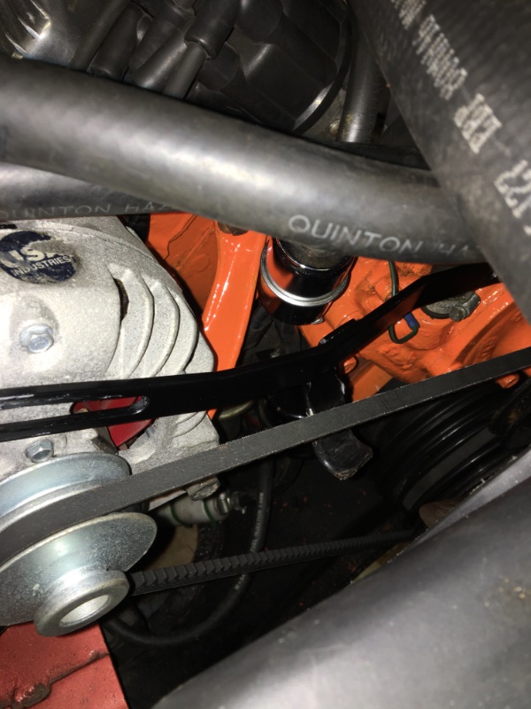

Derek - i expect it's a bit tight for space if you have a separator and a filter between the pump and carb? Can you get some pics to show how you've arranged things? Does your return line point up or down? (or is it level?)

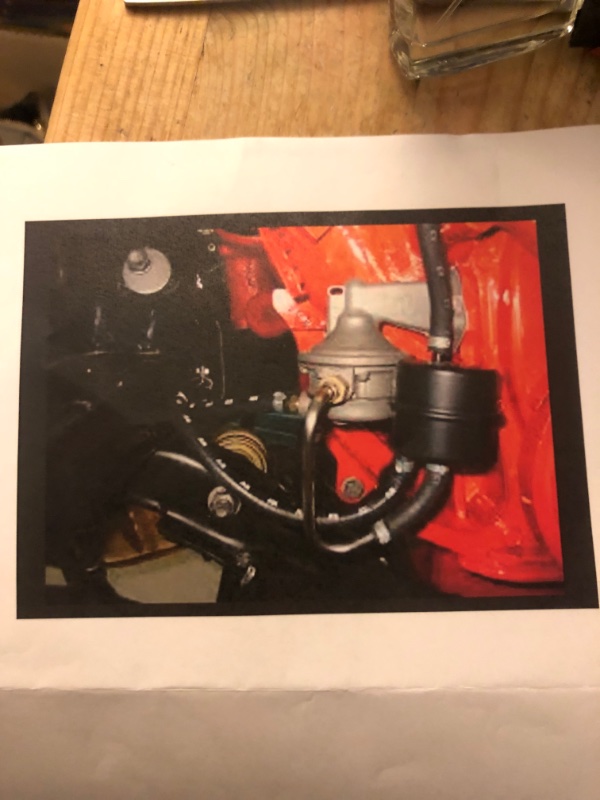

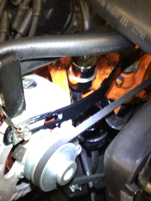

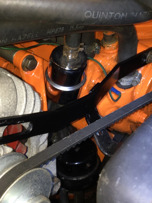

Hey Stu. Best I can do for now, more than enough room but my alternator is probably in a slightly different place to yours being an air con car, return comes out the bottom of separator which bolts on to manual pump. All the pics are sideways for some reason.

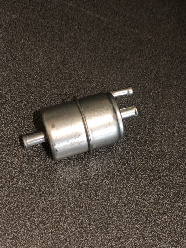

So I’m moving the Wix 33041 filter with return line to after the mechanical pump. And before I figure out the best way to mount it I thought it would be best to make sure I fit it the right way round. Photo below.
As it’s been on the car a while, whatever printed arrow has disappeared so I can’t be sure. I’ve done plenty of Googling but as this specific part seems to be discontinued there’s very little info on it.
When it was fitted, pre pump, next to the chassis rail, it had the return line pointing back towards the tank. So inlet was at the same end as the return. But everything I’ve found since contradicts that. Which is strange as I presume it still had an arrow when fitted.

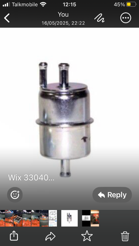

I’ve found an image of a Wix 33040 (same except for smaller inlet) which clearly shows a direction arrow, and a also an Uncle Tony video on YT showing a similar filter installed. He has it with the return on the outfeed end.
And I read that the return should be uppermost.
Anyone used one of these? Or know a way to test which is the inlet? Airflow seems similar which ever end I blow into.
More confusing is that the factory style ‘evaporator’ fitted after the mech pump clearly has the return line pointing down and back to the tank.
https://m.youtube.com/watch?v=-t6geNGbE ... Y3VyZXM%3D

I think the way you had the return style filter on the suction side of the pump was a big part of that particular incident. I can imagine the pump drawing air down the return line rather than fuel down the main line.
