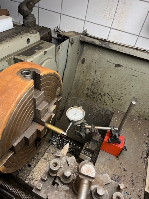

First step to trial-fitting the gearbox , dial in the bellhousing . Ideally the gearbox input shaft needs to align with the crankshaft within 5 thou or so. Aftermarket bellhousings can sometimes be out of tolerance, and also if a block has been line bored this can have an effect. So any offset needs to be measured and corrected.

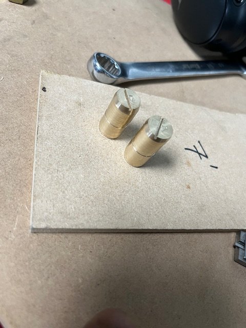

First step - fit bellhousing with straight dowel pins and take readings
The Mopar block accepts a .496" dowel pin, however the locating holes in the bellhousing accept a .500" pin, so first step was to make some stepped dowel pins to suit .
then use them to mount the bellhousing, and measure runout.
The bellhousing needed to move around 8 thou towards the 5 O'Clock direction
Made up some offset pins .
Managed to insert them into the block with the offset going the wrong way. Stupid Boy . Took them out again and put them in properly.
Installed and measured the measured the bellhousing again , ended up about one thou off centre so all good.

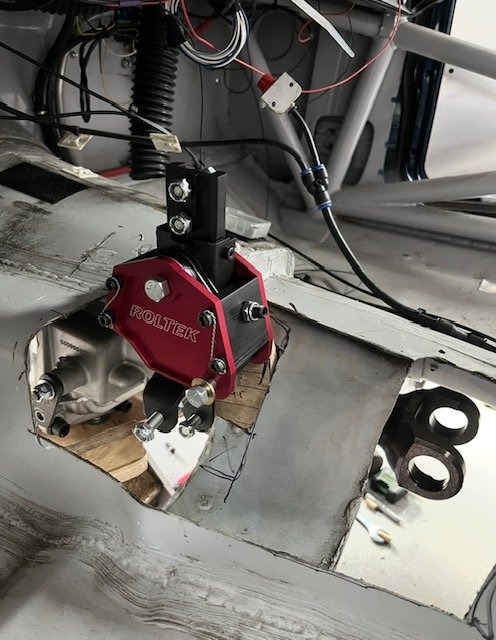

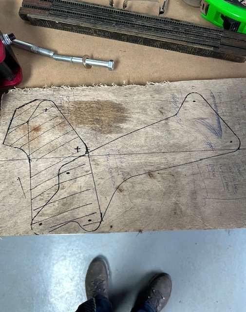

I had ordered the new gearbox with the shifter location offset rearwards, in the hope that I could use the existing 4-speed hump.
Turns out that the shifter bracket and rods will foul the torsion bar crossmember. This was always likely to a certain extent . I was hoping any mods needed would be minor, however the crossmember is right in the way of everything.
The solution looks to be to move the shifter forwards about 8.5" so that it will fall just in front of the crossmember.
Had to establish a 'horizontal' line to move the shifter position along, so as not to throw out the shift rod geometry too much . Drew and cut a test bracket out of plywood.
Installed in the car - looks about right. I had to cut part of the front flange off the cross member but I'll reinforce this part later on

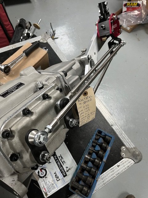

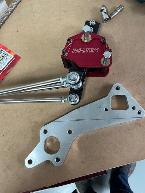

The shifter will also need to be offset about 14mm to the left to maintain the existing rod angles once it's moved forwards.
so I made some wider spacers to mount to the extension housing

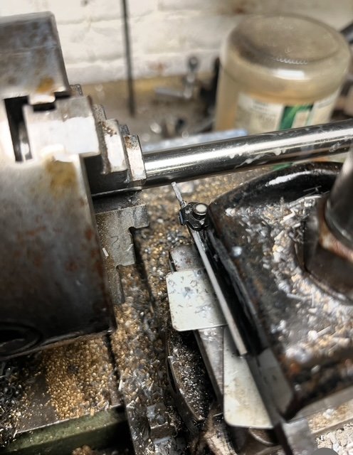

Shortening the shift rods .
They're stainless and threaded internally both ends . LH one end, RH the other .
As a complete amateur, I don't much enjoy machining stainless. It gets very hot very quickly. Slow speeds and high feed rates seem to work.
Parting off the ends. Had to resharpen the tool a few times
and tapping by hand . Again , lots of coolant and work quickly . Still gets very hot though.

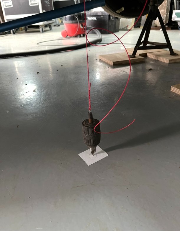

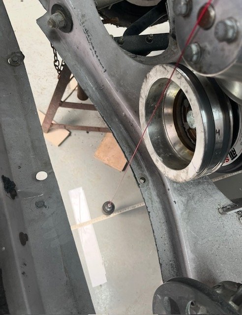

First of all, need to make sure the engine/box line up at right angles to the rear axle when viewed from above. Drop plumb lines to the floor from the axle, and then extend a perpendicular forwards. Measure existing position at crank nose and at tailshaft for reference.

Now that I've got some sort of datum I can pull the engine out again . Using the 'long reach' crane.
and can cut the factory mounts off the K-member . also make some room under the crank pulley so I can lower the front of the engine
Then get the engine back in , suspended from above so that I can move it around

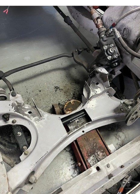

Post by Matt »
Bought a couple of universal mounts from Summit . Very substantial .
Cut them up a bit and tacked the 'bush' part to existing engine brackets
LH Mockup.jpg (60.99 KiB) Viewed 33732 times
both tacked.jpg (60.56 KiB) Viewed 33732 times
added some brackets to bolt to the K-member
LH finished.jpg (70.96 KiB) Viewed 33732 times
RH finished.jpg (112.56 KiB) Viewed 33732 times
Matt
Posts: 1039
Post by Matt »
then made up some pedestals on the K-member to suit .
