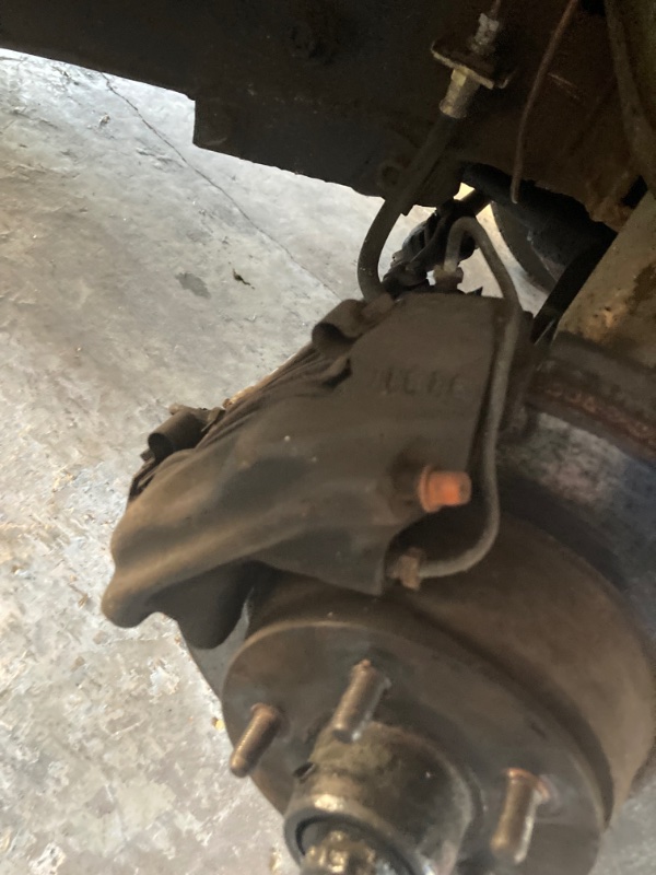

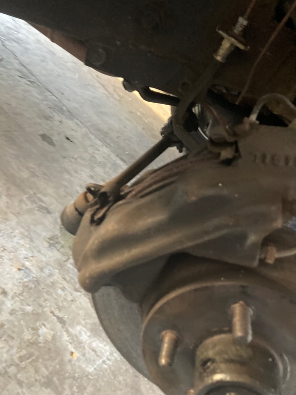

I have been doing a few bits and pieces on the Barracuda, but I think it's time to find a good mechanic near me to sort out a few things beyond my limited skills, the main one being the last drive the brake pedal travel started to go long and lose stopping power, luckily it was close to home and on a slow road so no pants change needed, but that sort of problem is way out of my comfort zone.

Your car should have Kelsey Hayes 4 pot brakes, as it’s a UK spec model.
I stand to be corrected, so don’t quote me, but I believe early e types used Kelsey Hayes.
Worth checking, as that would put your Jag man squarely in the frame if you can’t find someone Mopar specific locally.

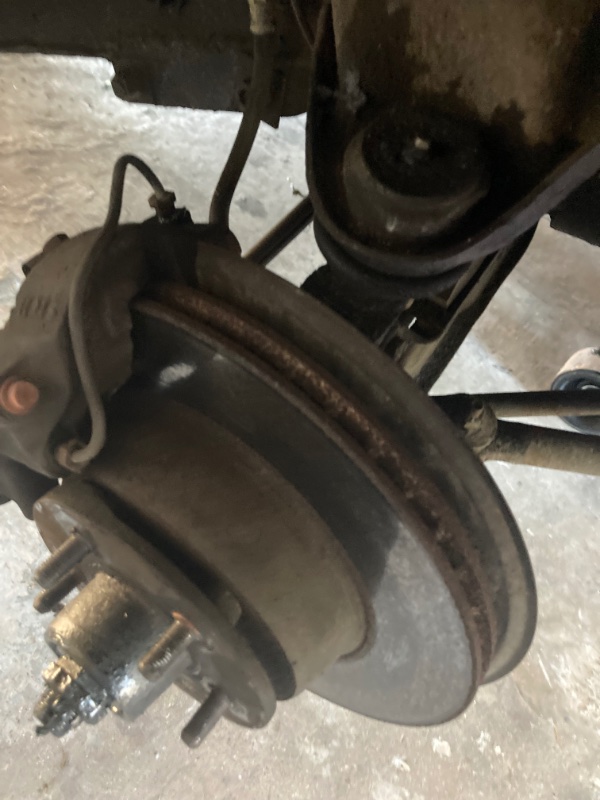

That’s interesting, I hadn’t considered that, is there any way to tell visually, the only identification I could find is a number 71915.

those are fixed calipers i.e they don't look like like girling or lockheed single pot sliders associated with lesser or later models...I've have told you what they aren't, apologies

Thanks Dave I posted these pics on the FABO boards and the consensus was that they are KH brakes. I’ve ordered a pair of “Greenstuff” pads from EBC as I’ve heard good things from people who’ve used them in other classics. I’ll check them when they turn up.
I’ve also ordered some Dynamic Friction shoes for the drums.
I think what may at least partly have caused the fade is the r/h drum has been dragging, when I checked the car after I parked up, the wheel was too hot to touch, I had to fully release the park brake to get the drum off and the rears wouldn’t turn by hand. Anyway the adjuster arm had bent and was sitting on the inner side of the star wheel and the front shoe was down to about 2mm.

I can’t help with the numbers, I’m afraid, but yes those are KH.Matthew Saxon wrote: Mon Apr 07, 25 9:19 pm That’s interesting, I hadn’t considered that, is there any way to tell visually, the only identification I could find is a number 71915.

Thanks Stu, it hadn’t occurred to me until you said it. The pads for the KH brakes are the same as the standard 4 piston brakes though aren’t they?
