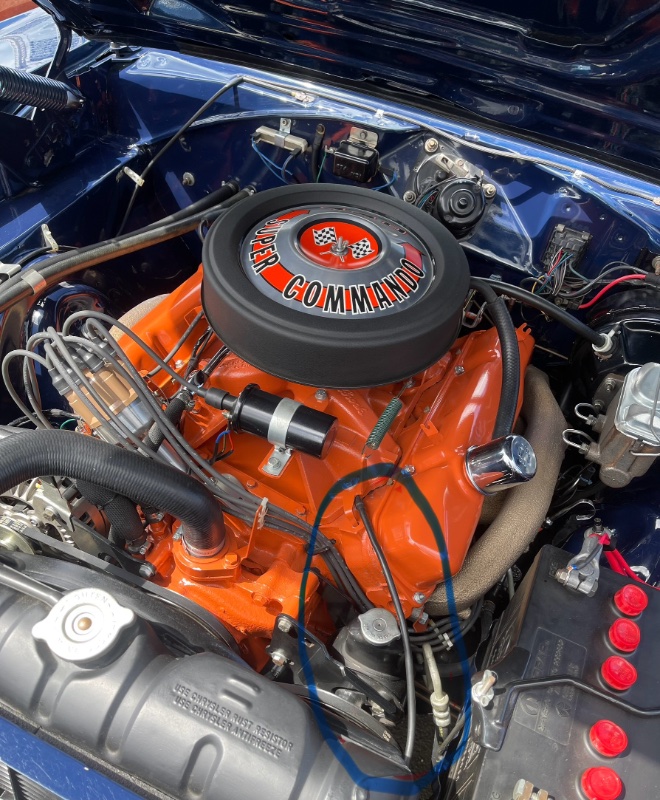

I was just looking at a photo I took of your engine on Sunday …. Can you tell me what cable/wire/hose is that I’ve highlighted in the picture, it appears to go into the inlet manifold.

rocket70 wrote: Tue May 28, 24 8:00 pm I was just looking at a photo I took of your engine on Sunday …. Can you tell me what cable/wire/hose is that I’ve highlighted in the picture, it appears to go into the inlet manifold.
It's the negative battery cable, bolted to the inlet manifold under the throttle return spring bracket :D

Thank you and I did think it could be that but the angle of the picture made it look odd.
