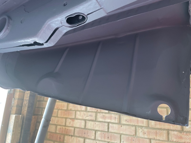

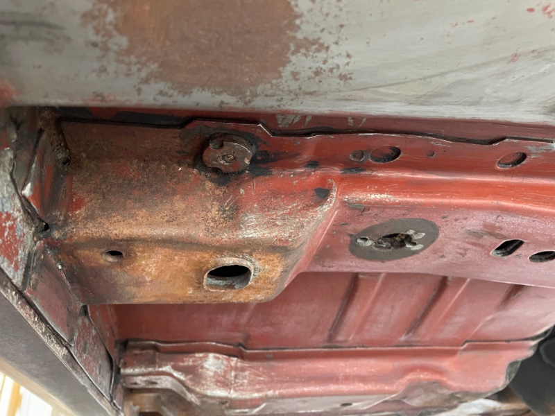

Yep used Raptor several times , extremely nice finish when fully cured,
However the tinted version looks rubbish,
The original underneath would have been Red oxide,
And maybe some anti stone chip in the wheel houses,
If I could get the Novol 360 in Oxide I’d definitely use it,
But seemingly only available in grey?
But it’s far to complicated to use a coating in unfamiliar with!
I’m not bothered about “originality “ I use my cars all year round so I’ll probably just go Raptor,
Protection over show boating every time!

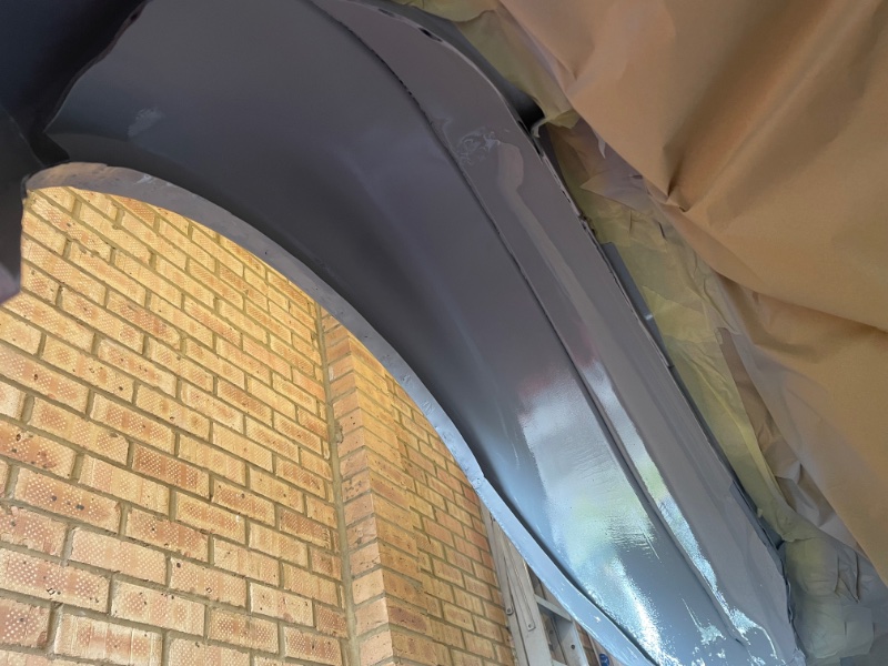

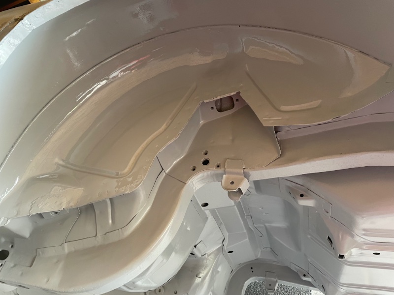

Finally finished the underside!
Left wheel house and rear drop off completed and in epoxy
Thank goodness!
12 weeks I’ve been under the Turd , losing the will to live!

I appreciate it’s a long time, but the results show it was worth it…newsatten wrote: Sat Jun 07, 25 6:14 pm 12 weeks I’ve been under the Turd , losing the will to live!
At least now you get to enjoy working topside for a while
Re: My very last restoration!!!
You will quickly forget the time and effort as its such a good job! If you had rushed and cut corners you would forever be reminded of why you should have put more time and effort in
It all looks perfect and very, very well done....a credit to your professionalism and skill. I cant wait to see her done and thanks for keeping the pics and updates coming

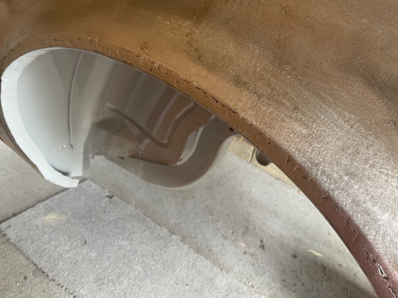

Decided to lip the arch , generally the quarters are solid and sound, however the was a few tiny pits and it’s virtually impossible to judge how far the corrosion has penetrated the steel, so belt and brace approach necessitated a new edge and arch lip,
This needs to be as filler free as possible so if the arch is scanned it will just show a paint/ primer thickness,
However polyester is part and parcel as far as body refinishing goes and some filler will always be required,

There’s also another reason for doing my arches
As I’ll be able to either roll them or just cut them down which will give me a tad more flexibility with rear tyre width
Past experience has shown me tyres often clear when just two up and rub when carrying two in the back
So want to avoid this if possible!
