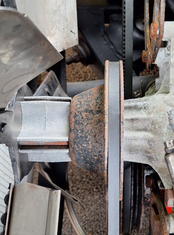

Hi all, my small block used to be an AirCon car which has long gone. So I'm looking for the correct waterpump pulley for non AC.
What I have works but it's not the best arrangement and I'd like to improve on it.
Cheers Dave

Posts: 22136
Re: Waterpump pulley
ScottyDave wrote: Wed Jun 18, 25 3:48 pm Hi Neil, waterpump is currently driving the power steering atm. Cheers for the input though I never knew that :thumbright:
Cheers Dave

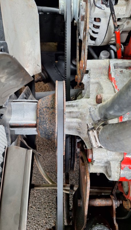

Without more pictures I could be wrong, but I feel that it is not the Pulley that is wrong, it is the mounting Bracketry / Idler Arm arrangement that is incorrect.
Can you put up a wider picture of the installation, I think the Water Pump should not be on the same belt as the PAS Pump, only with the Crank Pulley and the Alternator. The PAS Belt is a separate (and heavier Belt) arrangement.
Cheers,
Posts: 1676
Yes Pete, your correct in your assumption. My car was originally AC and I think it would've been,
Crank, Alternator, AC? & Crank, Pump, PS but I honestly have no idea :dontknow:
This has always been the setup its had from when I got it but, I feel it should be Crank, Alternator, Pump.
Again I don't know :dontknow:
It has however always been reliable and never gets hot.
Cheers for any input.

Pete wrote: Wed Jun 18, 25 4:08 pm
Cheers Dave
Cheers,
agreed, all the small blocks i've ever had with power steering had that pump driven direct from the crank'.
