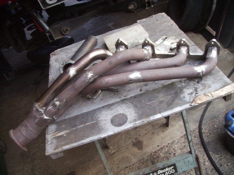

that's one side made. we cut the centre pipe of the joined 3 free so we could fully weld round them all then with as much ground neat as possible we final welded them together as a set of 4. we used the mild steel collector as it's longer giving room for a 2.5" outlet to the exhaust system. we'll cut some blanking plates for the bottom of the outlets that ash' can remove at the track (or all the time, lol).

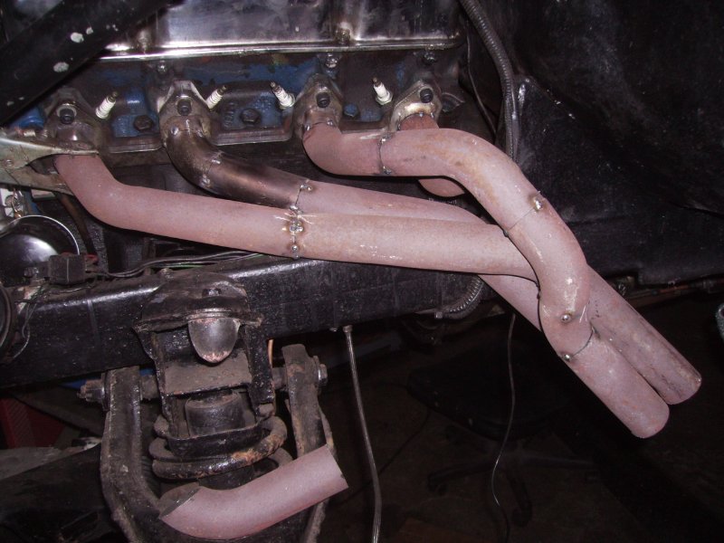

that was a good day, we got probably 3/4 of the n/s header tacked together.

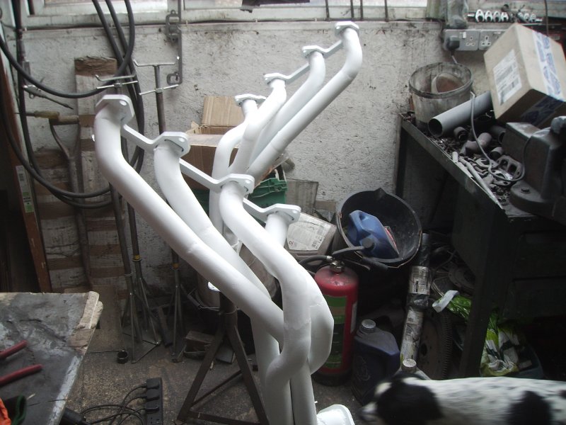

we got the last pipe sections tacked in place and removed the header to be fully welded. as with the other one we removed two pipes at the flange so we could weld all round them and have decent access to do the same on the other two. we then ground the welds and refitted the last two tubes. lastly before a second mock up was to add the collector. then we fitted it back onto the engine so the side exit running to the exhaust system could be made up again using the flanges from the last setup. that's now tacked in place ready to come off 'again' to be fully welded and painted. oh, the white vht paint arrived today so we should be able to get them both painted and baked tomorrow. i hang the headers collector down and jam my heat gun in there so the pipes get preheated before applying the paint. it seems to give a longer lasting finish, i've not had any flaky paint since doing them this way.

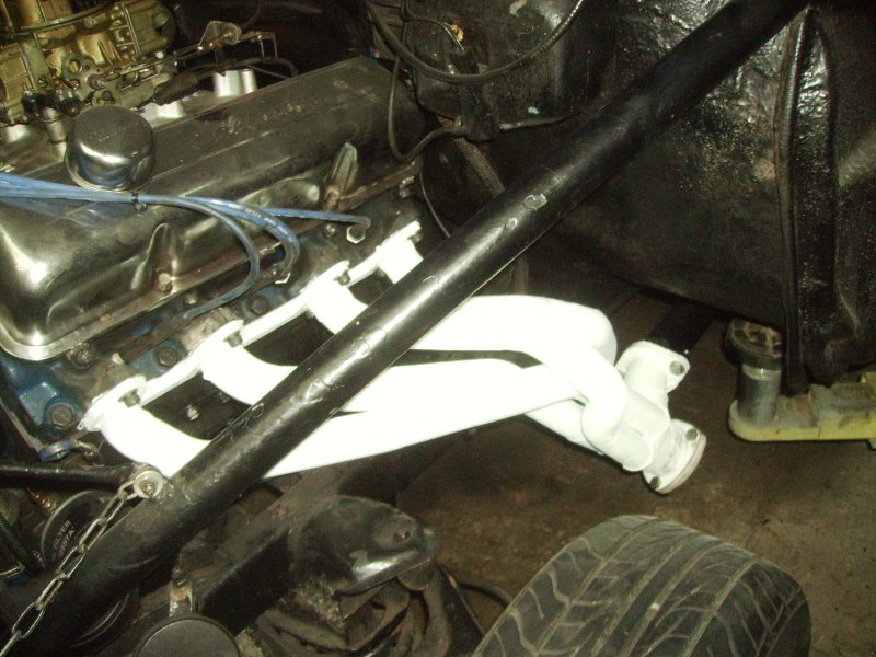

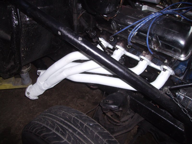

that's them both done then. next job's fitting them with clean gloves on, lol.

all ready for the fire up later on. :thumbright:
