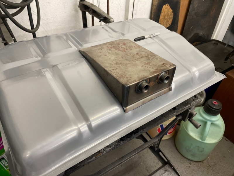

Re: Blue's Barracuda
New tank is here and the sump has trimmed up nicely for a good fit. Tank needs bolting into the car next so I can mark where the fuel pump mount needs to go, position is critical so I can’t risk just measuring it.

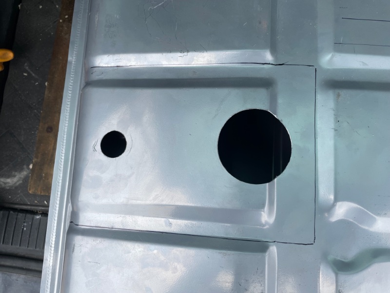

while you have a big hole in the bottom of the tank will you add any baffles either side of the new fuel 'well' to help keep fuel there all the time?
Posts: 14523
Rather than cut out the whole area I’ll just cut a couple of large holes in the bottom, that will act as baffle.
Tank cut and fuel pump mount location finalised.

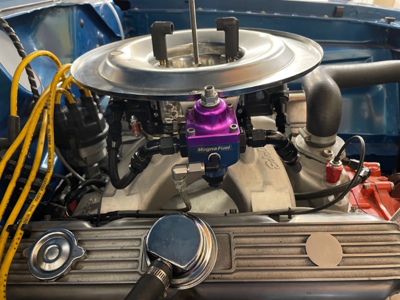

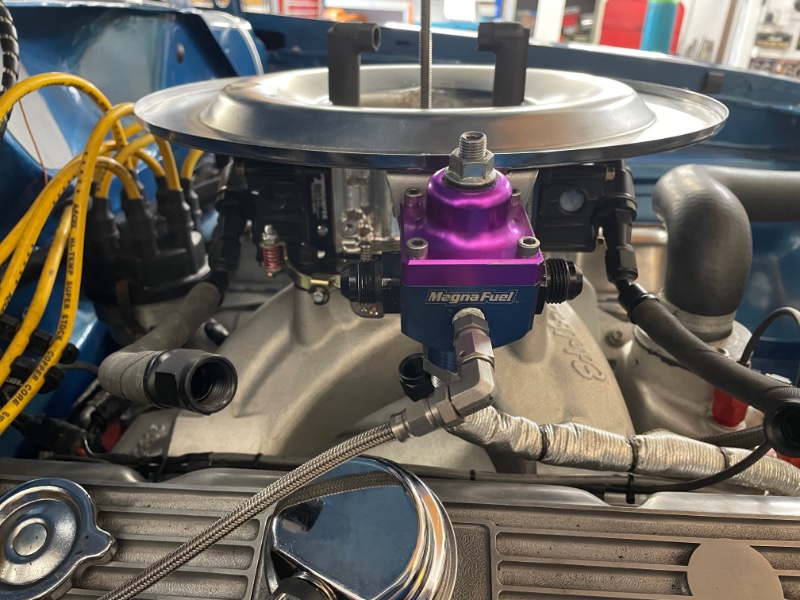

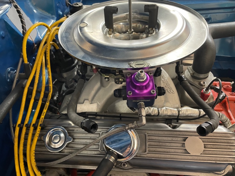

Up at the sharp end is a large port mangnafuel billet regulator. A bit overkill for my application but I used the usual Hot Rodder’s reasoning for correct parts selection, “it was cheap and available” so it’s all good.

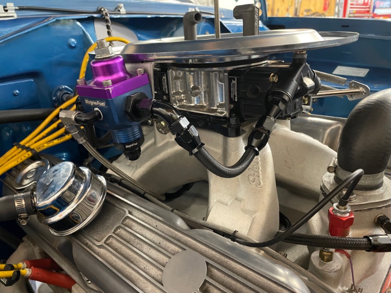

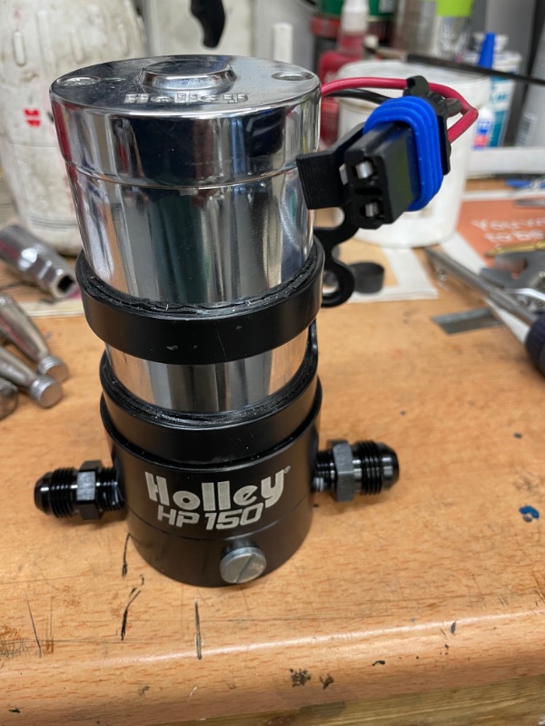

Bit of progress, correct size fittings in the pump and weatherproof connectors fitted, ready to install. Smaller fittings fitted to the regulator and new feed lines made. Can’t do anything else now until the tank goes in.
Posts: 3642
The Red, Yellow and Blue are working there, not sure about the Purple though...
Posts: 14523
Yea if I’d had a choice purple wouldn’t have been it…

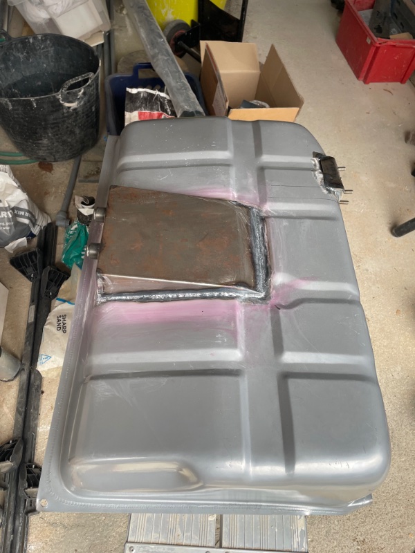

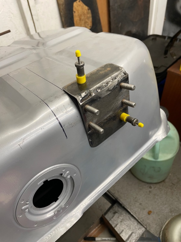

Posts: 14523
Paid a visit to Grace at Brooklands Today and had my sump and fuel pump mount tigged to my tank. Glad I didn’t try to MIG it myself, it didn’t weld easily due to the galvanising on the inside.

Blue wrote: Thu Aug 28, 25 4:42 pm Yea if I’d had a choice purple wouldn’t have been it…
it's nothing some careful masking and a can of satin black wouldn't fix though. with the black fittings the top half to match would look fine.
