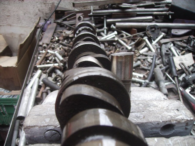

ok, that's it stripped ready for a cleanup now......again
- IMG_0001 (136).JPG (95.43 KiB) Viewed 30182 times
- IMG_0002 (89).JPG (108.95 KiB) Viewed 30182 times

sure is. first time just one but this time it was 3 different cylinders and 5 lifters/lobes that are hardly showing any lift at the valve.

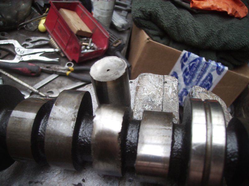

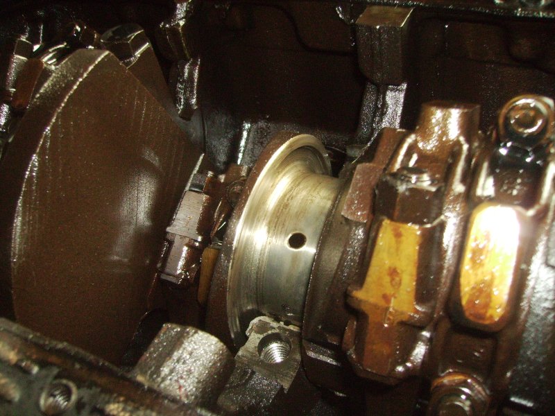

yesterday we got my fe engine up on the engine stand and turned over to open up the bottom and investigate the crankshaft's excessive end float. well the engine must've come from a manual galaxie i reckon as the thrust part of the main bearing has worn into the crank' almost 1/8"! so although i could weld and turn it flush now i have my bigger lathe, with 2 other engines here we'll just sw2ap in another crank' with new bearings and call it good. we'll still swap the new roller timing set and h/v oil pump from ashley's engine but other than that it'll remain stock. here's a pic of the crankshaft carnage
