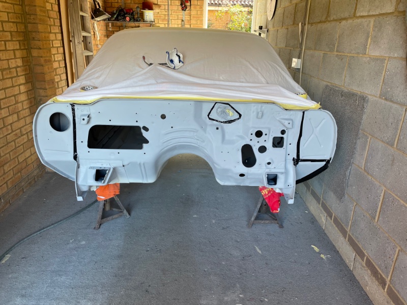

newsatten wrote: Sat Aug 30, 25 5:38 pm Squared up the left door, sill and B post yesterday and today
Probably one more blocking session before the last primer coats,

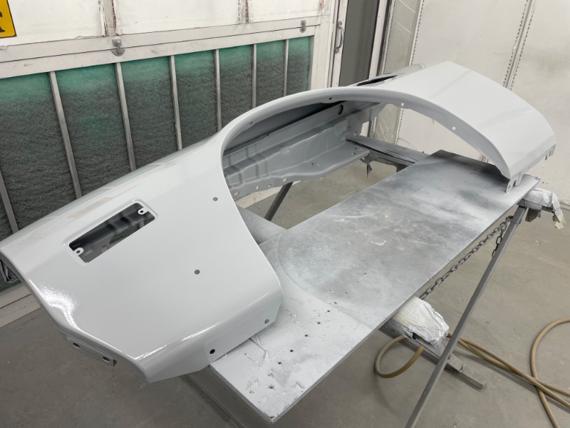

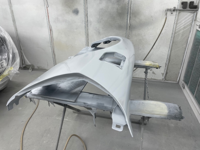

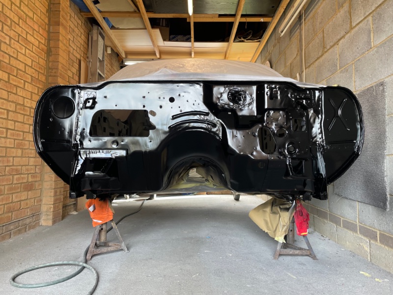

Started preparing the front quarters and got one in epoxy
And almost fully de rusted the third member, yet another horrible job and a fight for every single square inch!

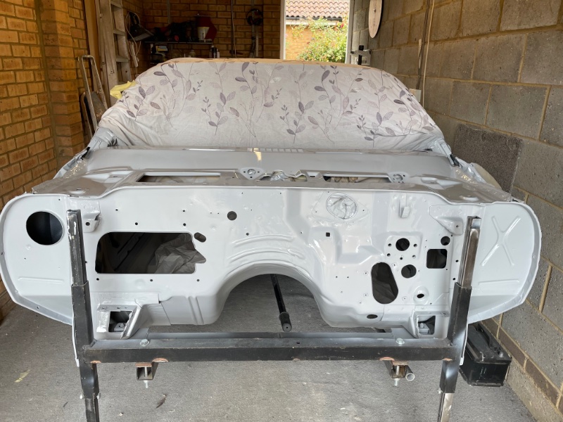

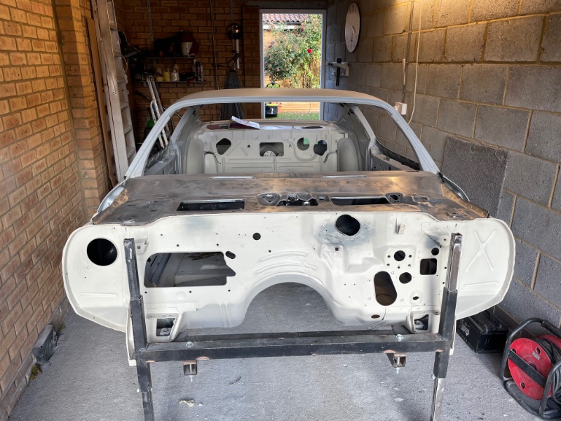

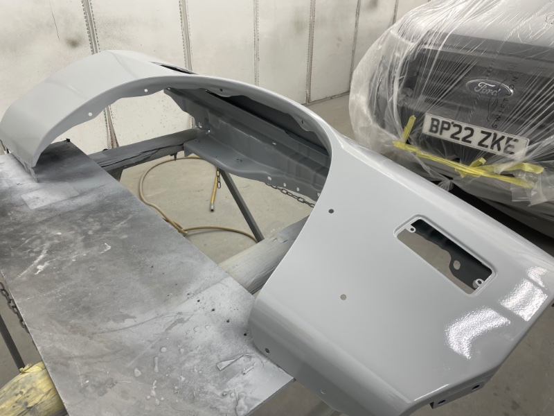

Got the upper cowl all welded in and in epoxy
So as far as metal cleaning, welding etc the shells ready for blocking and painting

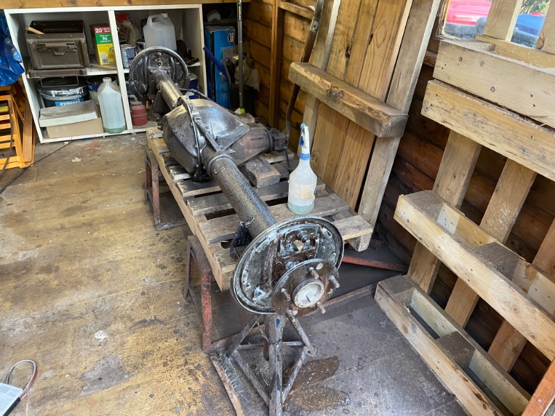

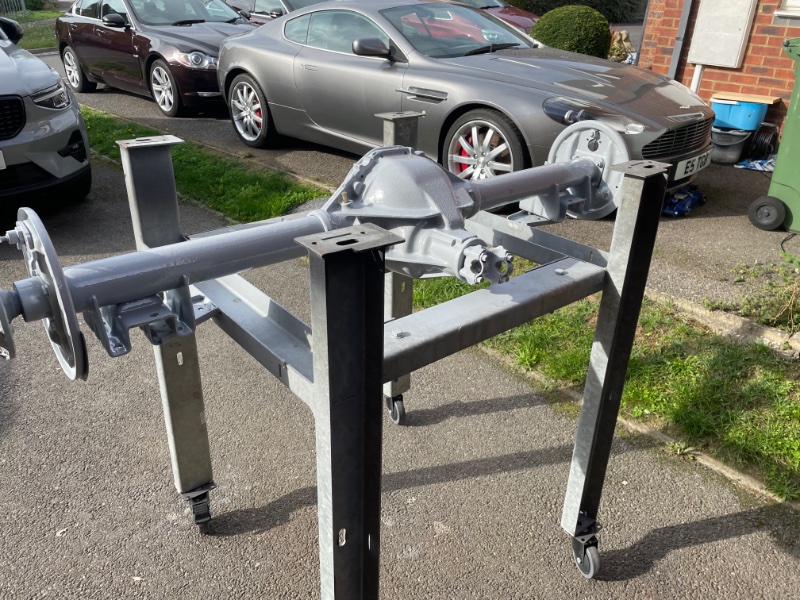

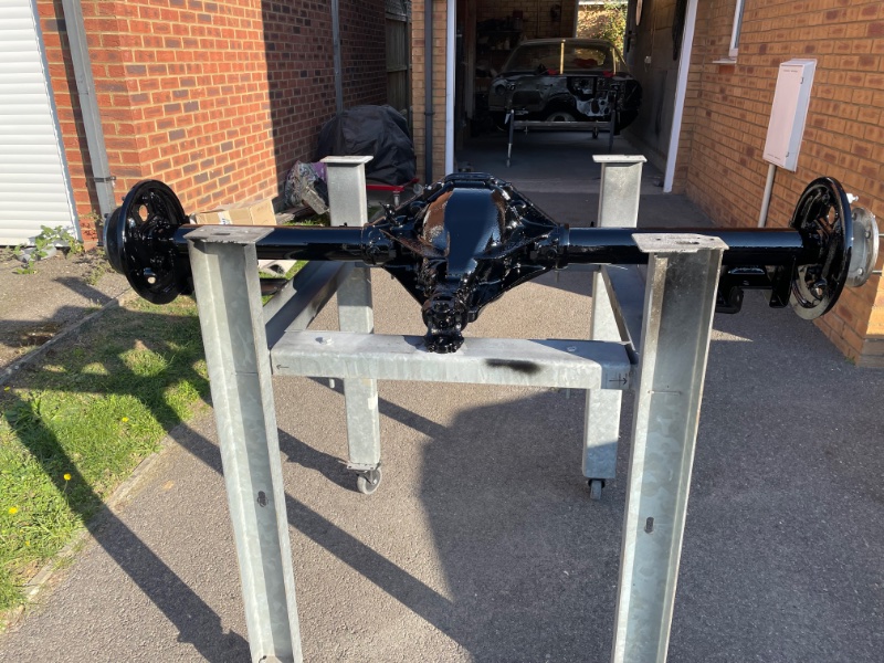

Managed to get my axle fully de rusted and in Epoxy
Posts: 7613
Re: My very last restoration!!!
Looks great. What a 'satisfying transformation' as they say! :thumbright:

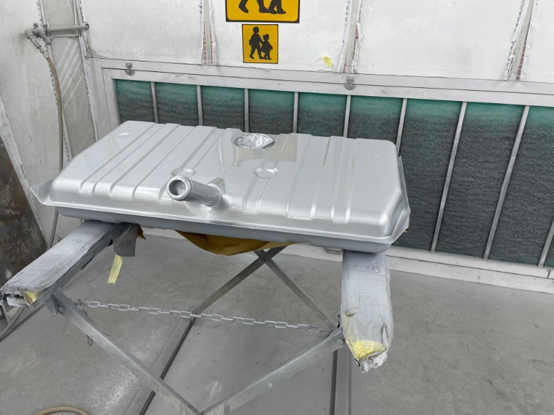

And almost finished the fuel tank at work so still moving forward!

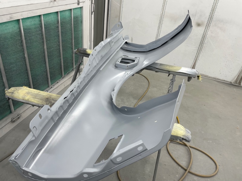

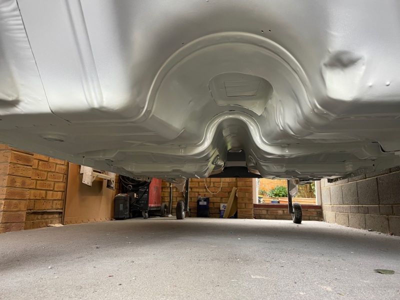

I flatted the underside, re epoxied and then coloured wet on wet , left it overnight and then flatted , PU’d the seams then on with the flat black on the bulkhead,
Also got the axle in clear over base black

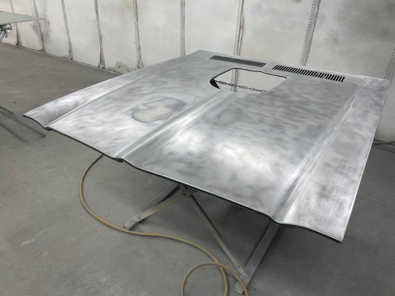

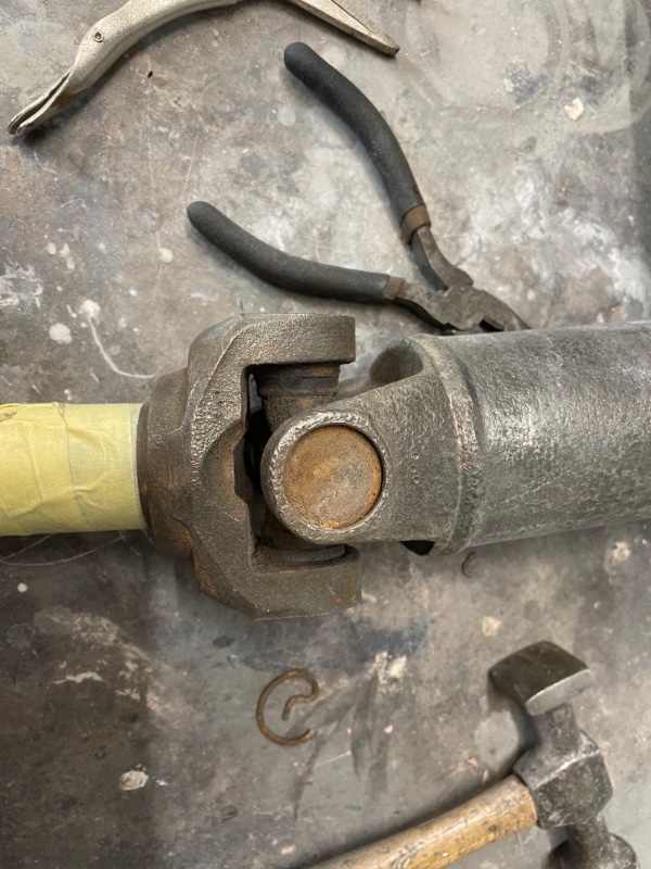

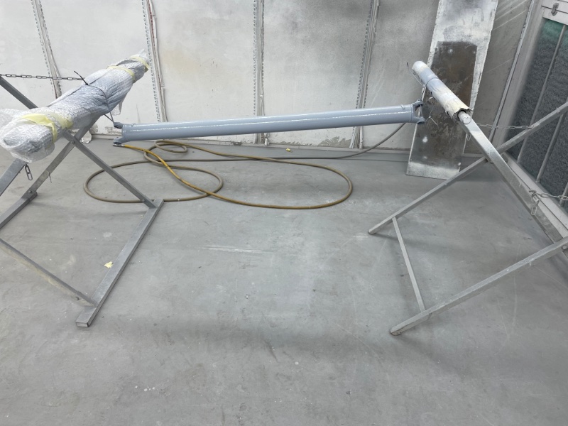

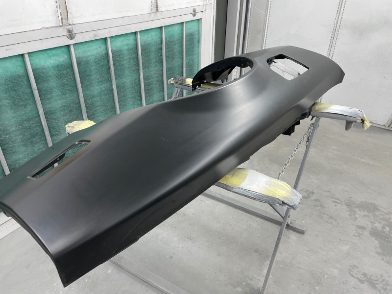

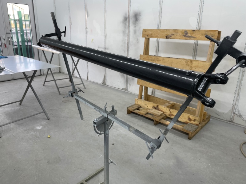

But more done this week , prop shaft all done and getting the Bonnet ready for epoxy

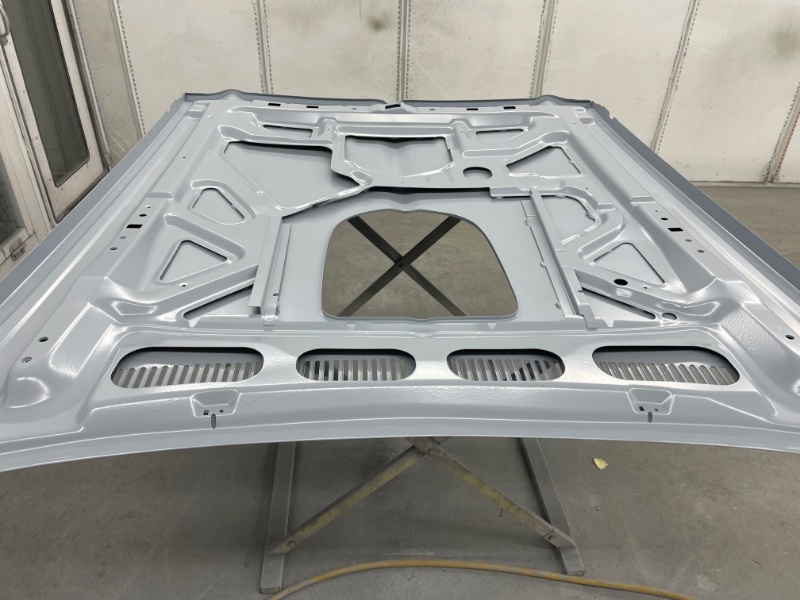

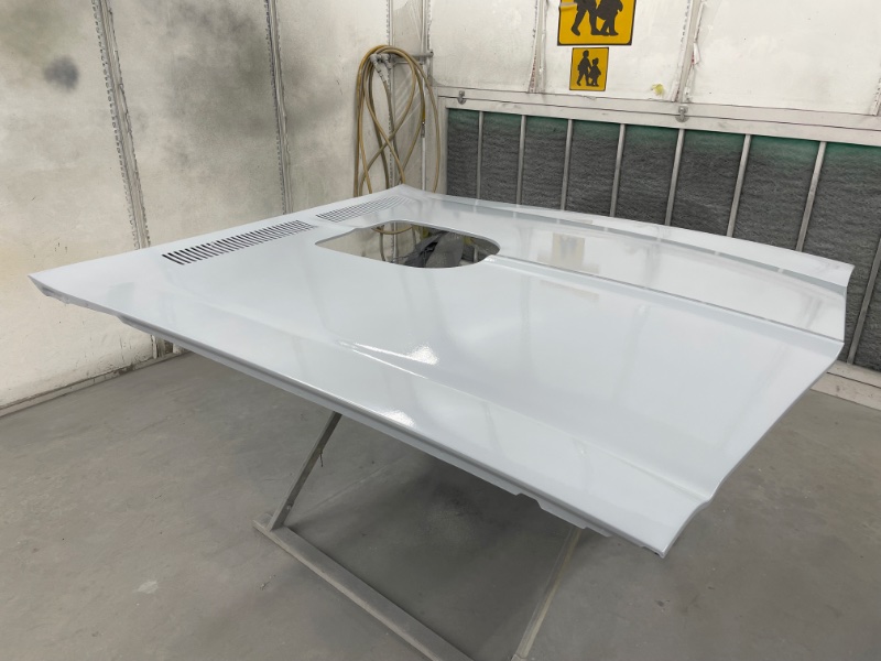

Post by newsatten »
Hood now in epoxy , just the rear section of the underside to colour and I can start reassembly!
Just in time for the winter, but at least doing spanner work it’s easier to get some localised heat and make it my comfortable to do!
