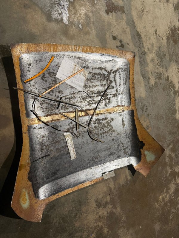

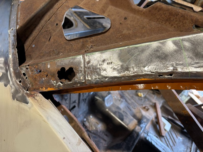

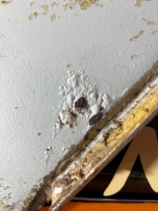

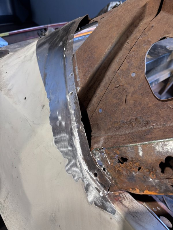

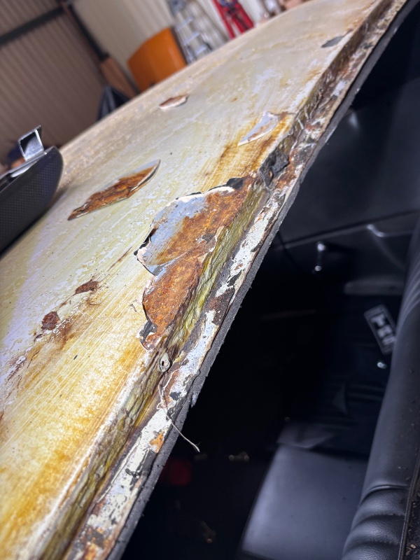

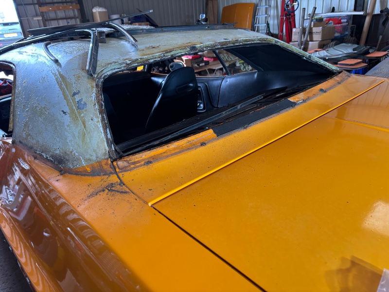

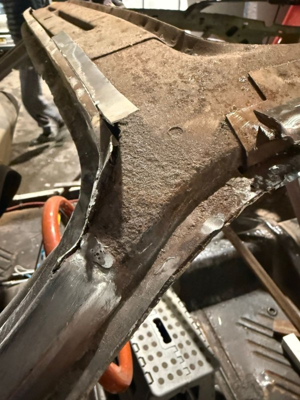

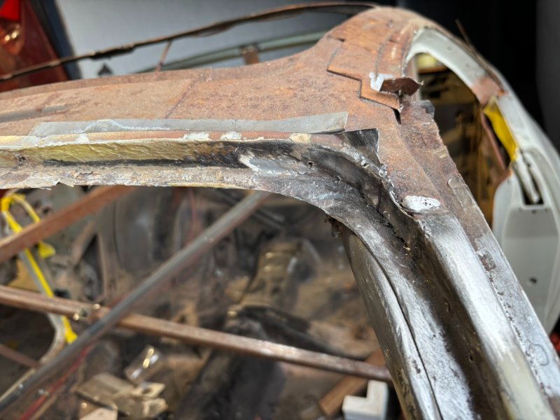

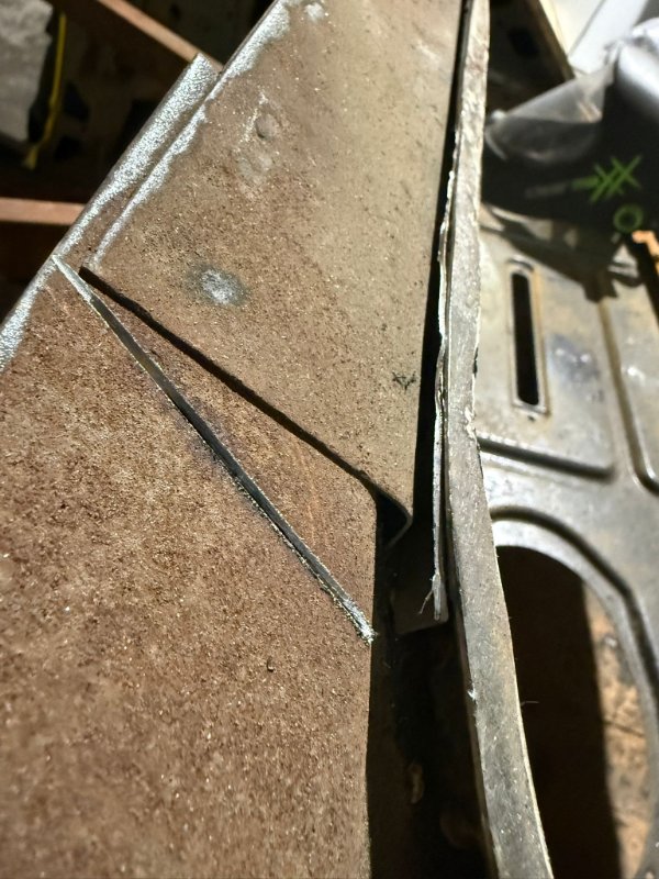

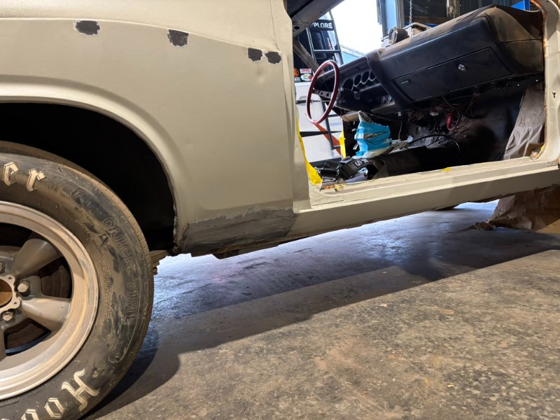

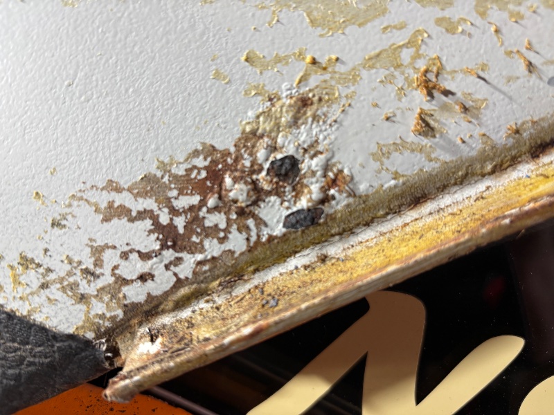

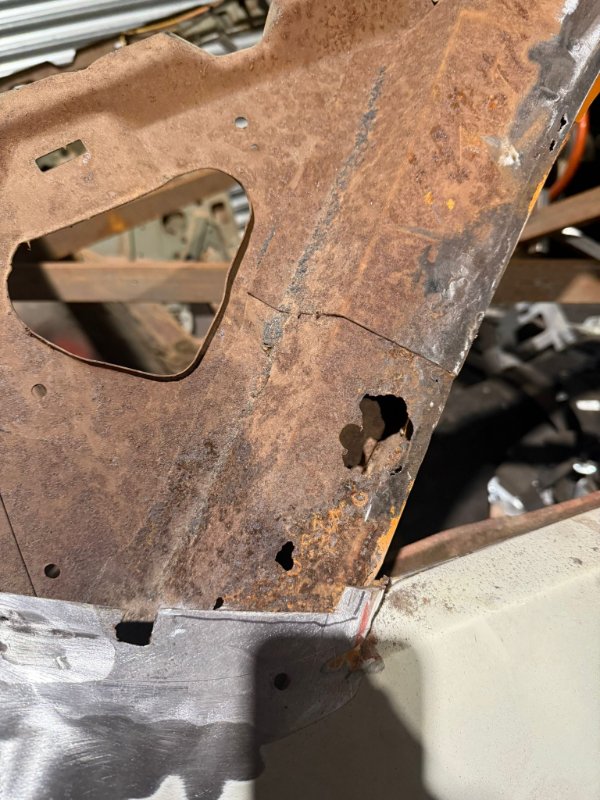

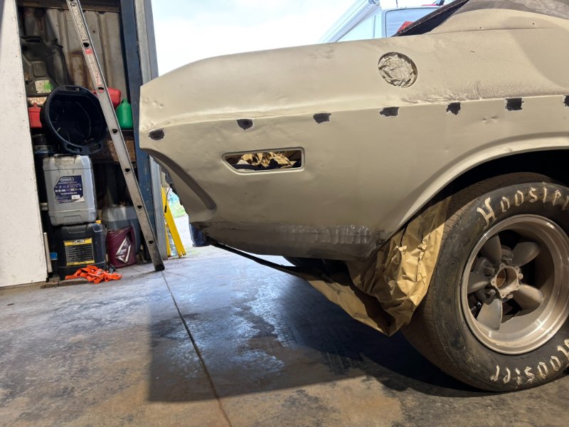

I should probably update, as there has been a lot going on.
The short version is, the roof was not in good condition at all, despite looking like it wasn't too bad.
Never seen bodgery like it. It had not only had a replacement wonky centre section badly welded in, but the welding was complimented by what looked like a mix of filler and sealant, before being brush painted over from inside and sprayed over from outside. Further enhanced by strips of untreated steel being hammed into gaps and sealed in to bolster it, it was an absolute disaster.
After very little thinking at all, it was decided that I will have to park the new engine build and do this properly instead, so finished stripping it, had it epoxy primered and pushed it round the corner to a proper welder to start patching what we already knew about whilst I emptied my wallet for a new roof skin...
Some random pics of the early patching taking shape and a sample of the multi-patch grot that was cut out of one of the rear quarters...
1. Early patch repairs.JPEG (42.28 KiB) Viewed 10784 times
2. Early patch repairs.JPEG (104.4 KiB) Viewed 10784 times
3. Early patch repairs.JPEG (114.48 KiB) Viewed 10784 times
4. Early patch repairs.JPEG (101.42 KiB) Viewed 10784 times
5. Early patch repairs.JPEG (109.23 KiB) Viewed 10784 times
6. Early trunk repairs.JPEG (94.73 KiB) Viewed 10784 times
7. Patches on patches and rot removed.JPEG (94.02 KiB) Viewed 10784 times

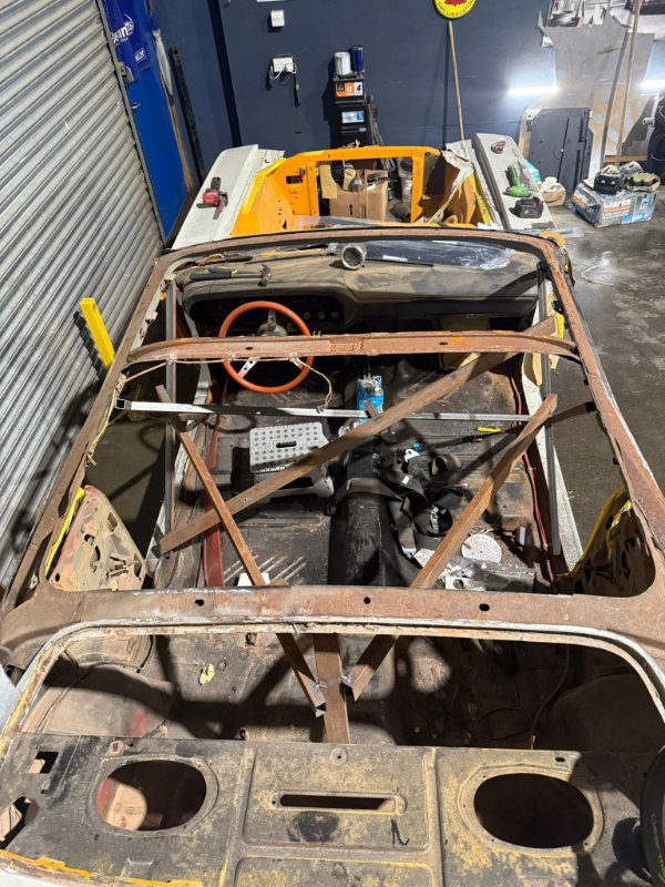

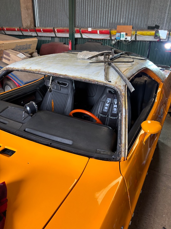

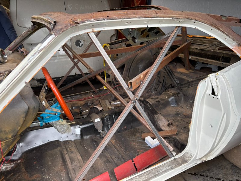

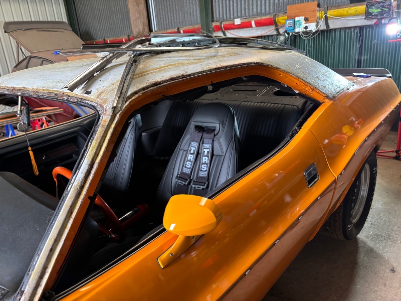

From there it was a case of starting to dig out all the rot, brace the crap out of the car and cover my eyes while a much more competent welder than I removed the roofskin... :help:
A selection of pictures for your delectation, of random holes, bodges, bracing and grinding. This was an arse-puckering point in proceedings for me.
12. Roof removal uncovering bodges.jpg (100.51 KiB) Viewed 10772 times
13. Roof removal uncovering bodges.jpg (110.96 KiB) Viewed 10772 times
14. Roof removal.jpg (103.25 KiB) Viewed 10772 times
15. Roof removal grot.jpg (95.33 KiB) Viewed 10772 times
16. Oles.jpg (111.91 KiB) Viewed 10772 times
17. Skin Off.jpg (138.51 KiB) Viewed 10772 times
18. Skin off Closer.jpg (143.34 KiB) Viewed 10772 times
19. Grot.jpg (115.15 KiB) Viewed 10772 times
20. More oles.jpg (112.85 KiB) Viewed 10772 times
21. Roof Off.jpg (123.1 KiB) Viewed 10772 times
22. Roof Off.JPEG (150.27 KiB) Viewed 10772 times
24. More still.jpg (118 KiB) Viewed 10772 times
25. Bracing.JPEG (131.67 KiB) Viewed 10772 times
26. More bracing.JPEG (126.5 KiB) Viewed 10772 times
29. Digging out more lead.JPEG (102.64 KiB) Viewed 10772 times
30. Cleaning up for cutting out.JPEG (135.81 KiB) Viewed 10772 times
31. Digging out bodgery.JPEG (100.37 KiB) Viewed 10772 times
