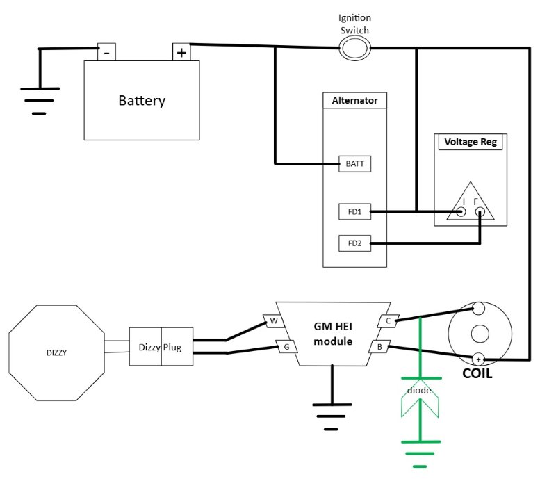

OK - Engine out, engine gone, 12v-all-in-1-MSD-dizzy gone with it.
New engine in, just wiring up.
As I looked at the newly supplied orange box and the ballast resistor I just got a sinking feeling remembering all the pain. Do I REALLY want to go down this road again...? I remembered in the past the view of 'Get rid of the ballast, stick an HEI in there, 12v to the coil - boom - off you go.
My coil is an MSD blaster2 - so 12v - I really want to feed it 12v. Reading up over the weekend I think its actually not too bad.
Using the voltage reg that I have (which fed the 12v MSD previously) I reckon the new setup could look like THIS.
Could someone sanity check it. Seems too easy. But given the coil and voltReg are both suitable...
thanks !
Drawing 1.jpeg (37.85 KiB) Viewed 25381 times

OK - despite no feedback, updating this one for reference (which is what this forum is GREAT for)
Sorted.
Long story short -
1 - The diagram at the top is correct. This is a simple way to ditch the ballast and the orange box.
2 - HEI modules appear not to be created equal. I bought 2 really cheap ones just to get it running and test the theory - both were DOA. Eventually I borrowed one from a scrap HEI distributor and that worked. This is where I lost the most time.

and i [protect mine with a diode
lots of stuff here
the link to slant6.org is good as well, slightly excessive given an installation as shown in your diagram works perfectly well... but good read

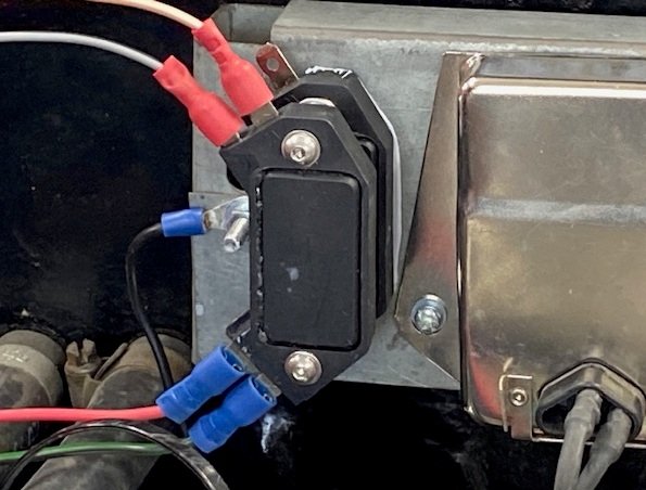

Funny think was I KNEW the module was the questionable bit - but 2 of them... threw me. (ignore temp wiring)
I'd even double stacked them anticipating a roadside failure at some point. Lots of space , heat paste, airflow and gaps.

that wiring will be fine....
have a little squizz at the diode stuff on the linked page

Good tip on the Diode - Looking at it now. Seems a no brainer; will update diagram for reference.
sooo - like this ? (green)
Posts: 9607
Re: HEI module swap ?
Yeah. That should do the job.
Those GM ones should be good.

Mounted. Double stacked. Trimmed. Spare spade ready for new diode. Fingers crossed...

OK - Final update.
All works 100%. Car runs beautifully.
Wiring diagram above is good for those who come later and make the swap.
Installation has double stacked HEI modules just-in-case. Only thing I have to add is the diode for protection (on its way).
Excuse the quality of the pic - but final install, with earthing and airflow.
