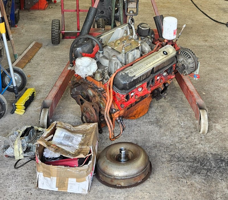

Here's the engine.
Here's the engine.
- 20251110_095755.jpg (160.73 KiB) Viewed 34640 times
- 20251110_095755(1).jpg (185.16 KiB) Viewed 34640 times

Definitely looks like some of my old engine. Are the motor mounts solid? That's not the carb, is the alternator a Denso? looks bigger. Does it have an MSD Dizzy? Can you pull the crank in and out about 1/2 inch?

It's with Dave Billadeau now so I can't answer all these questions. He mentioned your name as a source of info.
The carb is a Holly.
Dave just took out the pistons. One of them is an odd replacement. He reported that otherwise it is pretty much stock.

Yes, the odd replacement! Had a cracked piston 5 days before an event. got hold of a piston, had a machine shop push out the con rod and replace. Then home balanced it by weighing other piston/rod combos and filing bits off the piston underneath. Seemed to work as I ran my best times at the event! Intake was a single plane (I think) with a Holley 600 double pumper with machined off choke horn when I had it. Better gas mileage than with the old 600 vac sec.
Heads were cleaned up/ported by Blue, but I don't remember them being that shade of orange/red...... Dave Billadeau will sort you out! Looking forward to updates and see it live again.
