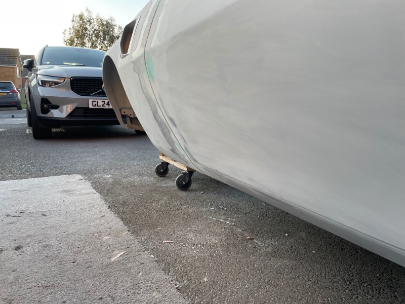

Well I’ve finally managed to fully align the front end metal,
Still got a few small tweaks to make but overall it’s pretty sharp,
I’m currently about 6 months behind schedule so looking very unlikely it’ll be done this year,
Ces’t la vie
Ces’t la vie

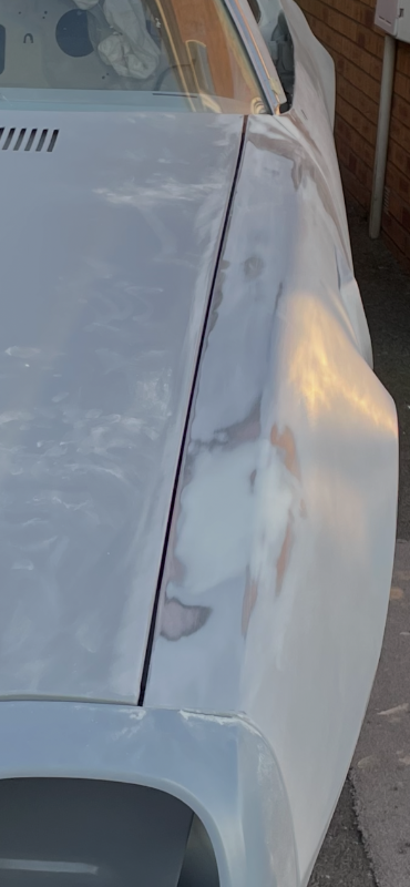

Re: My very last restoration!!!

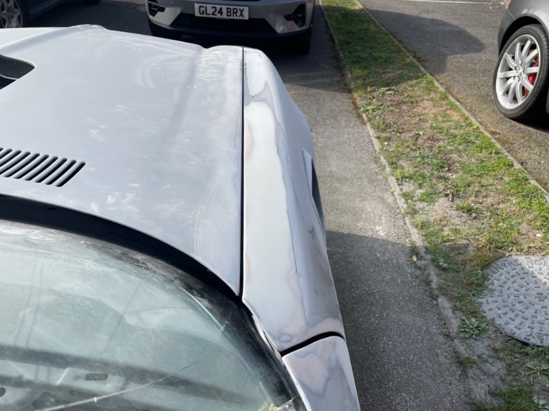

Virtually finished the gapping now , just the nose panel to finish off, this is being a right pain, stripped it twice and twice it’s moved and cracked after about a month?
Tried two different epoxy’s neither worked,
I’ve been trying to follow guidelines from the US but obviously I can’t get the particular type of epoxy recommended, so thought sod it and try the old way,
I’ve ordered a full replacement interior from Legendary,
Slightly premature I guess but took advantage of a sale this weekend,

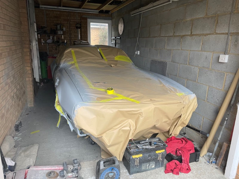

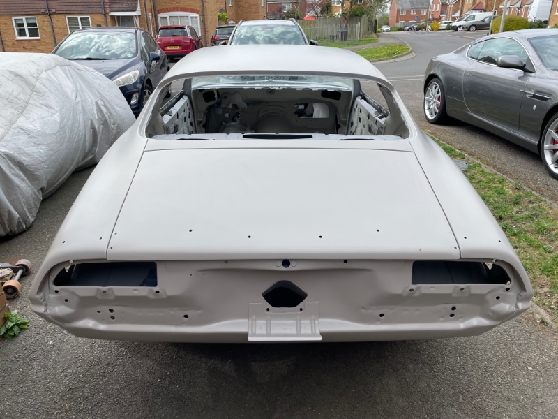

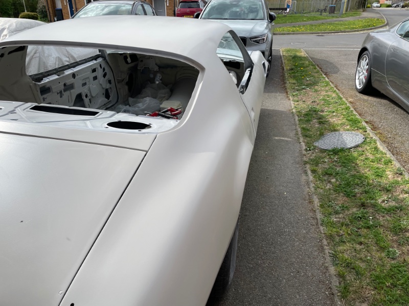

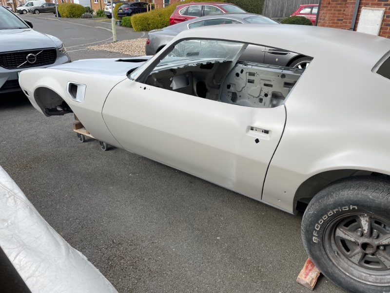

So following a good old blocking session last Saturday I’ve actually now started the primer stage,
I’m trying out a new twist on 2k this is apparently a hybrid 2k and has some kind of epoxy additive so it dries with a proper sheen,
I guess in a decent workshop one probably would appreciate the shine as it highlights wobbly bits a tad better,
However it flats lovely dry long blocking with 240
Is fairly easy going,

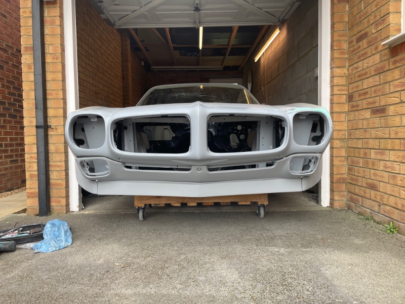

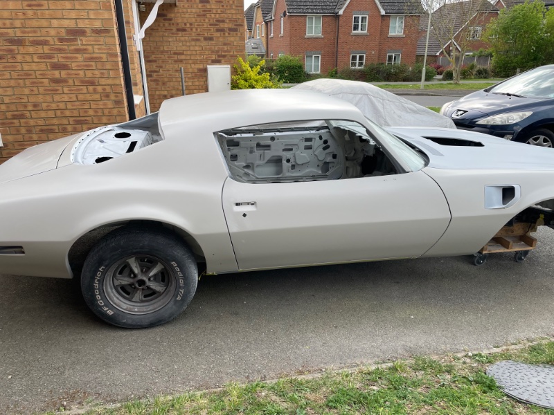

The turd is now in 2k primer , still got the hood to primer and still shaping the Bull nose ,
But not far off now !
The primer is a mid priced product by Silco
M8 , i suspect the slight sheen is the result of Styrene being present,
It lays down nicely and over fully cured Epoxy it’s very good,
However whether I’d Bananarama! over sanded old paint ??
Thing is theses days compliant EU countries are seriously controlled and all the decent chemicals are banned!
However this and a lot of the other stuff is manufactured in Eastern Europe and Israel etc so one never really knows what one’s getting !
- IMG_5945.jpeg (214.19 KiB) Viewed 19434 times
- IMG_5950.jpeg (188.27 KiB) Viewed 19434 times
- IMG_5949.jpeg (213.72 KiB) Viewed 19434 times
- IMG_5954.jpeg (184.82 KiB) Viewed 19434 times
- IMG_5953.jpeg (179.57 KiB) Viewed 19434 times

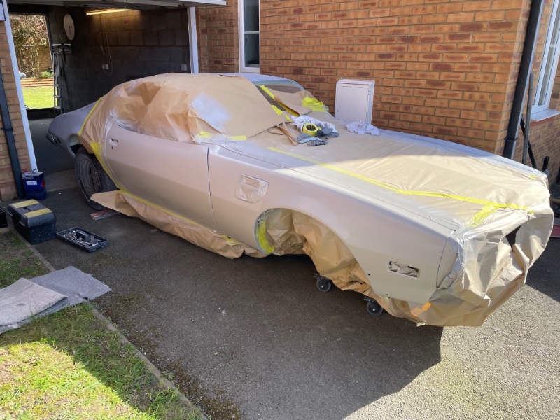

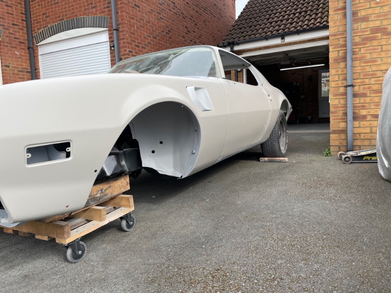

So I’ve been doing a nose job today ,
Got a small amount of fitting but generally yeah all looks reasonably good!
- IMG_5962.jpeg (204.65 KiB) Viewed 19350 times
- IMG_5961.jpeg (197.04 KiB) Viewed 19350 times
- IMG_5960.jpeg (217.86 KiB) Viewed 19350 times
The lower front panel is a second hand one I acquired as my original had so rust through on the underside
This replacement has suffered previous accident
And sits a bit Bananarama! on the right side,
So this will require a bit of faking but nothing serious,
The amount of work is actually surprising me,
I’ve done loads over the years but this thing is a nightmare really,
I’m over 1100 hours so it’s going to be well over 1500 to finish the thing!
Currently losing the will to live!
