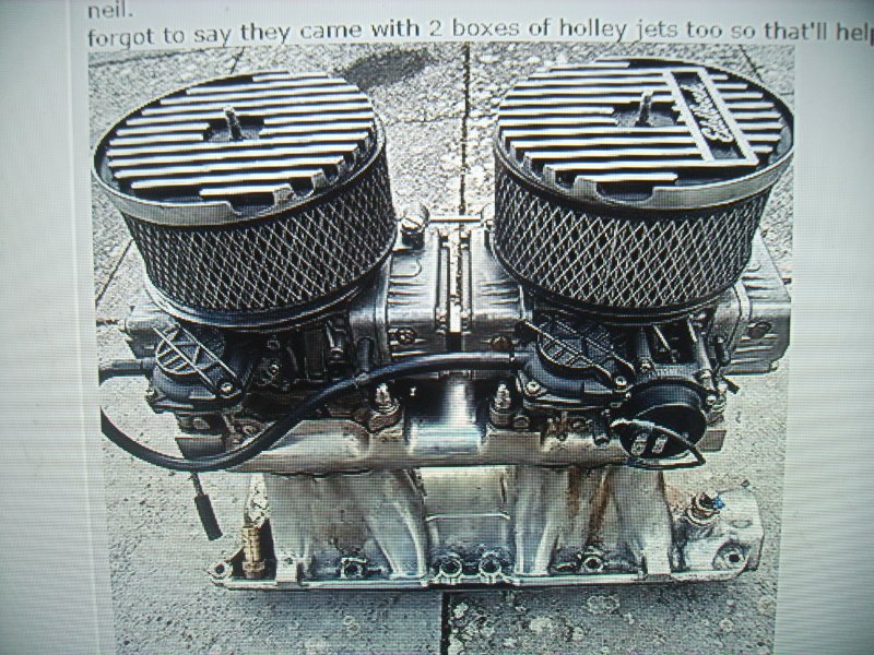

i needed carbs for the tunnel ram and as it'll be almost exclusively a street car they needed to be a) smallish and b) holley's as i prefer/understand them. so when a small block ford polished tunnel ram came up with a pair of 390's on i did the obvious thing and tried to buy just the carbs. no dice there so i bought the lot and have advertised the manifold and filters for sale.
forgot to say they came with 2 boxes of holley jets too so that'll help with setting them up for my fe engine.
