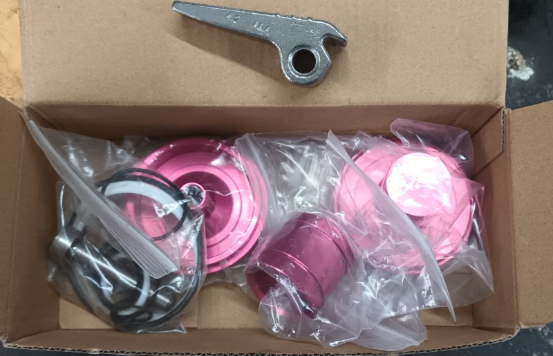

I checking through all the parts I bought 10 years ago.
I have a 4.2 band apply lever, and a Chinese accumulator kit.
Do I use both ?
Or just one or the other.
Posts: 14558
Re: Johnny's Dart repairs
Use it all.

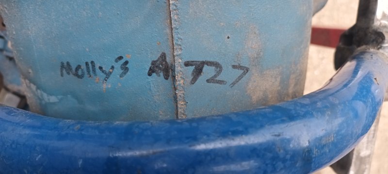

I wish I knew who Molly was, this came in the car when I imported it, she must be in America , the car came from Arazona .when I removed it , I saw the writing on top of it 🙂

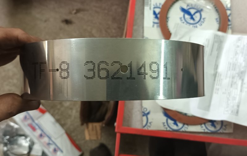

I bought a kick down band, but I don't know if it was a performance one or not, can any one tell by the colour of the lining , or part number ?
The raybestos one is the one I took out , that was flaring 1 to 2 changes.

Johnny Dart wrote: Sun May 17, 26 3:53 pm Just looking though all the parts I bought 10 years ago 🙄
Can anyone help with this ?
Will this band work ok with my 727 upgrades? is it just a standard one ? or is it a heavy duty one ?
I bought it over 10 years ago , I can't find the receipt, I've no idea what I bought :(
Please see pictures in above earlier post.

Posts: 14558
Yes thats a standard band, fine for your needs. Its known as a wrap band as opposed to a rigid band (like the rear one} which these transmissions originally had.

Post by Johnny Dart »
Thanks Blue, Ill go with that, It may well have come with the Alto overhaul kit.
What fluid would be best, Dexron 2 ?
Apologies for the questions, and probably a lot more :)
Posts: 14558
