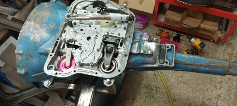

I'll try for some more gearbox time this weekend 🐈‍⬛
Posts: 14582
Re: Johnny's Dart repairs
You’re nearly there now, I recommend air testing it before you fit the valve body, you can at least prove the clutch packs and bands will apply.
Johnny Dart
Posts: 917
Joined: Tue Dec 24, 13 12:46 pm
Post by Johnny Dart »
I've just put the compressor on to do just that.
Fingers crossed it works .

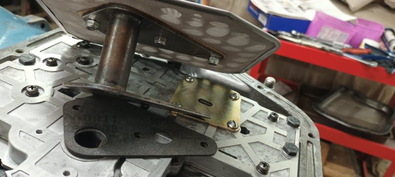

Nearly there.
This filter extension was made up by someone on this forum, I bought it about 10 years ago, I can't remember his name .

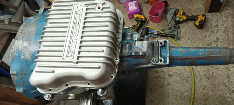

Johnny Dart
Posts: 917
Looks like that's it for today. I need some cap head bolts for the sump.🙄
Posts: 1590
nice extension :thumbright:
myself i'd add a 'strut' between the 2 bolts/nuts at the filter down to the plate at the valve body (to the right in the pic). it should be fine but i'm a belt and braces type of guy, lol. it's my farming background i'm afraid.
Johnny Dart
Posts: 917
Agreed, me too on the belt and braces :)
Its is well made , I don't know if it will vibrate or not.
It was made by a guy on this forum, but I can't remember his name, I think he made quite a few.
I'm sure someone on here will know who it was.

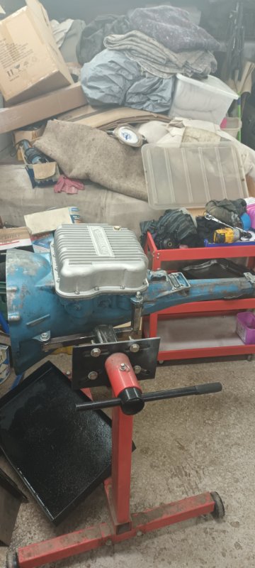

That's it done , the stainless cap bolts arrived yesterday, so there in , loc tighted and torqued up.
Now I've just got the remove 8 years of piled up , and stuffed underneath the Dodge Dart detritus.
That's in the picture behind the gearbox.
I've got a few other car jobs to attend to first though 🙄
Johnny Dart
Posts: 917
I cleared off the top. No rodent damage luckily.
There's still some stuff underneath yet.
