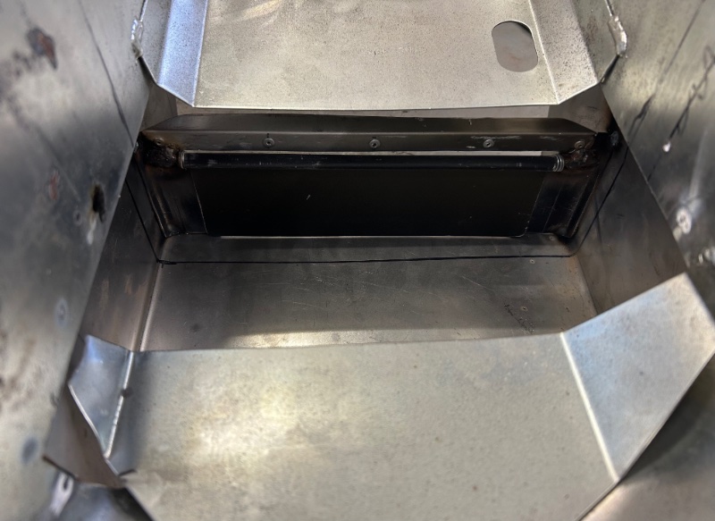

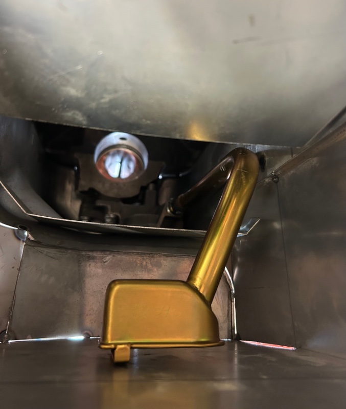

Todays job was making a trap door, it opens on acceleration and closes on braking in order to keep the pickup covered. It needs to move swiftly with oil surge so the door itself is aluminium rolled loosly around a steel rod to act as a sloppy hinge. It moves very freely and shouldn’t become jammed. I’ll fine tune the location before welding it in.

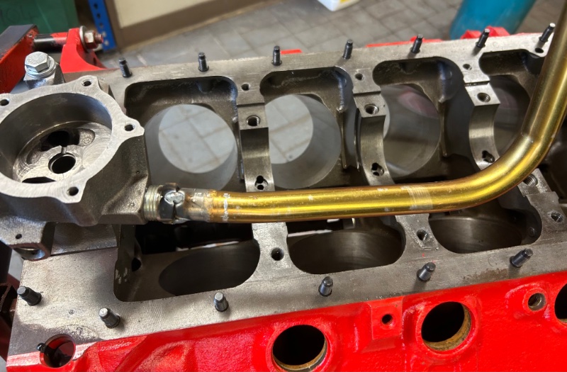

Finishing off mods to the oil pump. There's just enough”meat” to drill and tap the existing pick up port to 1/2” NPT, up from the stock 3/8” NPT. The 1/2” pick up tube narrows down considerably when it enters the pump, this will give me 1/2’ all the way in and out of the pump now. I spent some time deburring the ports and I think thats as much as I need to do. I’ll have to be careful not to split the pump body when installing the pickup but I have an idea for that.

Your'e a clever sod, that trap door is a clever bit of stuff.
Posts: 14617
Re: Blue's Barracuda
Can’t take any credit for that Del, its pretty much a standard mod on race oil pans, especially on roundy roundy stuff where you have oil sloshing in all directions.

Pan pretty much ready to finish weld. Pickup tacked to the 1/2” boss. I left a 1/2” drill inside it to perfectly align it while tacking it, as expected it slipped out easily afterwards so anther job jobbed…

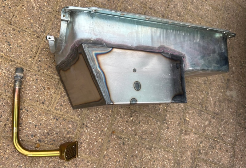

Pan and pick up TIG welded Today so that’s another bit finished.

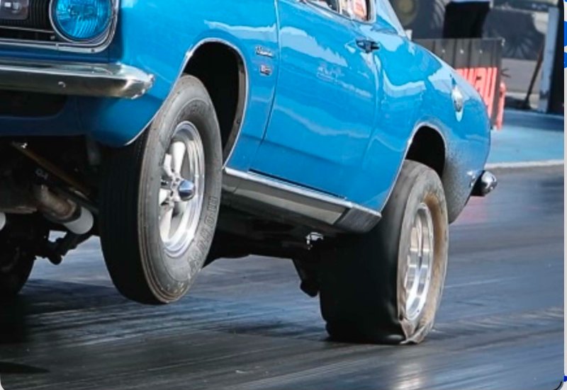

On the verge of Tyre shake....
Tyre Crush.jpeg (69.24 KiB) Viewed 178 times
Posts: 14617
Not something I can feel but I’ll try 12psi next time and see how that responds.

I'm not sure a Nostagia Superstock has enough wheelspeed to produce proper tyre shake but I agree with Blue that increasing the pressure might help reuce those wrinkles (don't you dare Rob, Stu) getting under the contact patch, after all thats part of the tuning process.
Posts: 14617
No it’s not tyre shake, its just deforming the tyre excessively. Extra pressure might not fix it, the sidewalls could be worn out, there’s not much left on the tread area.
