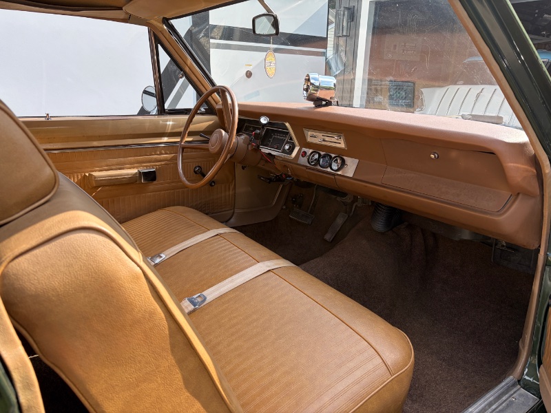

Any bites on the Nomad yet?
I like the braaaahn interior. :D

Jeff
Posts: 8026
Location: Ontario.
Re: Jeff’s ‘69 Valiant
Post by Jeff »
Interior back in apart from under column trim.

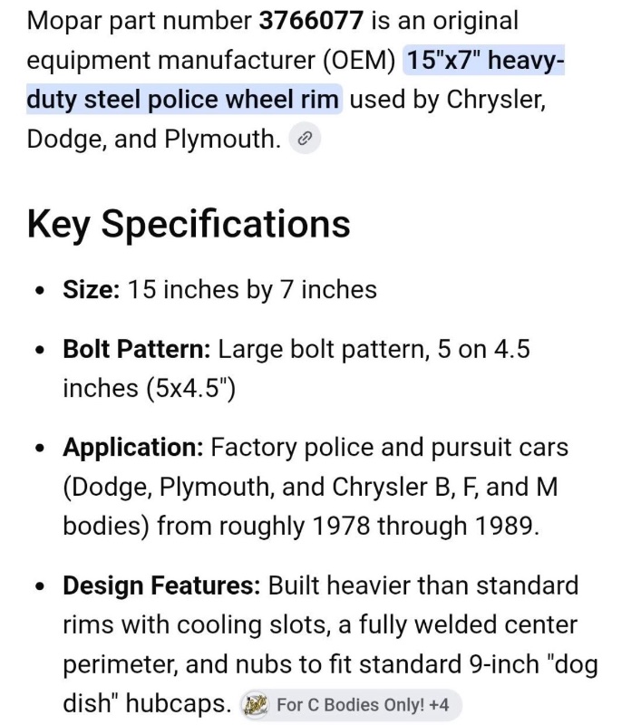

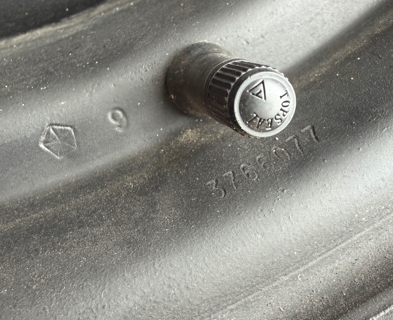

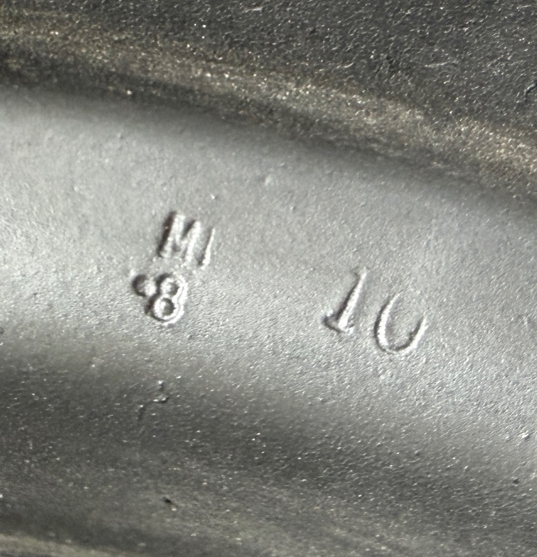

Found the rear wheel info from stamped numbers on them.

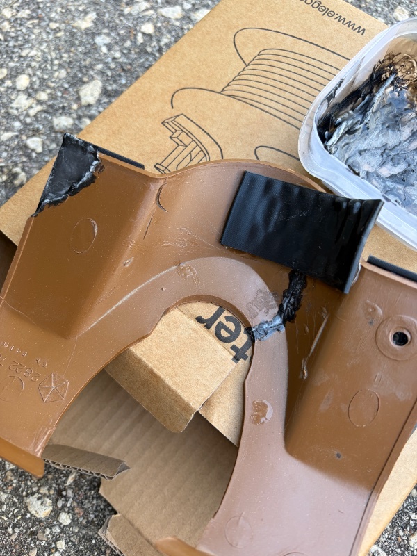

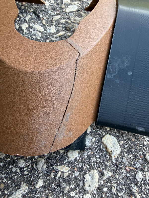

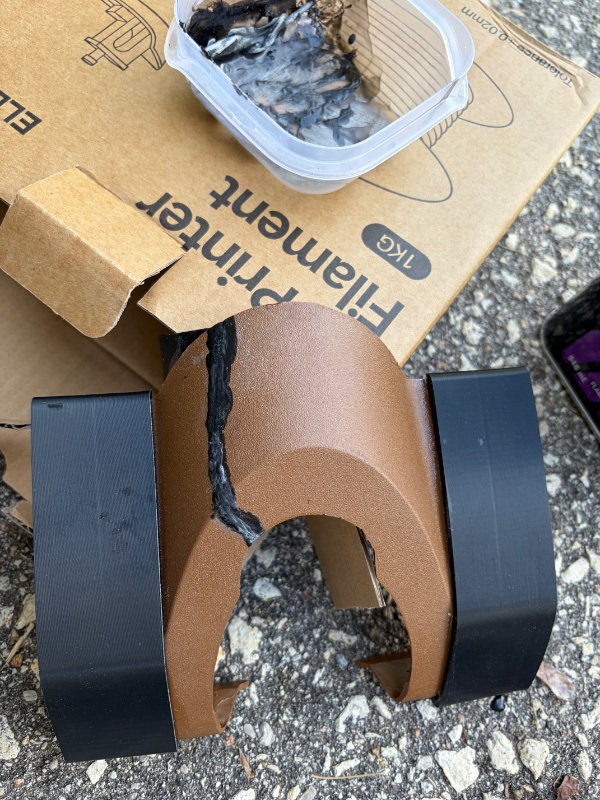

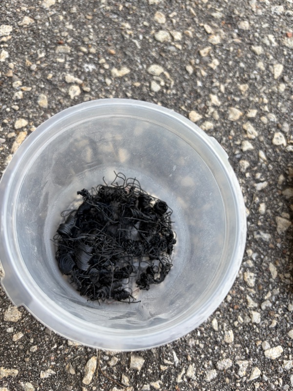

So I got the ingredients to mix some ASA slurry.
It is a melted plastic, that will bond with the original plastic.
Just mix the raw ASA plastic with Acetone. When it has melted to a paint like consistency, brush into the crack.
It will go off quite quickly.
Going to leave this overnight. To totally harden, then start sanding.

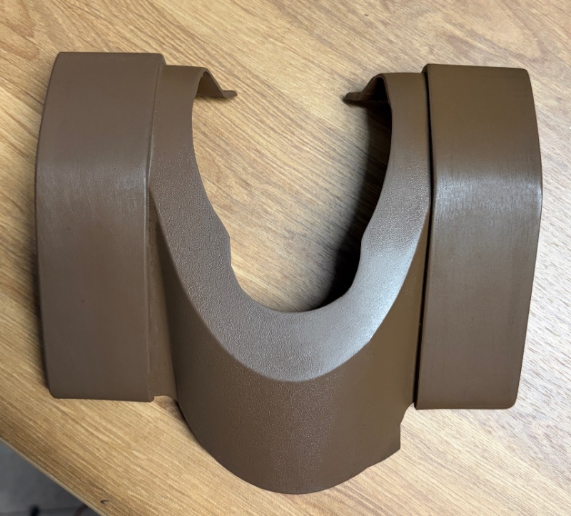

Jeff
Posts: 8026
Location: Ontario.
Post by Jeff »
well, it aint perfect. Still more to do.
RW71
Posts: 720
Post by RW71 »
Excellent work, love that! :thumbright:
Posts: 7682
That looks spot on to my untrained eye :thumbright:
