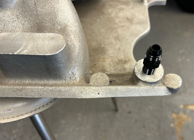

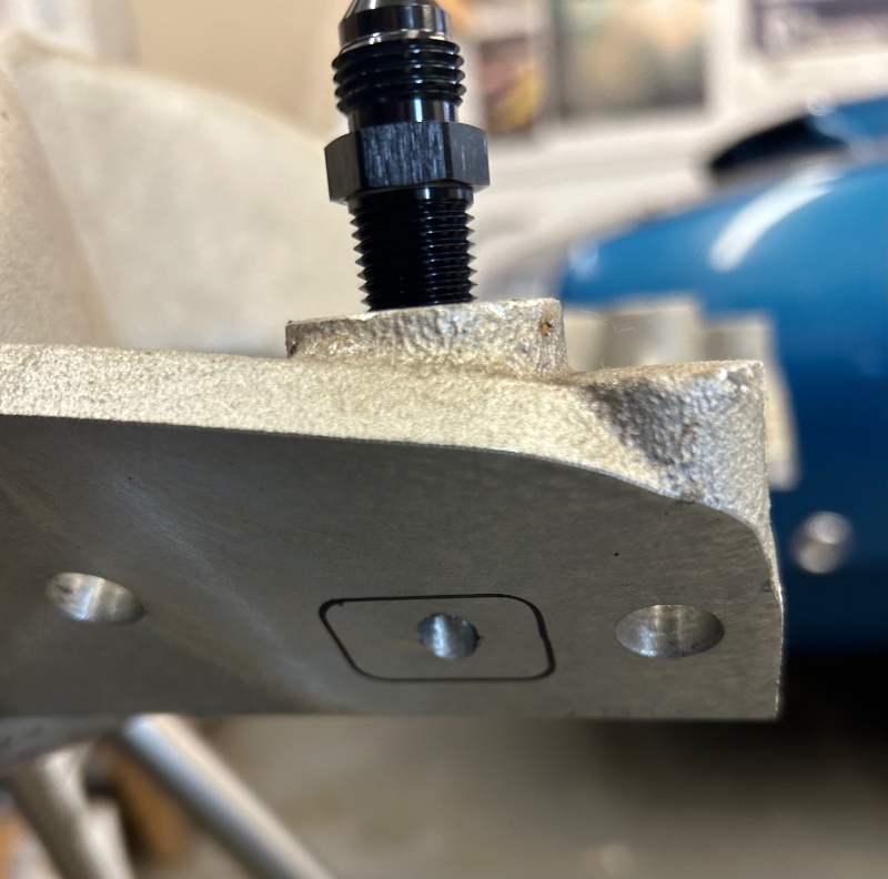

Back to working on the Indy engine. Drilled the bosses at the rear of the intake manifold to intercept the rear cooling passages in the heads. Eventually AN6 lines will connect to the thermostat housing to allow improved cooling to the rear of the heads.

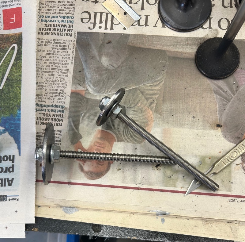

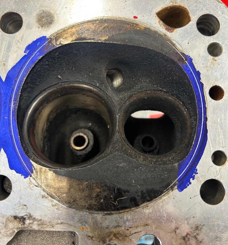

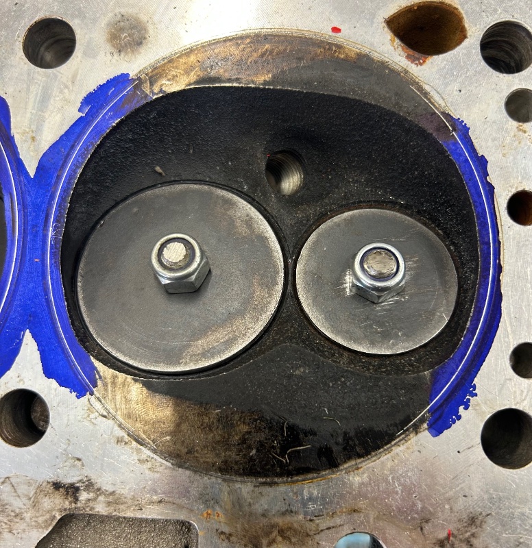

Having failed to find anyone competent willing to port the heads, I’m having to do it myself. Unshrouding the valves should offer good benefits so I’m starting there. First job was to make some dummy valves to protect the valve seats while I’m working close by.
Posts: 7682
Re: Blue's Barracuda
Love the dummy valves Blue, great idea for avoiding any accidents. I wouldn't have the courage (forgetting not having the knowledge to start with) to do this on anything but a scrap motor :shock:
Posts: 14650
Not really looking forward to it Steve, it’s slow repetitive work with a high chance of screwing it up. But I can’t not do it, there’s a lot of horsepower to be had and I’m ‘avin it!
