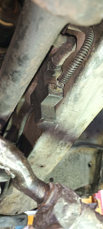

I'm having a bit of bother bleeding the rear brakes, I can get little to no brake fluid with my vac brake bleeder.
I think it may be something to do with the brake valve on the n/s/f chassis leg.
Is there something that needs to be reset, it's like the valve has blocked off fluid to the rear brakes, like it would with rear brake failure.
Any ideas .
Thanks
Johnny

It's got a Dana 44hd axle with disc brakes, the 2 rear hoses were new, so should be OK
but I will check.
I seem to remember years ago someone on here was saying that the brake valve in my picture was fitted to cut off fluid to the rear or front brakes , if there was a circuit failure.
I just don't remember what was said about it.
Or how to reset it
Or how to reset it

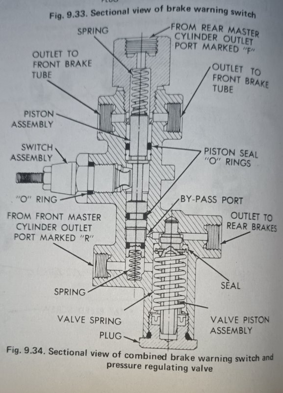

Re: Bleeding rear brakes on a disc brake Dart 1972
After some Google and you tube research, I found that there is a shuttle valve inside the combination/proportioning valve.
I managed to get it back in position , by bleeding the front brakes first, and then the back. The Vac bleeder did not get on with bleeding the brakes where there was a combination valve involved. It had to be pedal pressing method.
There is a tool that locks the shuttle for bleeding .I bought one , but its not arrived yet
Ok for next time.
Ok for next time.

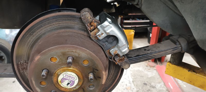

I also found the boots had split, on the caliper pistons, they were siezed up too.
I fitted new ones.

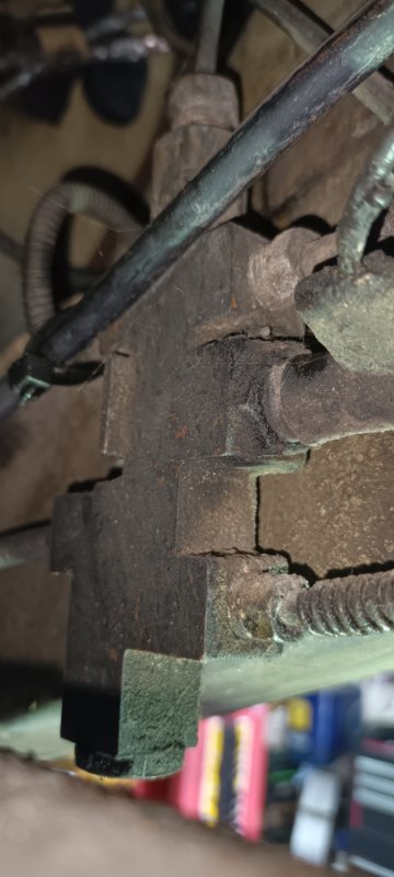

Here's a pic of the combination valve.
I fitted new ones.
