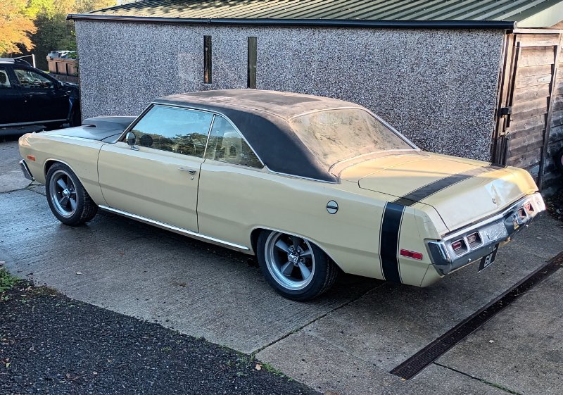

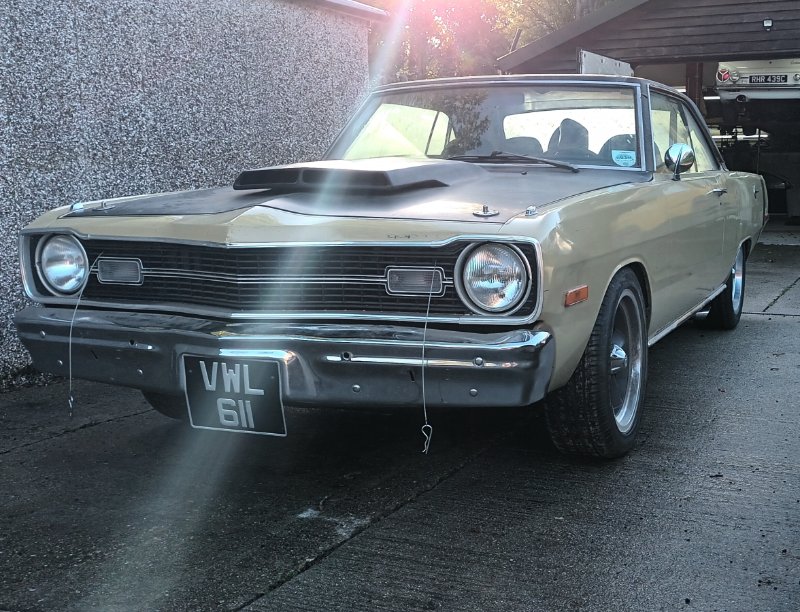

Outside for the first time in 10 years.
A dust off , then back in the barn, while I get the heads built, then it's on with the big valve heads, Hughes whiplash cam , new inlet and 600 VS carb.
Posts: 1521
Re: Johnny's Dart repairs
that sits nice....
