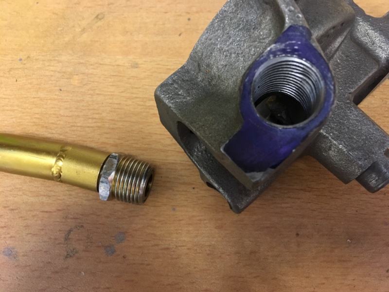

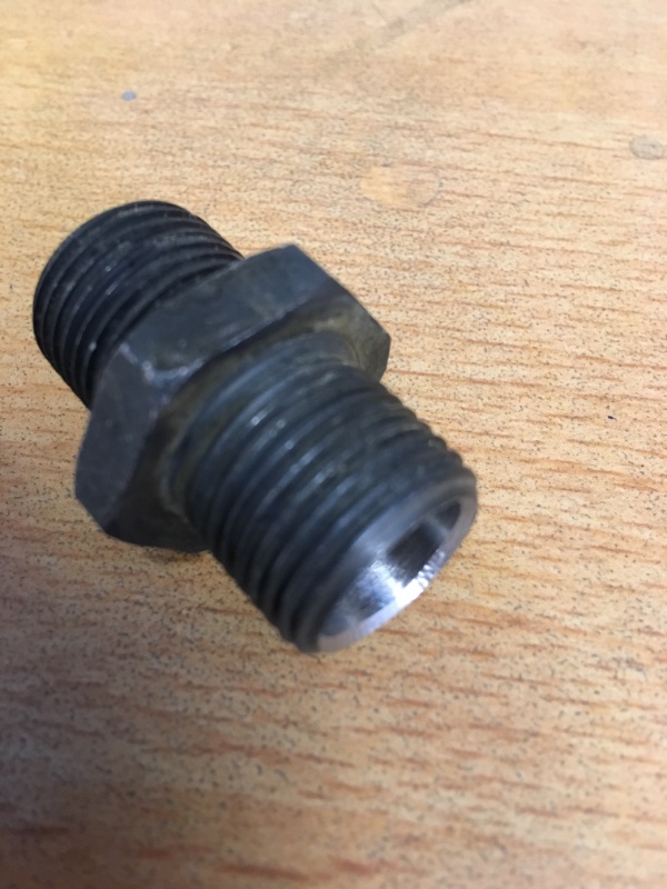

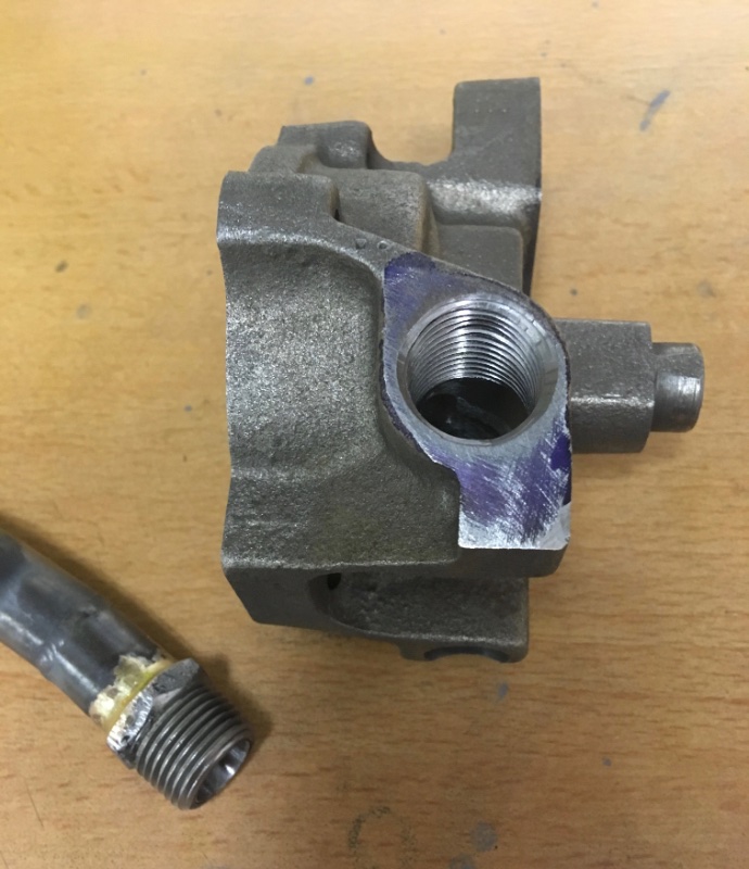

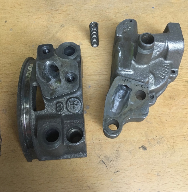

More progress. Melling high volume oil pump, research suggests that these really don't flow any more oil unless you do something about the pick up diameter. The Milodon pick up i'm using is a generous diameter until the welded on section at the end which necks down to the stock 3/8" NPT. I had a steel 1/2" NPT gauge adaptor which I tapped out to thread on to the end then brazed on. That allowed me to drill out the restricted section to 1/2". The pump had enough meat to tap it out once I had moved to centre over a bit with a die grinder before going in with the bigger drill & 1/2" tap, sorted.
Cut a coil off the relief spring to drop the oil pressure a bit, ideally I'd like to see 20 psi at idle and no more than 70psi max @ working temp. we'll see.
Did the usual port match on the pump body and cap and drilled both to 1/2", thats that side of things finished.

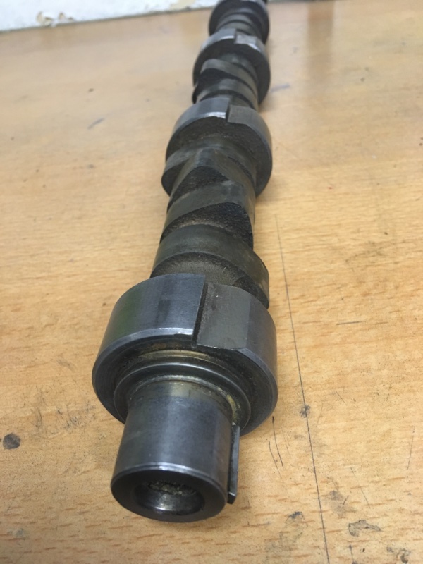

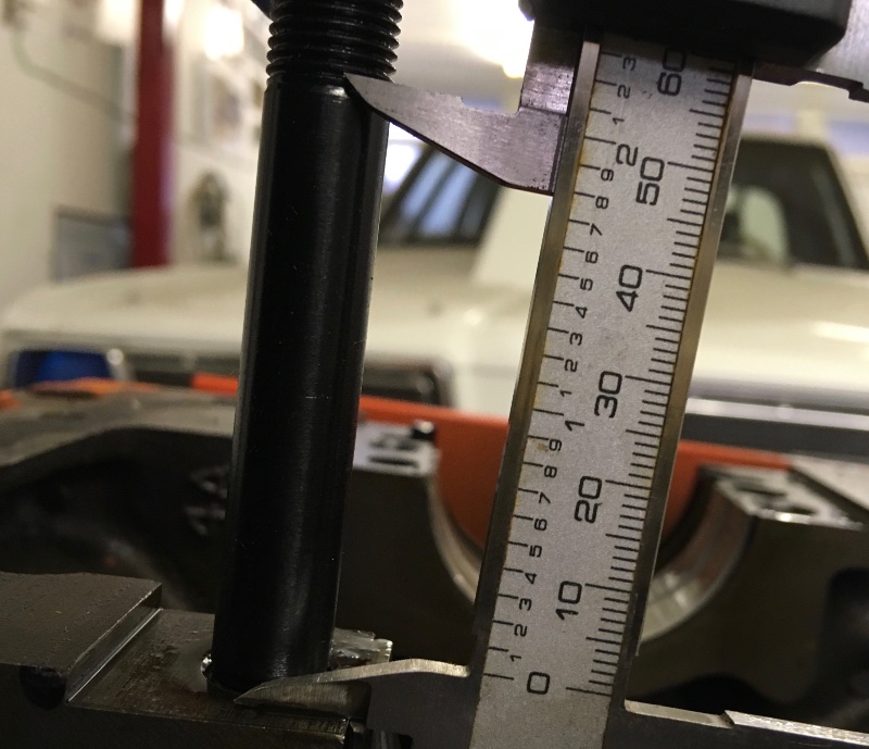

Todays task, create a cam bearing reamer from an old cam, thanks Matt!

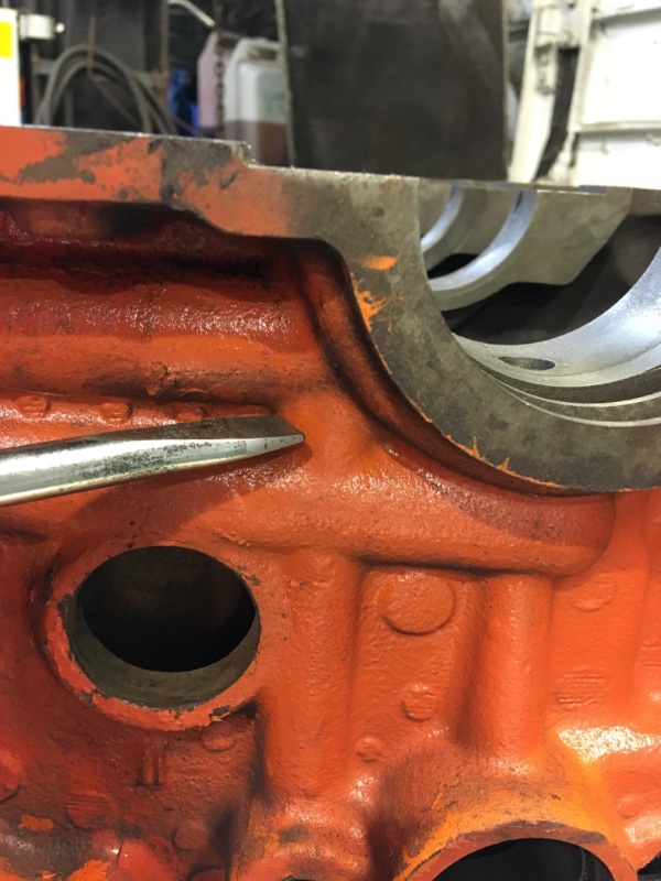

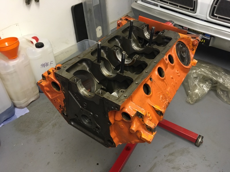

Finished up the block oiling mods Today. First job is to knock out the small core plug that sits about here, it separates the feed and return from the oil filter. A long piece of rod down the oil pressure port on the top of the block gets it out.
Posts: 14502
Re: Blue's Valiant

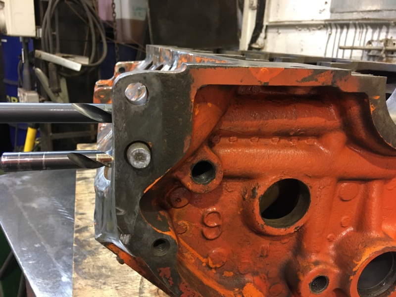

You can then run your 1/2" drill through to the lifter gallery where it necks down.
Posts: 14502
Re: Blue's Valiant
The feed and return for the filter now get opened up to full size...
Posts: 14502
Re: Blue's Valiant
And finally the oil filter boss gets the 1/2" drill through it too. This should see me safe to 7500 RPM, not that I plan to rev it that hard but as it cost me a total of £23 for a long drill and an hour of my time it seemed a no brainer for the extra insurance.
