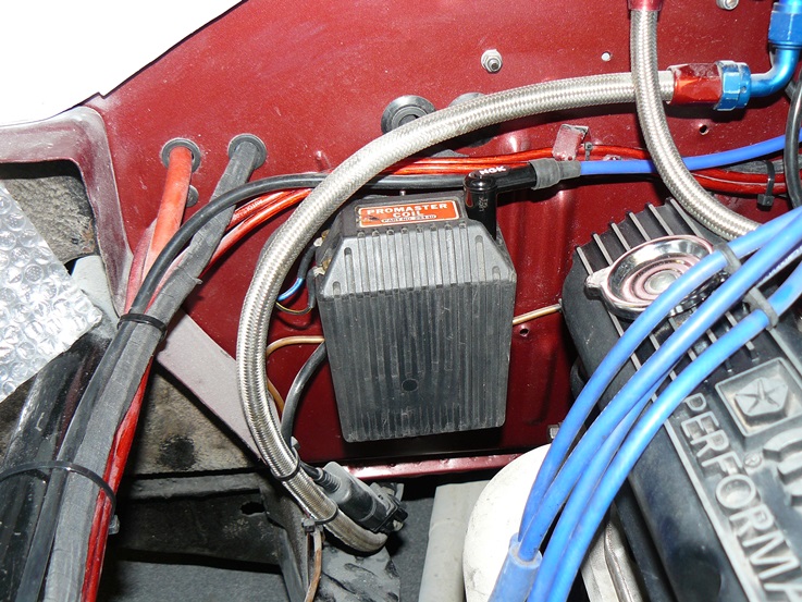

I just spent the last few hours making a new stainless bracket for the new Mallory coil and you can't even see the damn thing

Currently trying to decipher the wiring so I can graft in the Mallory unit. This may take a while.

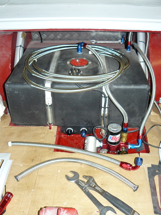

Still not tackled the ign but I'm replacing ALL the braided hoses due to the original crap stuff failing.

- Renewing fuel hoses.jpg (209.34 KiB) Viewed 1891 times

I'd quizzed Dave Billadeau about the ign wiring and he sussed what I'd done wrong- I'd only connected the start live and not the run live to the ign pack.
