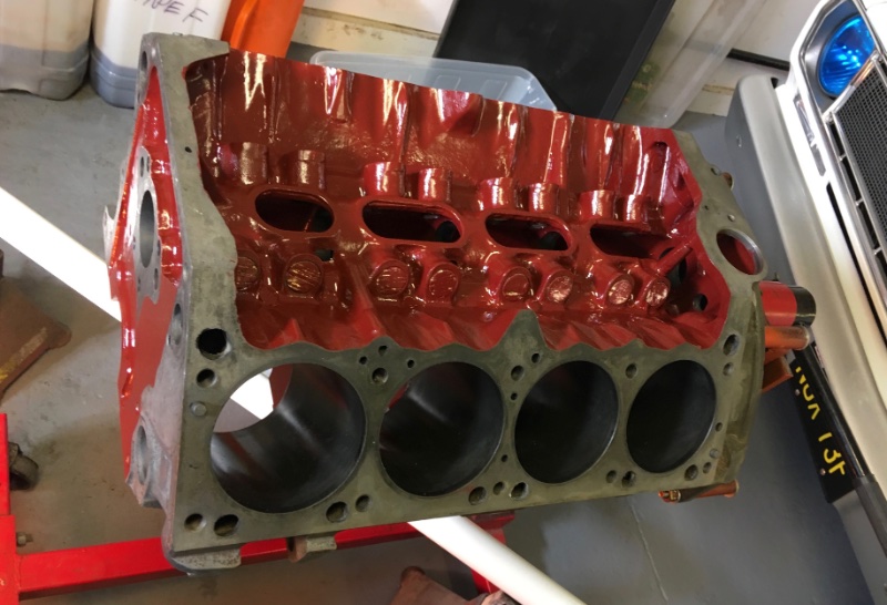

Still cracking on, just not much worth posting about. Rotating assembly has been balanced, block has been hot tanked and I'm on with painting the inside with Glytal. This is 2 coats, I'll give it a third Tomorrow and call it done.

What does the magic red paint do ?
Stop rust and help oil slide ?
Posts: 14502
Re: Blue's Valiant
it's paint designed for use on electric motors, very tough stuff. Once applied to a spotlessly clean surface it flows into the rough cast iron to leave a hard smooth shiny finish, great for oil return and clean up is so much easier if it has to be torn down again, and yes it protects against rust. You will read as much negative as you will positive about it on the net, I found out about it in the '70s and have used it on my builds ever since.
