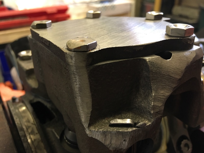

Finally got back to assembling the short block, need to take the oil pump off and grind the body as it's touching the oil pan and stopping it from sitting flat :roll:

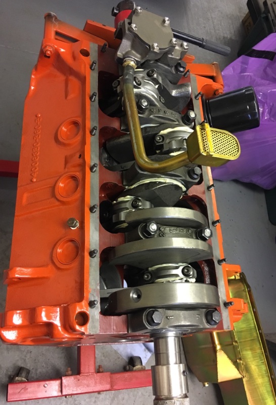

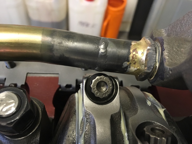

Oil pump clearanced, new pick up is a bit tight for clearance but at a little over 35thou it should be adequate. Crank scraper doesn't clear the oil pan either so thats getting relieved next..

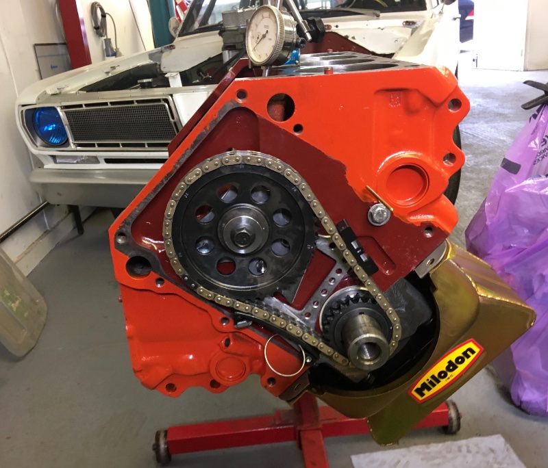

The build stalls again. Some of you will know of my hatred for Cloyes timing sets and their non existent quality control, they've done me again. When I pulled the 408 apart it had a newish timing set in it with no stretch, I googled the number stamped on it and it came up as a Comp Cams so I set it aside to reuse.
This morning I was degreeing in the cam in and on the straight up setting it was 2.5 degrees too advanced, on the 4 degrees retarded mark it was 9 degrees retarded and on the 4 degrees advanced mark it was 8 degrees advanced, junk.
A bit more googling of the part number also came up with Lunati, Summit own brand and Cloyes who are clearly the manufacturer no matter what it says on the box, grrr.
So, Just ordered a billet 9 way adjustable set from Pro Gear (Definatly not made by Cloyes) and I expect it will be bang on if previous experience is anything to go by.

Posts: 14502
Re: Blue's Valiant
New Pro gear billet timing set came today, correct to within half a degree, boom that'll do. It's the same German chain as the Rollmasters use.
