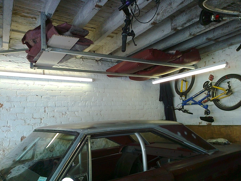

So- i came up with a neat storage set-up for my seats, carpets, etc

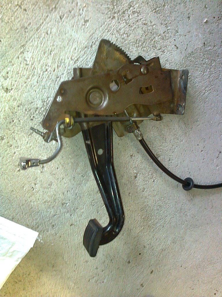

I got the parking brake lever assembly fettled and fitted. You can see the release lever is 'tweaked' to clear the roll cage.
I did a bit of internet research to figure out the cable routing- turns out i have one bit of roll cage outrigger in the way so i'll have to drill through that. Also i'll need to make a new plate to secure the rear cables as the stock one means they'll foul the ginormous tyre. Then i just need the rear cables to complete the job.

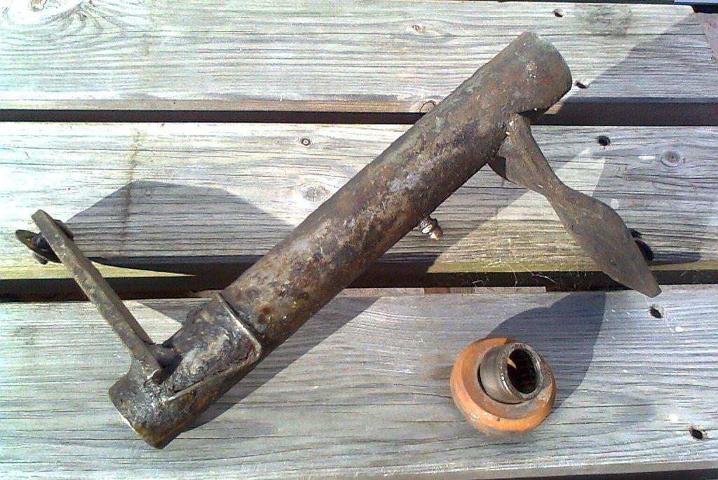

Also, i found my Z-bar and crank end spacery thing and bearing. See- i knew i had 'em somewhere!
Zed bar.jpg (153.93 KiB) Viewed 1148 times
Parking brake assembled 01.jpg (200.43 KiB) Viewed 1148 times
Seat storage 01.jpg (173.16 KiB) Viewed 1148 times

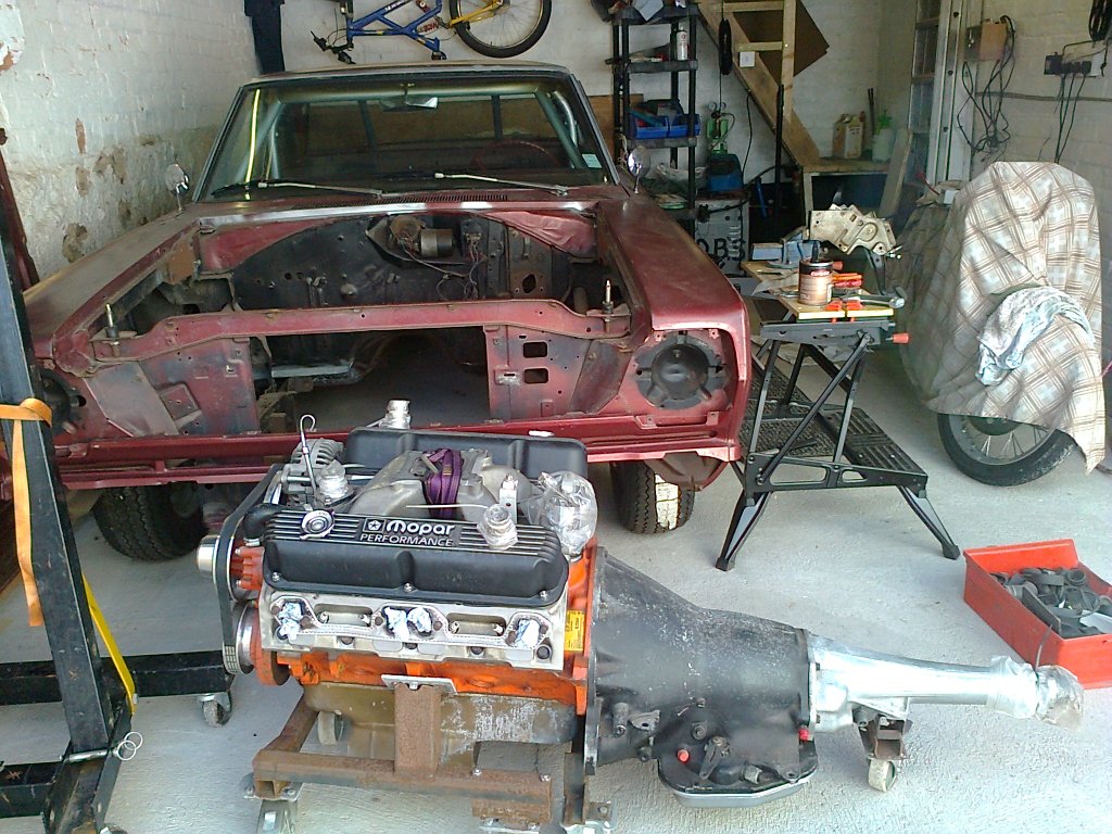

There's a couple of jobs looming that i'm not too confident about- advice please? :help:
ENGINE MOUNTING:
It's going on a motor plate with no x-member.
HOW do i work out where the engine will sit?
Left - to - right: The diff is offset so i assume the motor goes inline with it?

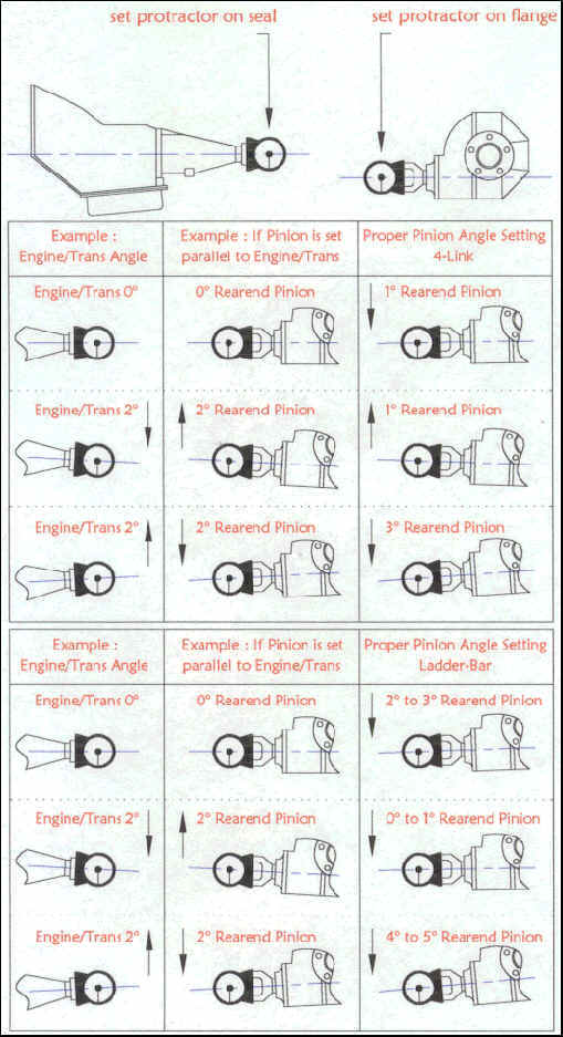

Levelling: I found a handy guide to this, see below...
Front - to - back: Well, the shifter has to line up with the hole in the floor, any other important factors here?
Up - n - down: Umm... as low as poss without fouling anything? Though again i guess the shifter (and exhausts) will have something to say...

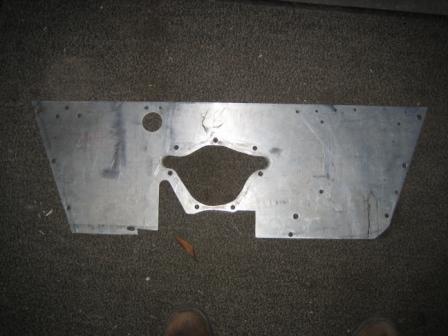

MOTOR PLATE:
No inner wings so this will just bolt to the chassis rails.
I'm thinking a plywood mock-up (or 2 or 3...) then 8-10mm ally plate?
I have a motor plate (pic below) which i may be able to mod, haven't had a proper look yet.
ANY tips and hints (and pics) greatly appreciated

PROPSHAFT:
I have a prop which i'll most likely need to alter to length.
I don't know about UJ types?
Do the 4-speed and 727 have the same output shaft?
Where along it's length does the prop loop go?
pinon angle plotter.jpg (63.3 KiB) Viewed 1117 times
