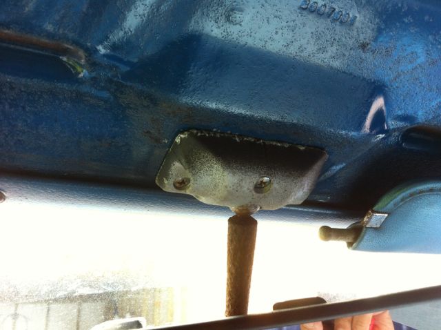

OK, so i wanted to do headliner despite it being a bit of a bugga by all accounts. I sourced new headliner bows from Dante's and the headliner via Summit. Finally opened the box to find wrong headliner last summer. complained to Summit but they wouldn't refund any shipping costs. The headliner was 3" too short and the some of the bow sections would not line up. I put it back in the box.
Time passed
Decided this was the week to have ago, atrial fit and as the headliner came with spare material my miss offered to sew an extra section to lengthen the headliner.
so, onto the trial fit.
Th essential thing is to start at the rear. I made a couple of wire retainers that would tie the rearmost bow to the rear window frame. This then allowed me to pull the headliner forward without the rear bo rotating over.
Time passed
- start.jpg (34.46 KiB) Viewed 6910 times

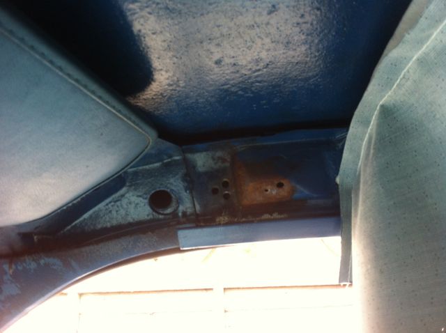

The design to mount the headliner at each end is excellent. Multiple small spikes exist under the window trim. So I stretched the headliner forward and realised the front two bows were not going to line up with their holes. Out with the handy drill and create new bow locations without actually drilling through the roof. With all bows now correctly spaced I stretched the headliner to the front screen to see how short it would fall.
I managed to get just 5mm stretched onto the front spikes. Bingo, its going to fit after all
5mm is all you need!
- rear.jpg (22.49 KiB) Viewed 6902 times
- new bow hole.jpg (38.86 KiB) Viewed 6902 times
- bits to remember.jpg (48.41 KiB) Viewed 6902 times
