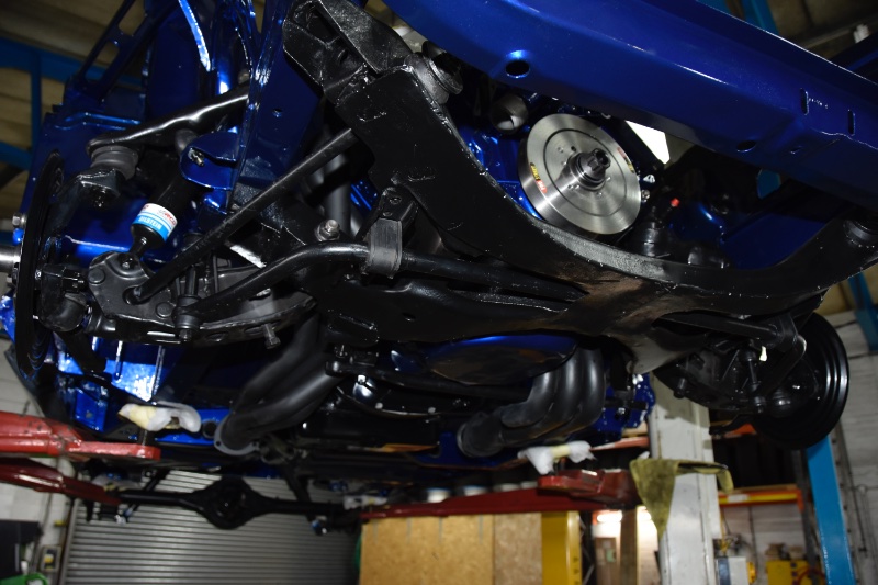

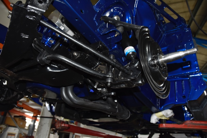

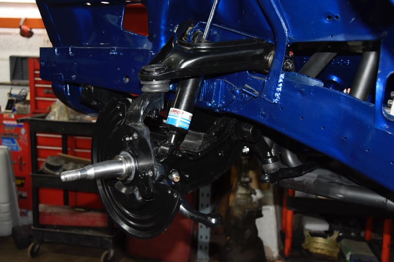

Front suspension and brakes going in - should improve a bit with the Swaybar and Bilsteins .

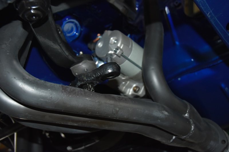

Shame I had to modify the headers after I had them ceramic coated ?? :angryfire: :angryfire: Lesson learnt
Using the mini starter is a treat with plenty of room to remove with headers in place (not like the big blocks)

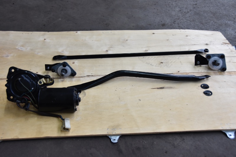

After a dislocated shoulder early last year progress slowed right down (still not right :( ) so just did the light stuff !!

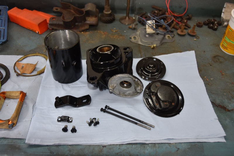

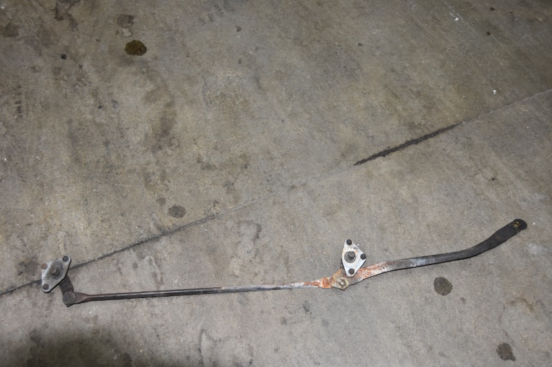

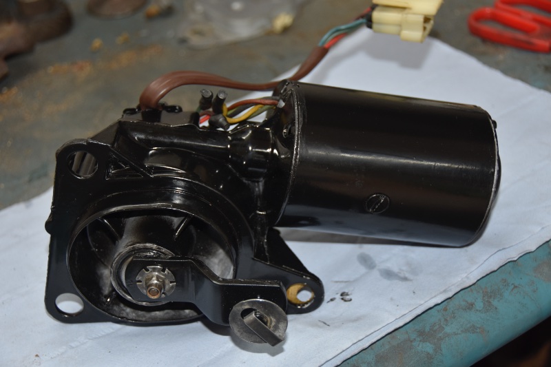

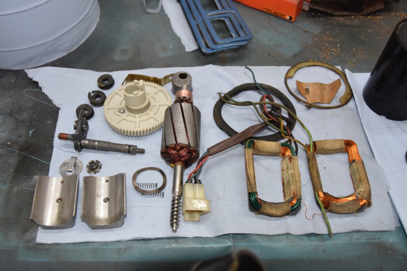

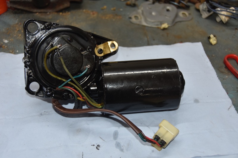

Re-furbed the wiper motor and linkages :-

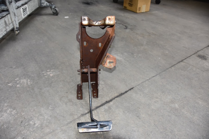

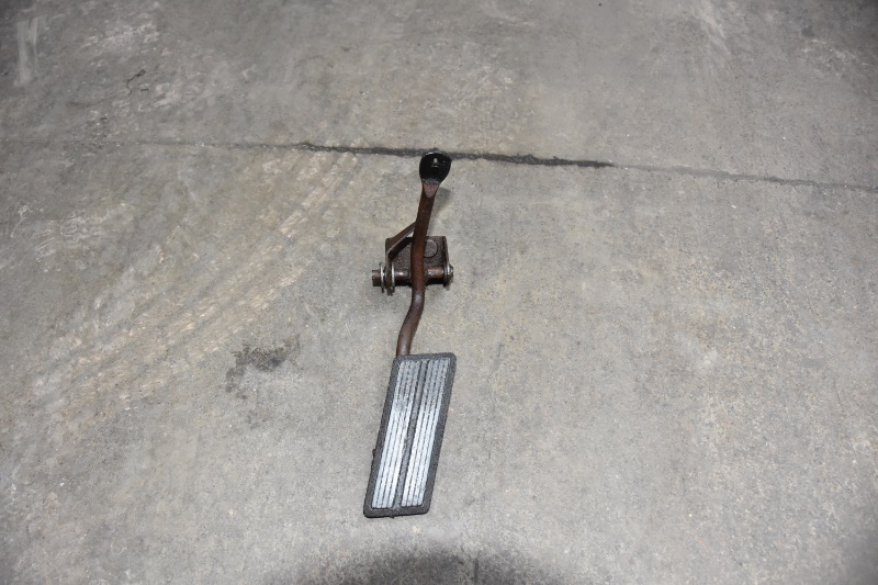

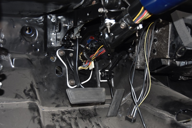

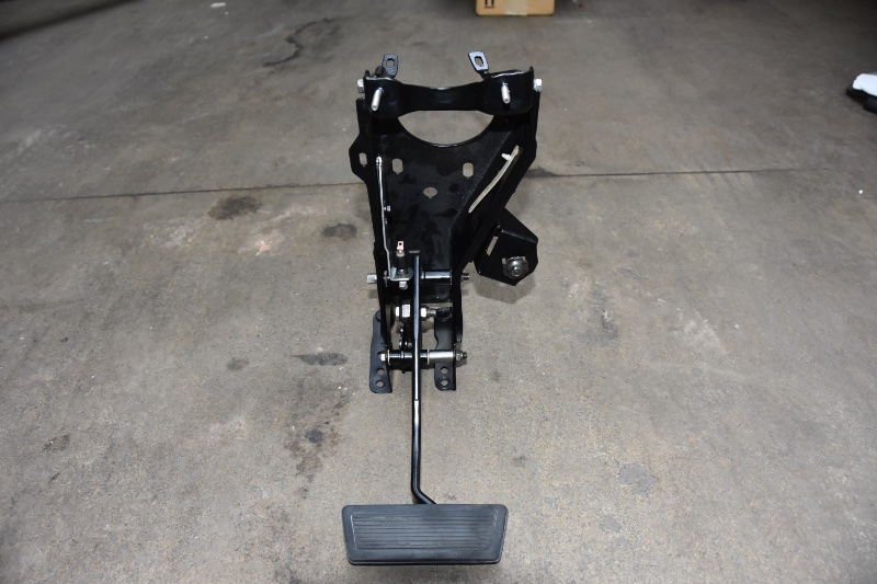

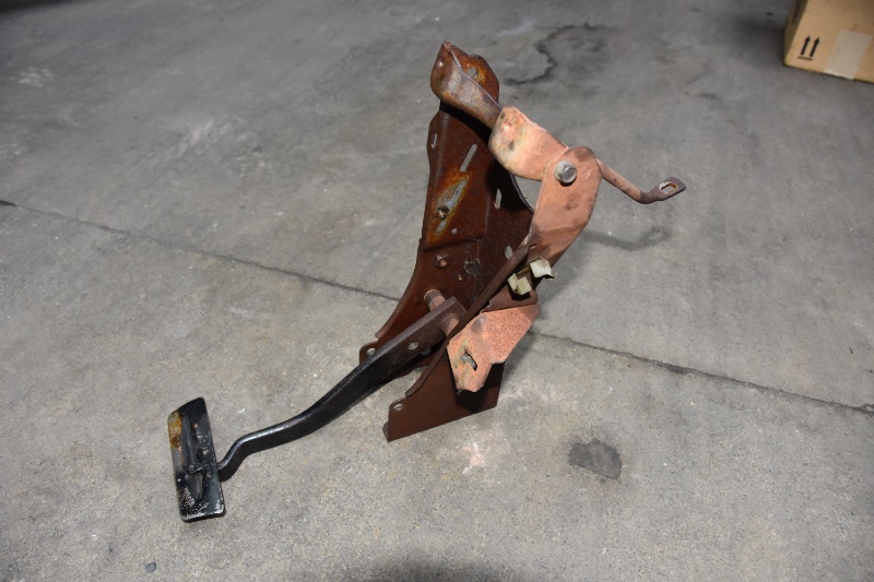

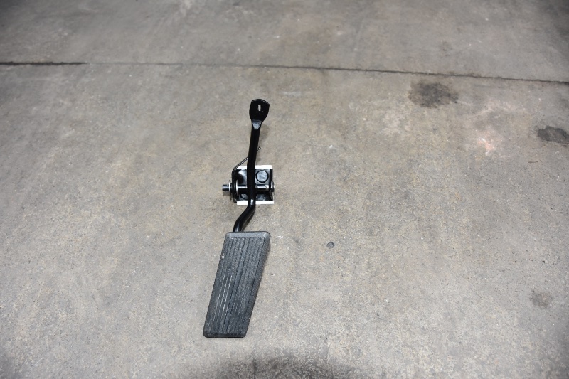

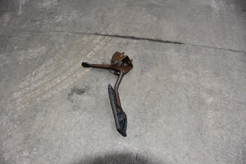

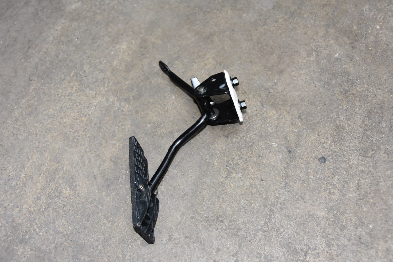

Brake and throttle pedal assy's

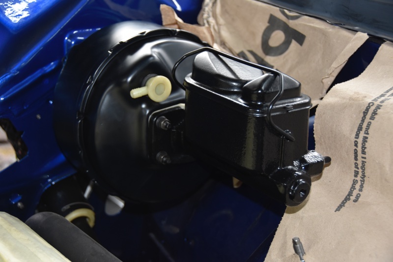

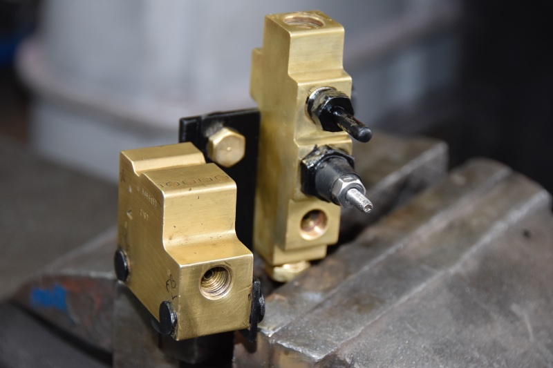

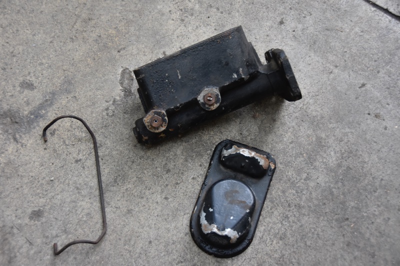

Honed out the bore of the master cylinder - Just some very slight pitting all looks OK
Powder coated, new seals & springs .
I'm going to use silicone fluid in case I spill some or get leaks !!! :? :?
